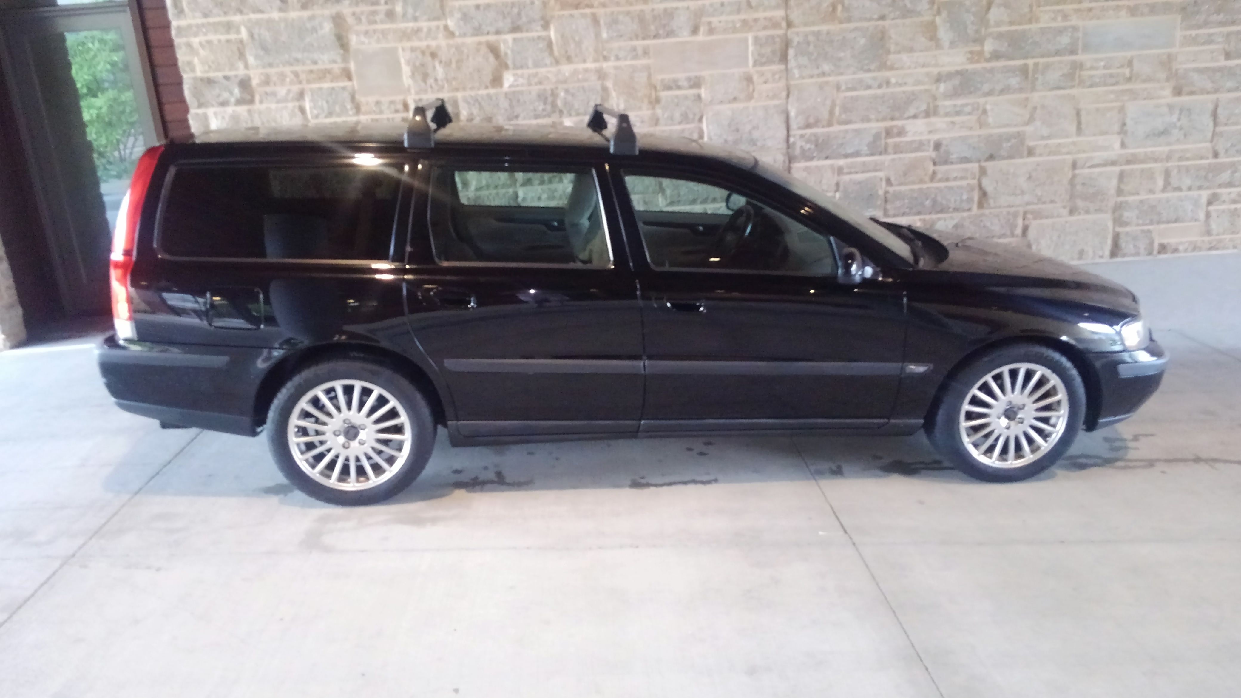

hey there cmax.. 'ppreciate all the pertinent data. I went down and pulled rm120 and rm 121.. I could hear the relay clicking so yeah ..actuator. I was considering going to the junkyard and gets couple... ps.. I have both S60R and V70R.. the 2002 V70.. went bye bye.. that guys still driving that thing, I sold it a year ago.. The guys at Volvo and I'm serious.. " those wheels don't go on a wagon! those are for the sedan!!" .. I told em .. oh really ? 2bad..
so apparently, whoever had this wagon before.. when the fuel door actuator failed they unplugged it. I just got back from the junkyard and installed one I bought for 10$.. it's working now.. until that one fails .. I bought 2 for 20$.. MDK
