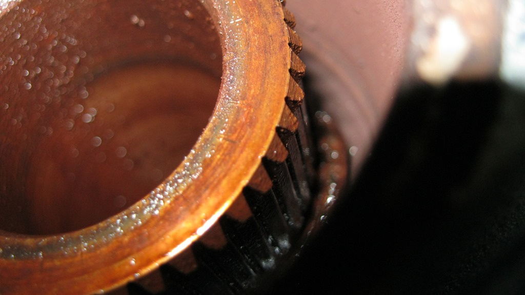

If you can turn the driveline by hand with all four wheels on the ground, you have a stripped angle gear input shaft or a stripped sleeve or both.
If the sleeve was welded to the input shaft and is still whole, then transmission output splines "could" be stripped (might not be, this is an AW5 transmission so softer sleeve). I had to go back into some of your earlier posts to see that this is a 2005 2.5T which means that you may be able to get the angle gear off with the sub-frame left in place (someone please correct if this is wrong).
I replaced the angle gear on my '08 Sport (stripped out in 2015 after 6 months of ownership) and have an OE "exchange" angle gear sitting on a shelf for what I assume to be an eventual replacement in the '06 Ocean Race.
Only way to really find out is to pull the angle gear and see the mechanical connection path, then you can decide on the approach. Volvo exchange angle gears run around $1500 plus $100 core, you could try and find a used gear from another '05 (there are a few PNs for this item) but it needs to have really good input splines of you'll be back where you started sooner than later.
Couple photos, this is what a stripped angle gear looks like (TF-80SC transmission with hardened sleeve):
Gear (splines are stripped out, upper part where you see the untouched spline is the space at the very back end of the sleeve):
Sleeve (see open space at back where gear input splines do not contact as noted in the first photo)
