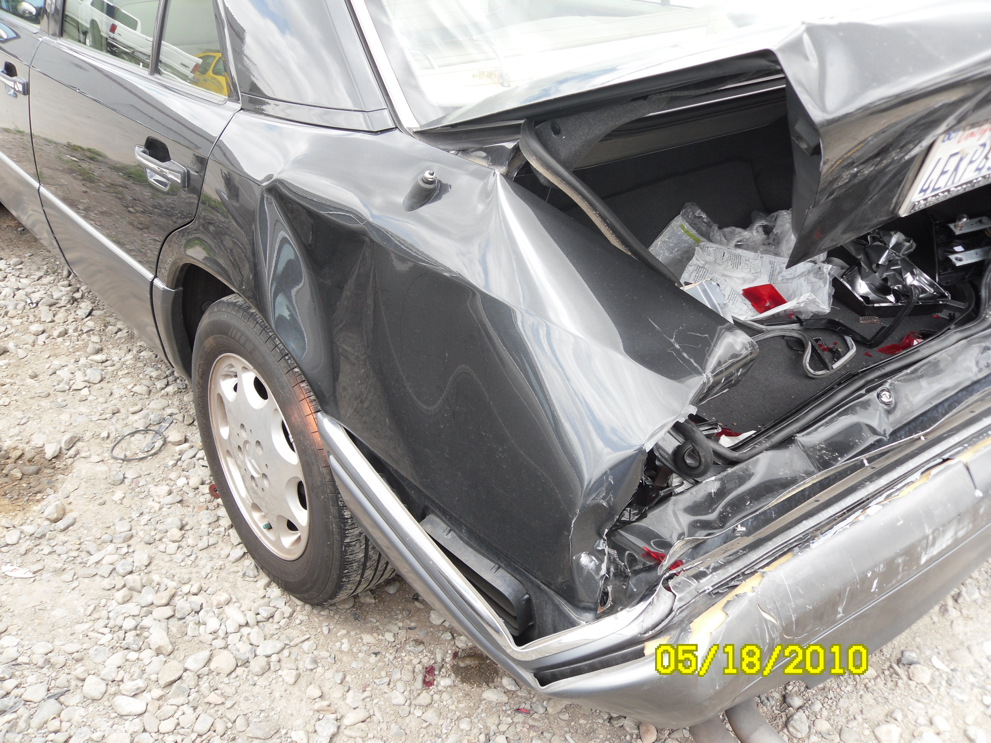

I am completely heart broken seeing that magnificent E420 with a boo-boo. I have let 2, yes 2! of these tanks slip through my fingers in the last year or so. Never again, they were both early '90s 400Es and I WILL snap up the next one I see. I currently have an 87 560 SEC but there is something even more special to me about the W124.
- MoVolvos
- Posts: 5279
- Joined: 15 Jan 2012, 18:47
- Location: NC
- Has thanked: 312 times
- Been thanked: 525 times
Brother gave my parents his 93 E320. A white beauty with beige interior and the E420 rims. That one got rearended and was totaled. Parents drove at the time. Brothers purchased that E420 used and again gave it to my parents. I was driving my parents and Son when a lady with 5 DUI's hit us and fled. Due to injuries the DA had no choice but to give her jail time despite her connections.redc70 wrote: 18 Aug 2021, 22:08 I am completely heart broken seeing that magnificent E420 with a boo-boo. I have let 2, yes 2! of these tanks slip through my fingers in the last year or so. Never again, they were both early '90s 400Es and I WILL snap up the next one I see. I currently have an 87 560 SEC but there is something even more special to me about the W124.
Had aftermarket Bilsteins, Brembo Brakes and Michelins. Such a refined and well rounded nice driving vehicle besides being a tank!
