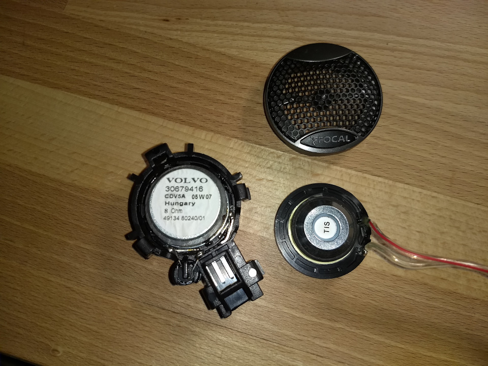

3. ISS165 comes with a tweeter.
4. They are tweeters. Still stock.

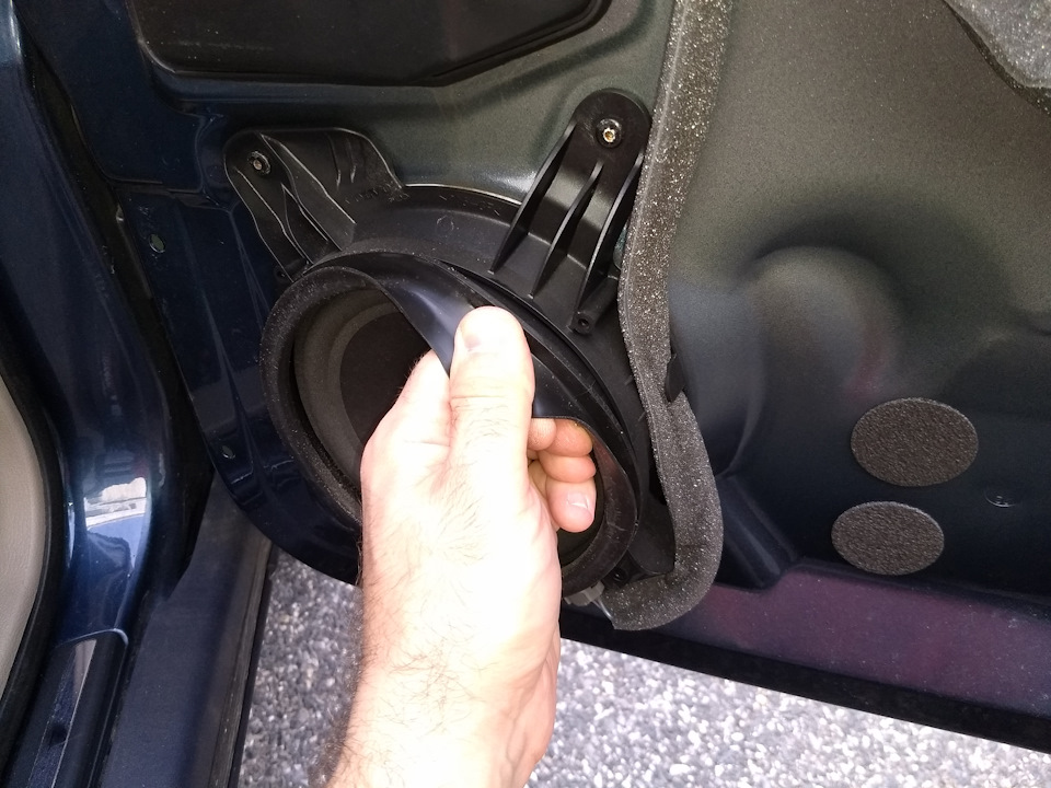

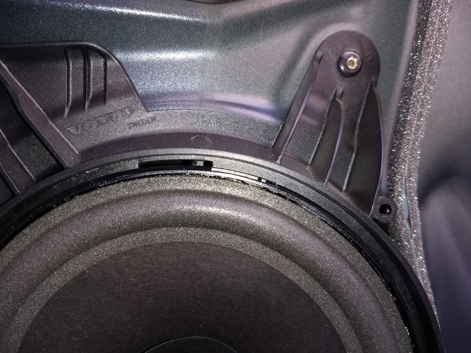

Cut the plastic in slots:
Then lift the speaker a bit and rotate CCW:
Overall 3 (I think 3) notches like that one have to be cut:

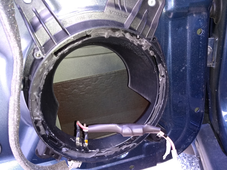

Pay attention to polarity:
Tweeter:

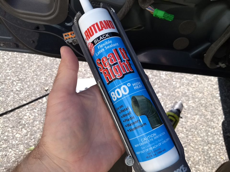

JB Weld it
Fireplace sealant (whatever sealant was opened):

I don't know tweeter wattage, but they are impedance matched to the main speaker, which is very important. Focal's sensitivity is much better than the stock white label speaker has, it is important to get rid of stock tweeters, or you'll never get a complete audio stage.
Rears are also impedance matched to fronts (sort of, but very close).
