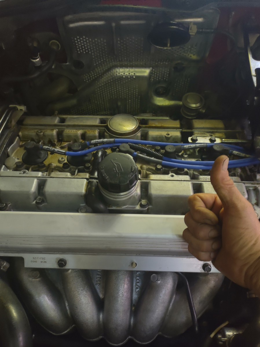

So I'm tuning up my recently acquired 97 850. All of the research I've done indicates that the number five cylinder (nearest to the distributor) seems to be the one with the plug always sticking so I approached it with caution. I think the previous owner ran into the same problem and went with a tune-up with just the first four and left the old one in there.
It feels as if the plug itself is rounded off to where I can't get the socket to even grab it. I have no way of knowing if it's the threads or if the plug is just so worn down from him cranking on it and wearing it down.
I didn't even know how to phrase a search term for that.
So my question is: has anyone ever ran into this problem? If this plug is rounded off enough that I can't get my socket to turn it...now what?
I've been racking my brain...perhaps modifying a smaller size socket? My magic wand is in the shop or else I would use that...
What if any harm can be done by running four new plugs and one old one? am I better off leaving the five old ones together?

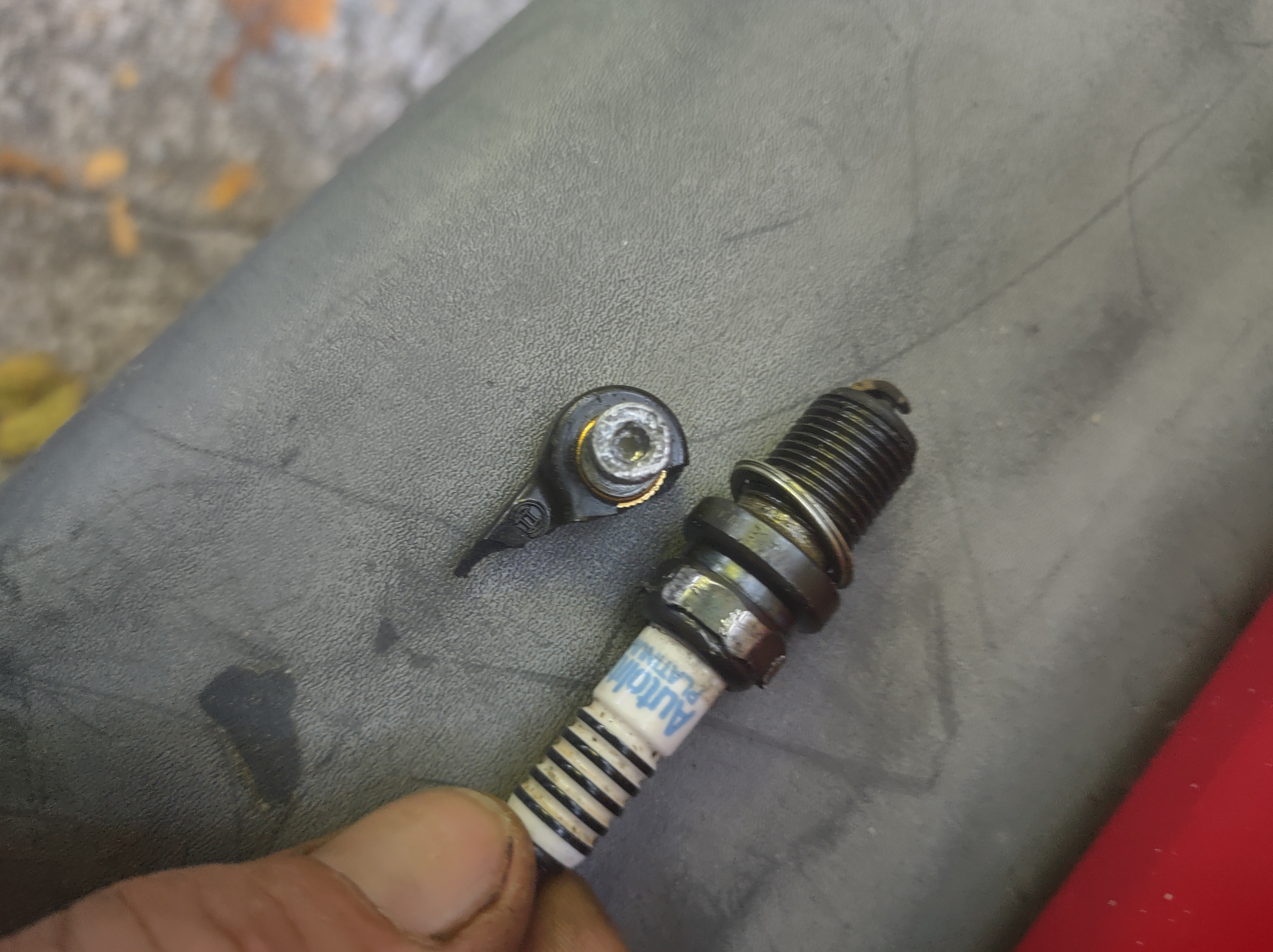

OH YEAH!!! the previous owner also stripped out the top of the bottom bolt that holds the rotor on and I can't get that off either, I pulled some shenanigans with my old Chevy back in the day with a Dremel cutting a groove in the top to fit a screwdriver but this isn't an old Chevy... and we're not back in the day..

That's a interesting conundrum. My first thought is to glue/bond a cheap sacrificial spark plug socket to that plug and let it dry overnight. Just would want to make sure none of the glue squeeze out sticks to the head. Maybe masking tape everything off really really well first.

We are of like mind my friend! I put some epoxy in a slightly honed out smaller socket until I could just hammer it on there and now we wait....unique indeed... +10 for the use of the word conundrum btw
I did a little research in here and discovered I can just gently break / cut the rotor so I can get some vice grips on the little bugger that was deviling me... that's done...
... I waited to post this reply until I had my answer... problem solved!!! it worked... it was risky though...I was hella nervous I won't lie...
***this repair was performed a trained semi-professional, don't try this at home***

Far out ! Glad it all worked out. I can see that being a bit unsettling.
Might want to put a dab of anti-seize on those plugs ( Volvo or Bosch) for ease of mind.
