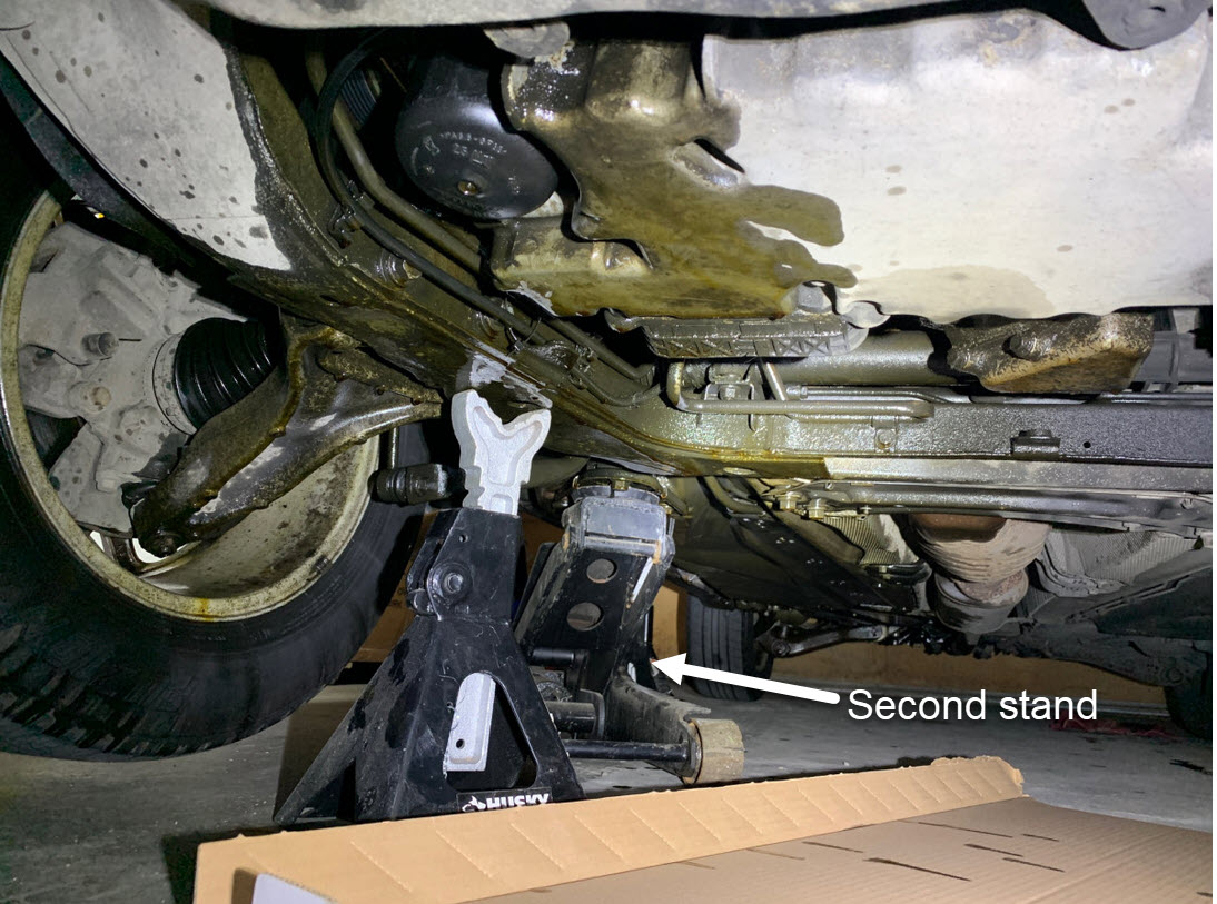

Be careful with that jacking protocol please, especially when it’s oily

Thanks for your warning, well appreciated!abscate wrote: 20 Aug 2021, 05:46 Be careful with that jacking protocol please, especially when it’s oily
Jack stand, primary
Jack, backup
I have a second backup stand; always do no matter how small a job I am doing.
When jacking it up again, I will reposition away from the oily zone.
