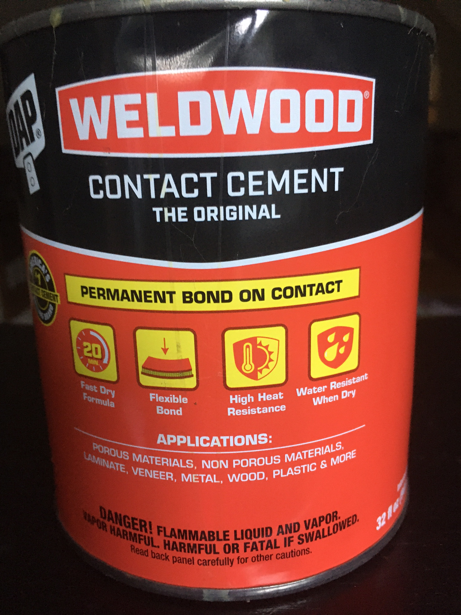

I've used this DAP contact cement with success. Use a small brush to cover both pieces, clamp well, wipe off excess with wet sponge. Let set for 24 hours. Before you start, make sure all old glue is removed from the panels.
I spent more $ on the right clamps then on the cement. Others have posted in these forums.
Good luck.

Contact cement will work well for this task. I tried several things, but contact cement works. It it not a fast job.
Clean the old surface of glue by scraping. Apply the contact cement to both surfaces where you can and let it harden. Plan to use small strips of boards to spread the clamping load on the exposed side of the panel. This will prevent marking the panel. When you have your clamping plan ready, use acetone to reactivate the contact cement and then assemble and clamp quickly. Work in a well ventilated area (outdoors). Both the acetone and contact cement are bad to inhale.
