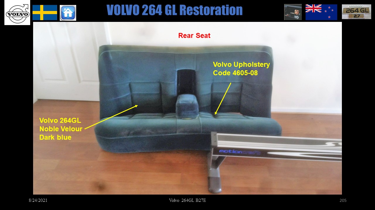

Thanks . i am trying to restore any parts that is salvageable and documenting as I go . So far panels are in good shape and engine is good pretty condition 234,000 km. These k-jet do not like sitting idle ... It was in a barn for 17 years . Some of the Upholstery faded but not too damaged. Definitely going to install new underlay and vibration/soundproofing layer. More pic below
