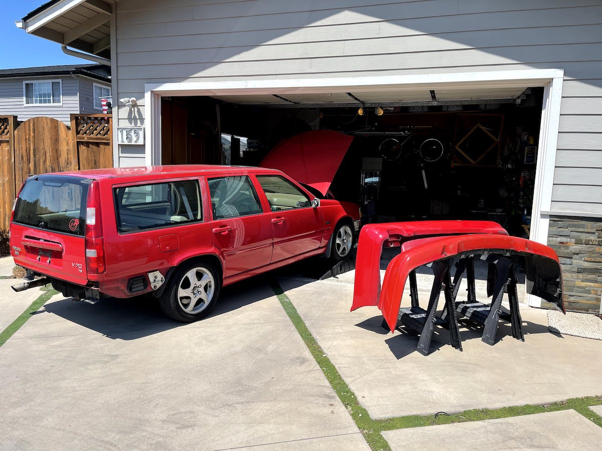

I purchased our family 1998 V70 new when my daughter was born. It is now her first car.
What does a 263,281 mile car look like? It's been to the moon (another thread for an earlier generation car exists on this site)! Well, I refreshed it last month. Repaired and refinished all the relevant parts in my garage.
Taking off the damaged parts.

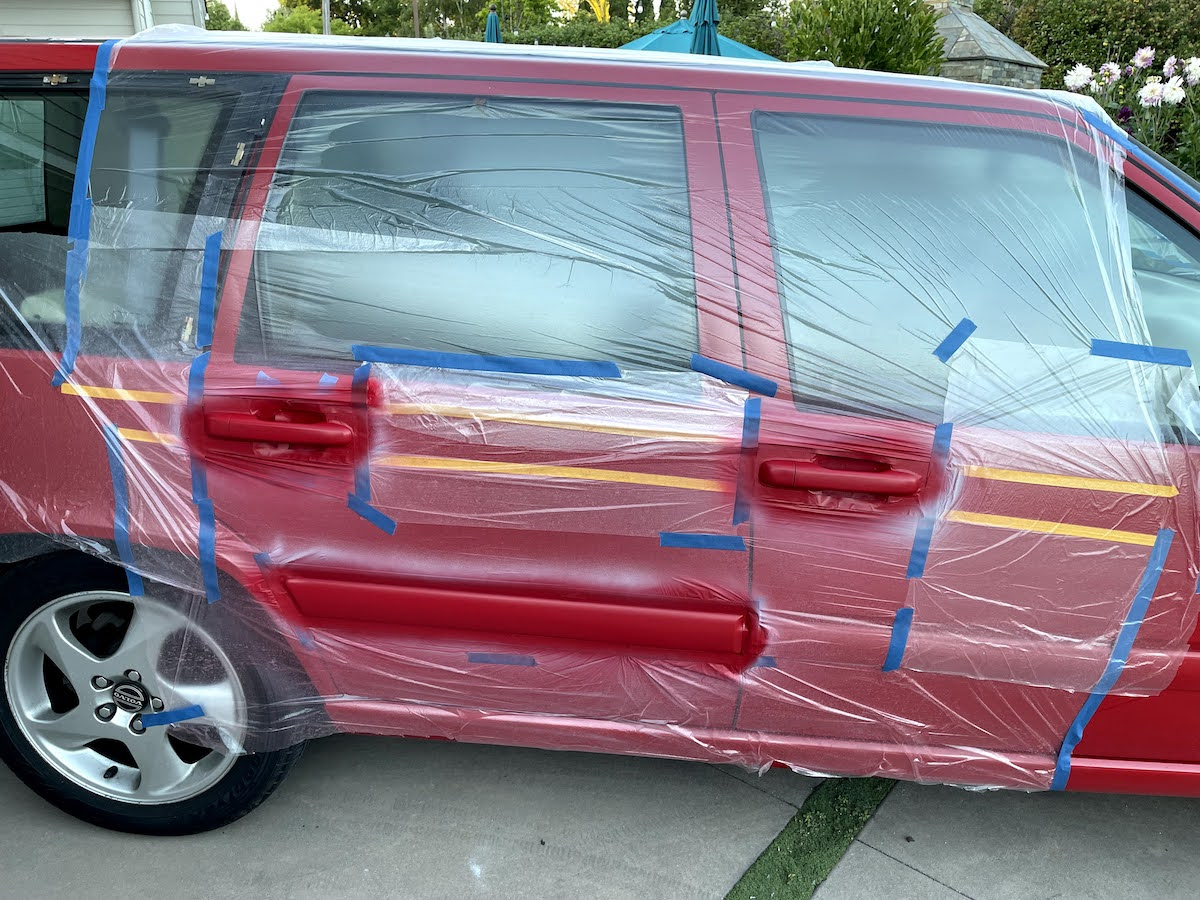

First color coat.
First color coat.
Some parts refinished on the car.

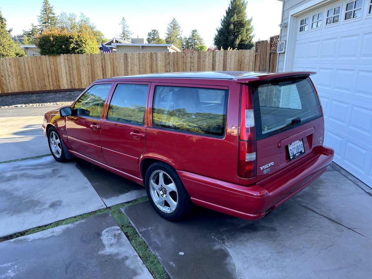

Front view
Front view

This car will exceed 300,000 miles and then some.

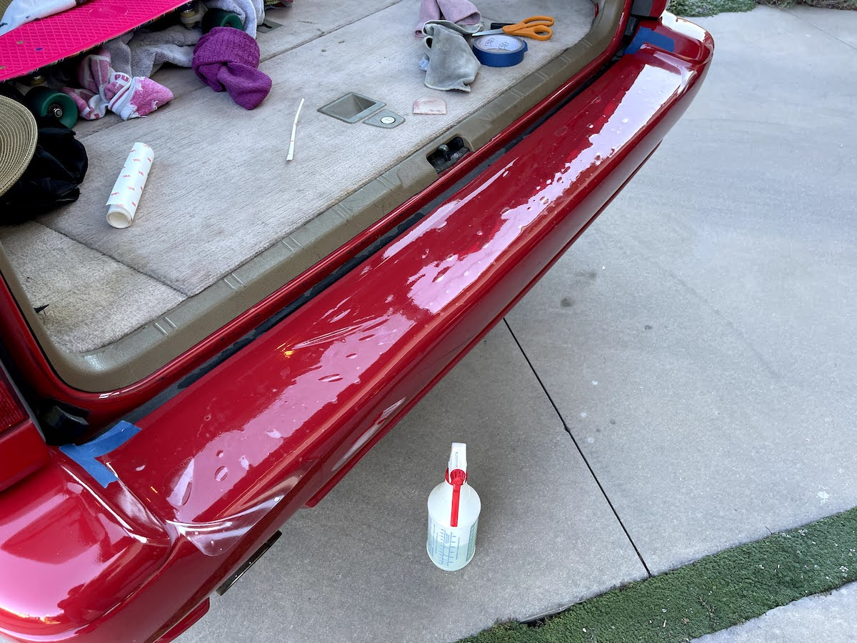

Oh, one more thing. I learned that the rear bumper's horizontal surface gets scuffed up fast. So this time, I applied a 3M clear plastic paint protector. The secret to putting this stuff on is soapy water.
3M Paint protector
3M Paint protector
This was only $20 on Amazon for a 6" x 60" roll. It was the perfect amount to apply over the bumper. When it's all done, you can hardly tell it there.
Paint protector after install.

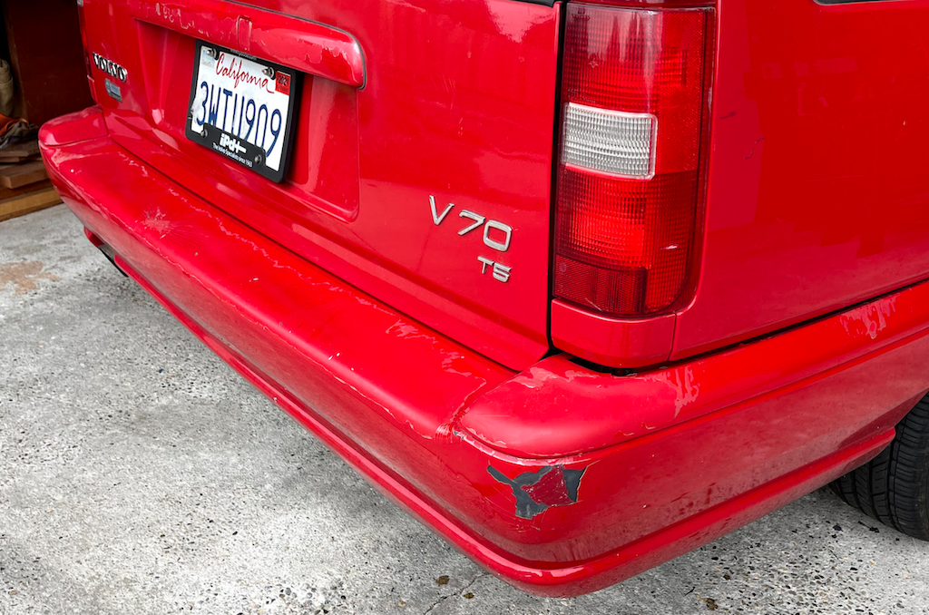

The rear bumper had bumped into several things. There were areas of paint flaking off, cracks on the top surface, clearcoat failing and numerous scratches. There's also failing clearcoat on the hatch lid handle. You'll have to zoom in to see all the damage.
Look close for all the damage.

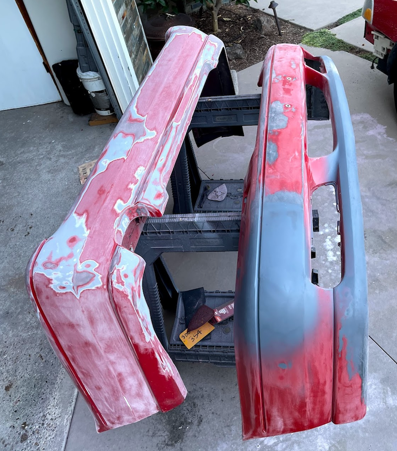

The front had a flap punched into it, failing clearcoat, and more scrapes on the bottom than you can count.
Here's a picture of it in progress. You can see I've used bumper epoxy to close the flap. There would be a little filler later to smooth it all out. The deep scrapes and gouges on the bottom lip is mostly sanded down. It'd get some filler and smoothed out before paint.
Lots of damage after 22 years.
Front Bumper Before.png (1.6 MiB) Viewed 3125 times
Here are both bumpers during the process of sanding the paint down to the plastic in lots of spots. Basically if there was a crack in the paint, you had to go down all the way. I used 80 grit, but in retrospect I caused a lot of extra work. It's hard to smooth a plastic surface after 80 grit.
