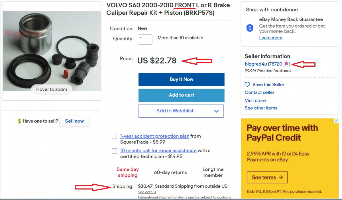

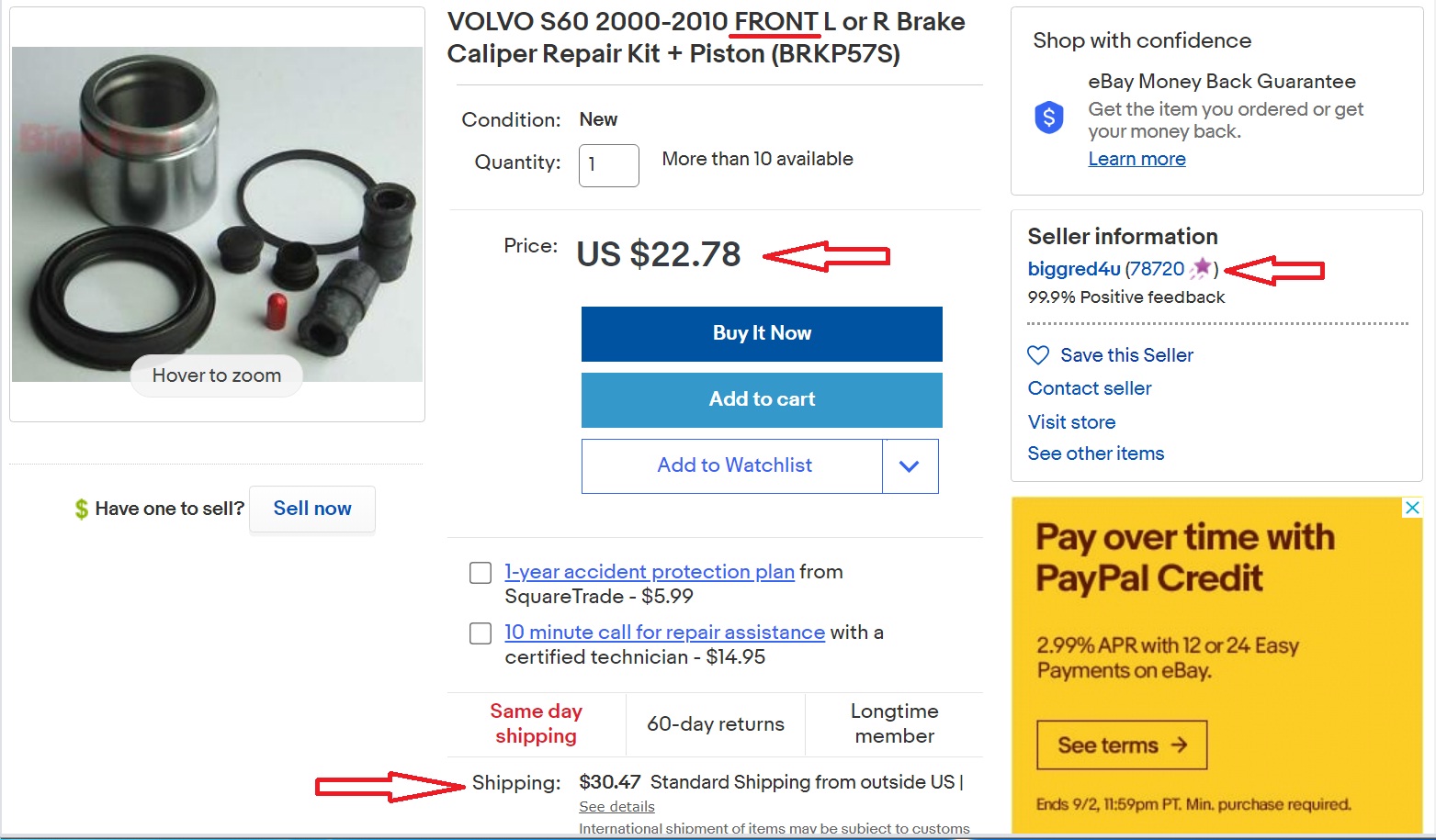

I rebuilt the calipers in my 1998 V70 (P80 car) some 10 yrs ago, info in forum on how to rebuild.
I used ATE seal and boot.
The problem is I can't find ATE rebuild kit for P2 cars (S60, V70 etc.).
However, if you search ebay UK website, you will see some rebuild kits by "BiggRed" brand...
If anyone uses this brand, please post experience.
If anyone finds ATE rebuild kit, please post.
Example of FRONT rebuild kit by BiggRed on ebay UK...
