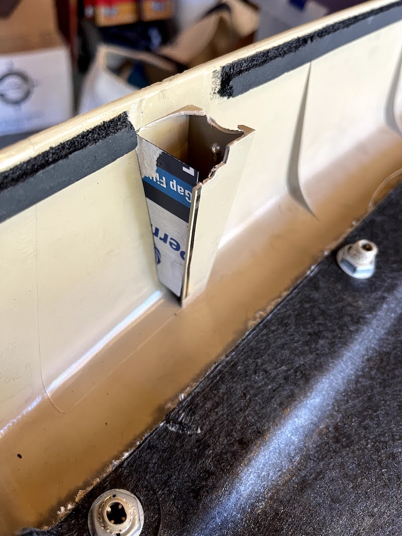

First we need to make a piece of wood that'll nestle nicely into the space. I used some cardboard to get the shape.
You can see her that the tan plastic on top is completely gone. There's nothing to attach the repair kit screws.

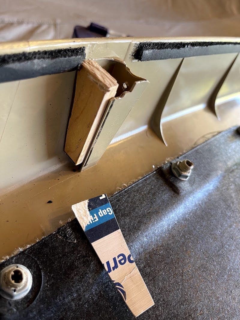

Next you cut the wood and test fit it.

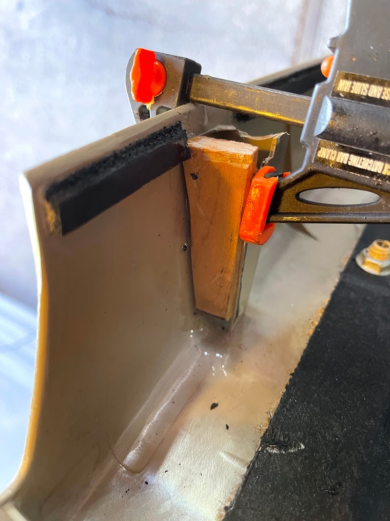

I used 5 minute epoxy and a clamp and allowed everything to set. You should pre-drill the holes for the screw so you won't crack the hardwood later when you fasten the steel bracket with the screws.

5 minute epoxy has never really held up very long for me, though I love the idea of five minute epoxy. I hope it works better for you!

You know, you may be right. We'll see how it does and I'll report back if it fails.850oldschool wrote: 25 Aug 2021, 17:03 5 minute epoxy has never really held up very long for me, though I love the idea of five minute epoxy. I hope it works better for you!

What are you doing to prep the bonding surfaces?850oldschool wrote: 25 Aug 2021, 17:03 5 minute epoxy has never really held up very long for me, though I love the idea of five minute epoxy. I hope it works better for you!

Nothing special, but they were freshly cut wood and plastics that I was using to make jigs and fixtures. I came to the conclusion that the long curing time of regular JB weld was worth waiting for. Heat really speeds it up, though. Probably two hours in a closed car in full sun.RickHaleParker wrote: 25 Aug 2021, 20:05What are you doing to prep the bonding surfaces?850oldschool wrote: 25 Aug 2021, 17:03 5 minute epoxy has never really held up very long for me, though I love the idea of five minute epoxy. I hope it works better for you!

It might be oil film on the plastic. Light sand then wipe with a cloth damp, not wet, with Acetone. The light sand will produce a surface the epoxy can grab a hold of. The Acetone will remove any oils or microscopic particles.850oldschool wrote: 26 Aug 2021, 10:45 Nothing special, but they were freshly cut wood and plastics that I was using to make jigs and fixtures.

There is a world of difference in work ability and strength of “ regular epoxy “ and five minute epoxy. You get a better pot and holding strength with regular. A repair like this can easily sit overnight without loss of use of the car
