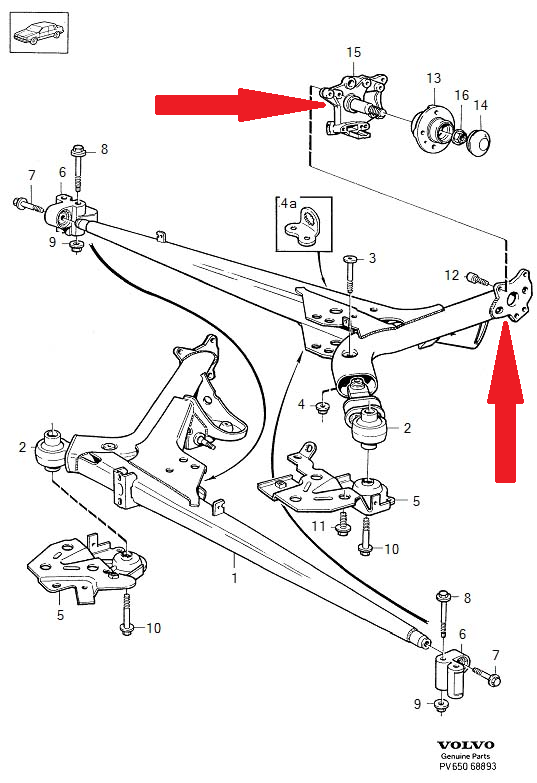

You need to have all suspension parts checked to make sure they are at Stage 0. Assuming it's a 95 850 (others should be about the same) and everything is okay the only thing that can be done is to get a shim for the stub axle (red arrow). In the old days and maybe even now wedged shims were available to fit behind the stub axle where it meets the trailing arm surface where it attaches. Not for the amateur alignment guy. I've seen the shim for some cars kit but never done one.
The other possibility is a bent stub axle. Not sure you want to spend the time and money for a new one. If you are eating tires that might be the first thing to try assuming the suspension is good and camber spec from a machine tells you it's out. Toe'd out can do that also (require shim or have bent axle) but most of the time it's camber since you already measured it, correctly.

Agreed. If it was that bad you would have thought you would have heard it. I think Rick's suggestion is a better one, that either the stub axle is bent or it's mounts have been damaged. Would have thought someone would have known they had caused that damage. Only other suggestion is it has been jacked up in the wrong place bending the rear suspension.
