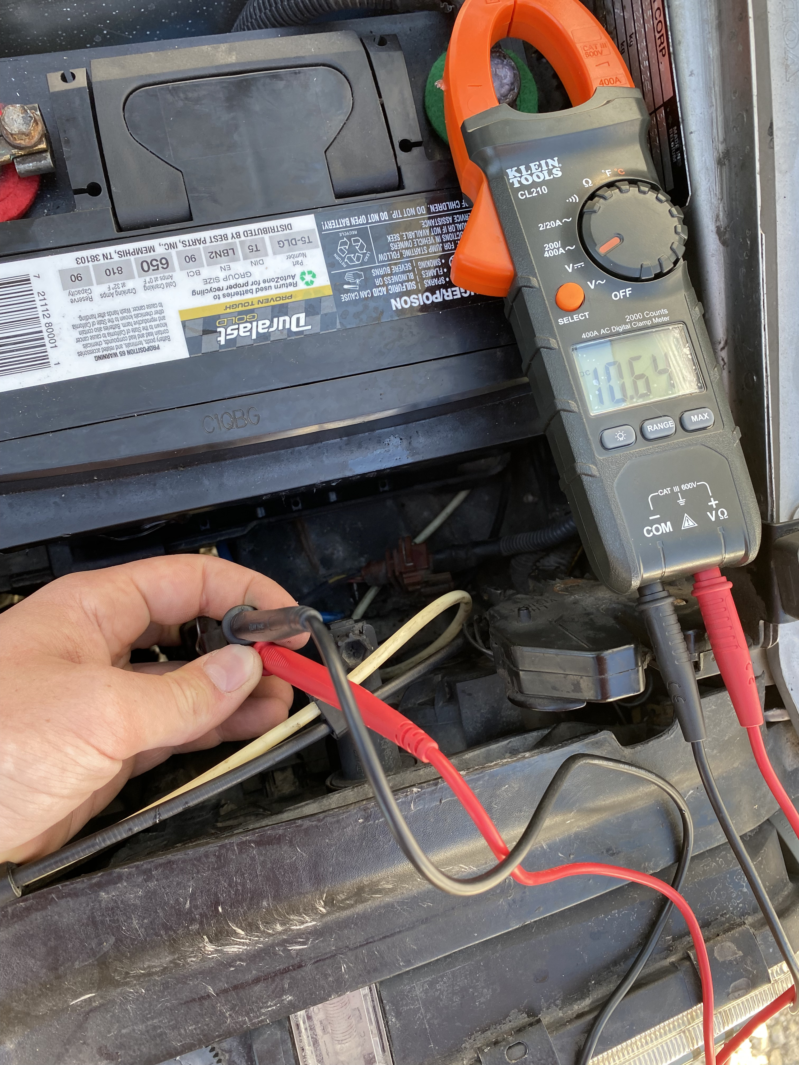

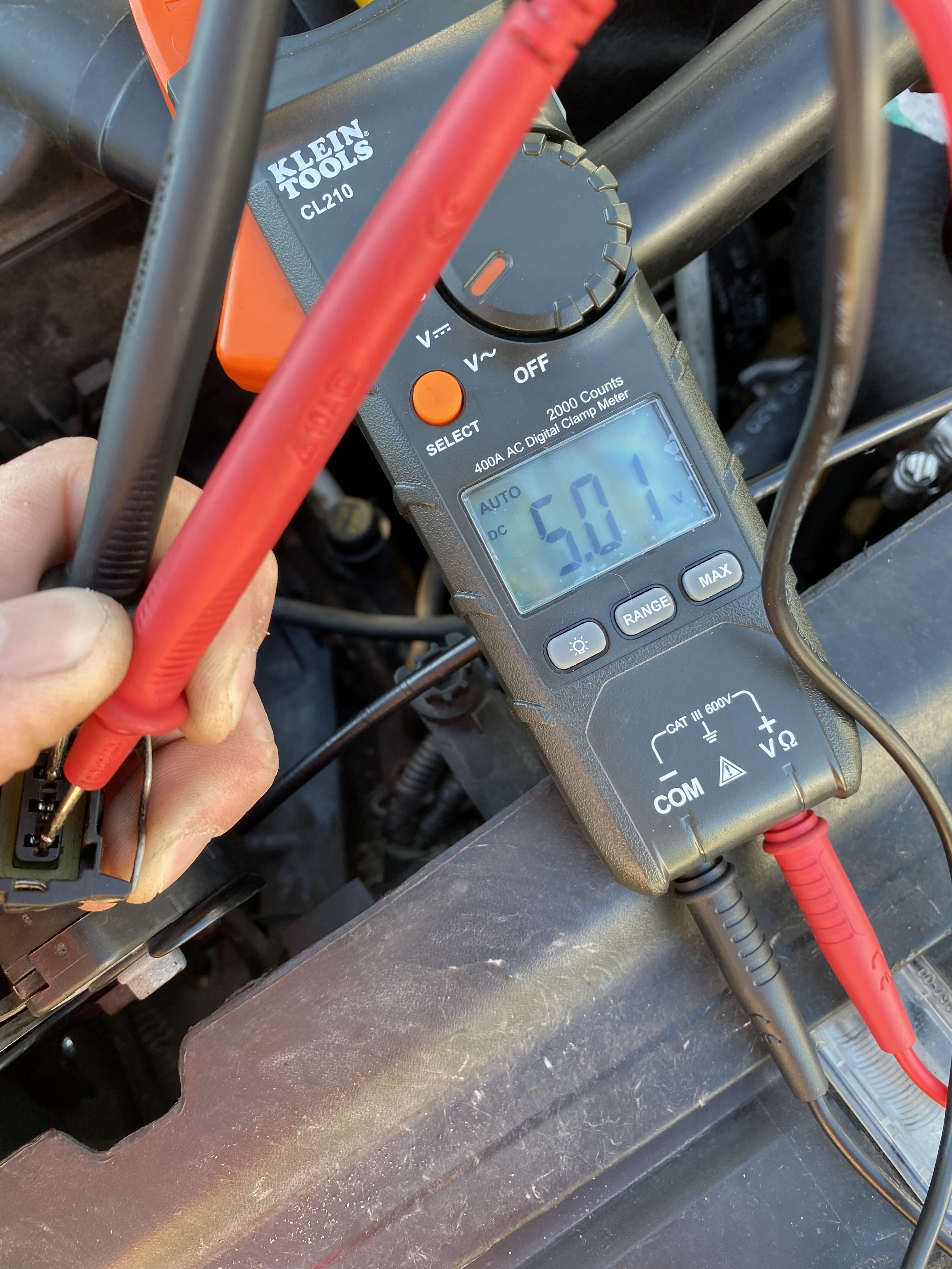

I am not an electrician so pictures might do better to illustrate what im seeing. This is what I get on the passenger side plug coming from the body of the carRickHaleParker wrote: 02 Sep 2021, 07:03 5V drop to chassis ground or some other reference?
What is the voltage drop across the bulb?
This is what I see on the drivers side plug coming from the body.
Both have the same readings to the actual plugs within the headlight housing. I have replaced the headlight switch and the relay, both creating the same issue. Only thing I haven't plugged in just to try is the stalk, but i do have one on my parts car so I could give that a shot as well.
Like i said im not an electrician so if there are different tests I can try or maybe something obvious I'm missing.

Put the black (-) lead on the battery post (-) and leave it there as you take three measurements with the read lead ( + ) by moving the red lead only.
Post the four readings.
From that we should be able to tell which side the voltage drop is on and how much.
- 1. Across battery.
2. ( + ) On the passenger side connector.
3. ( - ) On the passenger side connector.

Okay, so I did what was suggested and came up with essentially the same results. on the 2 of the pins read 5 volts with the negative lead on the negative battery post. On the functioning side I got almost full battery voltage, about 11.5vs testing the same way. I don't know if this is relevant but I measured resistance between the ground plug and the battery post and couldn't get my meter to read any resistance no matter what range i put it in. This was the same on both sides.
EDIT: Sorry today at work was a lot and i re read the post and here are the measurements you guys requested
1. 12.49V
2. 5.06V
3. 37mV
4. 5V
1. 12.49V
2. 5.06V
3. 37mV
4. 5V

Put it back together. Turn on the headlights.Luke.T5R wrote: 03 Sep 2021, 15:07 EDIT: Sorry today at work was a lot and i re read the post and here are the measurements you guys requested
1. 12.49V
2. 5.06V
3. 37mV
4. 5V
Black lead back on battery. Measure voltage each side of Fuses F21 & F22 under the hood. Four measurements in total.
Swap fuses F21 & F22 see if the problem moves to the other side.
Possible sources:
1. Bad connection, Current limiting resistors or Relay contacts in the Central Electrical Unit.
2. The common ground at the headlight connector has a high resistance to ground.
