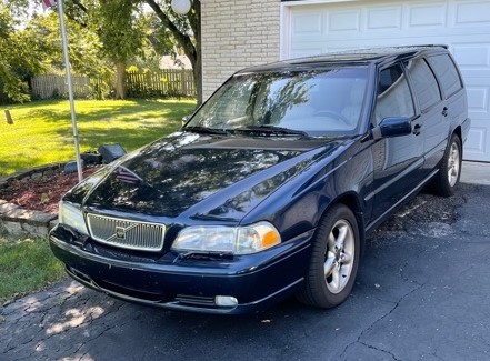

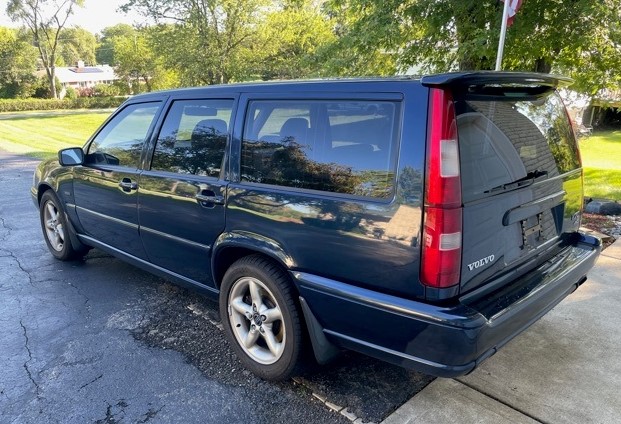

Hello Forum!
Wanted to say "HI" to the group...just drove a 98 V70 AWD up from Marco IL FL to Chicago IL over the weekend and am getting to know the car.
The Skinny:
71K Miles (not a typo)
Nautic Blue/Tan
1 Owner, all service records (And the Monroney Sticker!) - Tons of work done exactly when it was needed...probably could use a torque tube bushing...
Lived in FL all it's life, garaged in A/C (paint, seals and interior are incredible)
Will be the "other car" for winter/errands/etc.
Looking to add rails/rack, wood wheel (XC SE), GROM BT...just slight upgrades and tighten it up a little. Have some 1998 V70R wheels I will probably refurbish and slap on there...some jewel headlights... Looking forward to learning more about these great cars. We had a 2000 V70 SE years ago and really liked it, so back into the fray...

Welcome and thanks for joining. Wonderful V70 you have there. So pretty.

Very nice! Rare to find gems like this at the low miles.
Double check all the rubber hoses and related things, because sometimes age will do damage, even with the low miles. I'd do a couple transmission fluid drain/fills, and if your AWD system is still functional (should be at that mileage), have the bevel (angle) gear fluid changed.
Hope you get many years and miles out of it!
