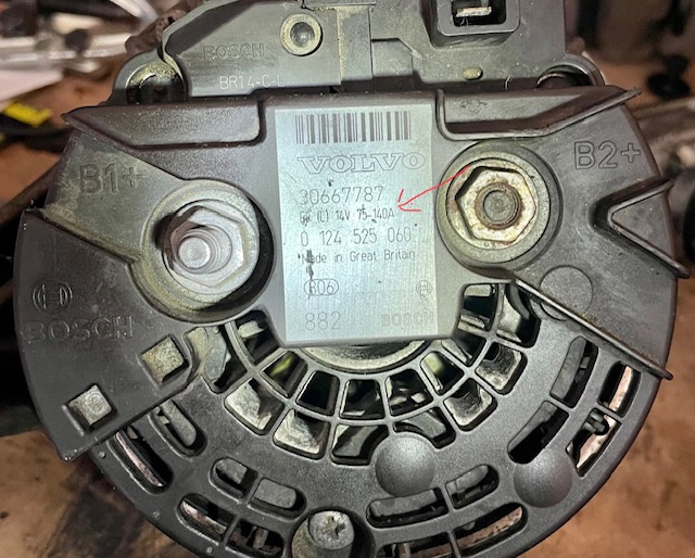

Here is a picture of the label on the voltage regulator.

5rivers
- Posts: 557
- Joined: 27 Feb 2009, 06:18
- Year and Model: V70 1998 T5
- Location: The North Country, NYS
- Been thanked: 15 times
Thanks DonnVa for the above pic...no such label on alternator in my car...leads me to believe its a non-Volvo, non-Bosch brand
