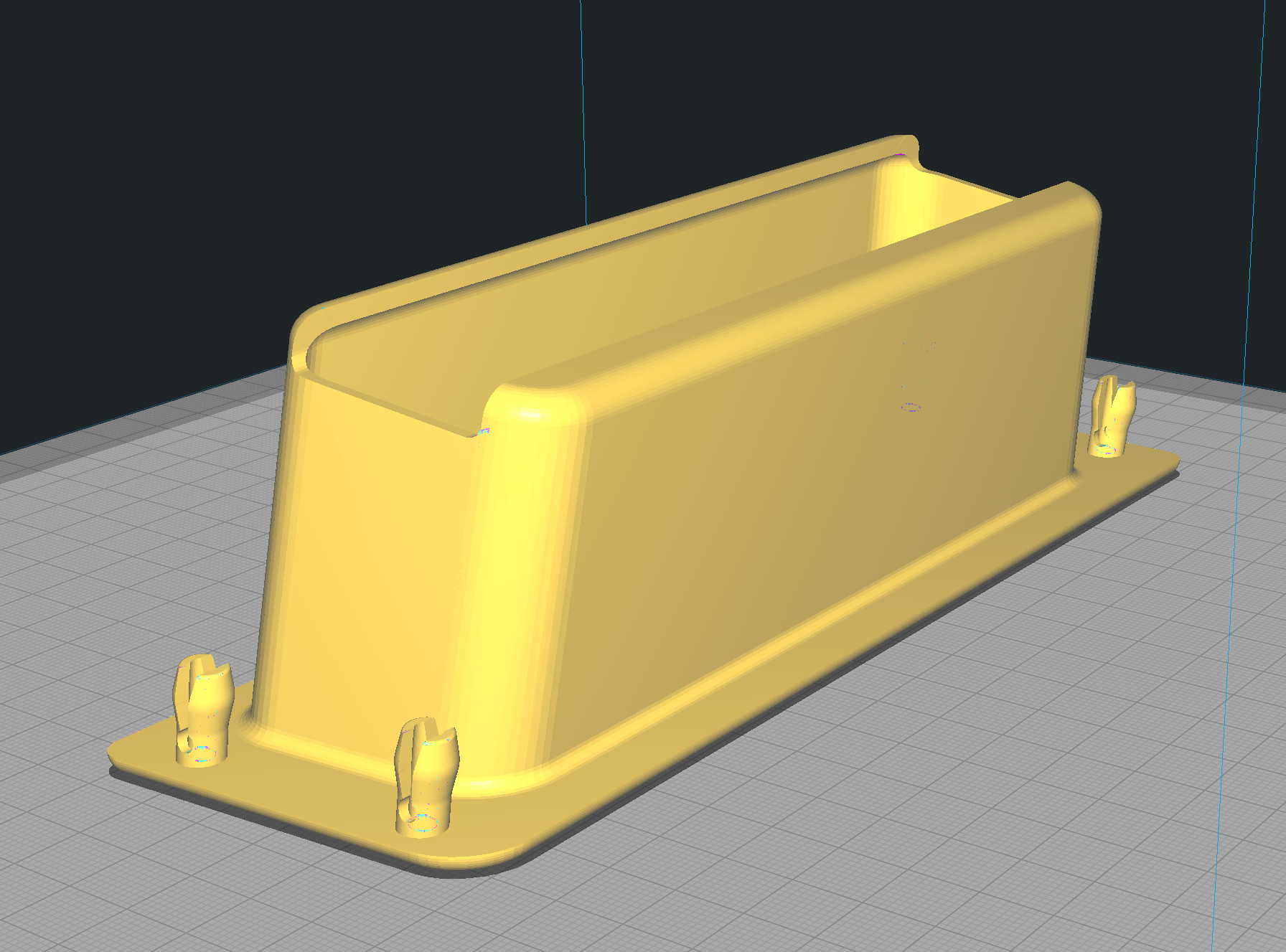

Interior Door Handle Inserts
My door handle insert are badly damaged from years of abuse. This is the first volvo part I ever designed and printed. It needs a little fine tuning but it fit my vehicle just fine. Some design changes I made was to do away with the odd metal clips that attach to the underside and usually break. Instead I opted for body style clip for a snap fit with no additional hardware required. The clips made a snug feel and may damaged the fiber board holes a bit. If this is the case I can make them a bit slimmer or you can file the overall size down a bit with some sandpaper or a metal file.

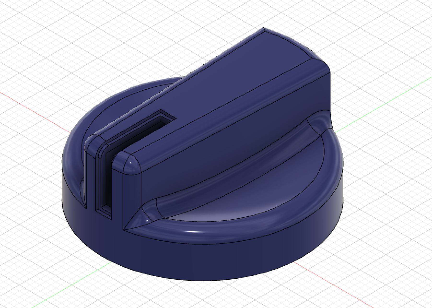

Control knobs for Electronic Climate Control (ECC).
I seem to be the only one who needs this but my knobs broke at the center and the metal clips popped out. I blame decades of Texas summers. Anyway I designed 2 versions. One that requires the metal clip and one that does not. I tried to mimic the translucent material that lets light through at night. There is a slot with a small recess just for this purpose. At the time of this post I have not found a material I'm happy gluing there yet. I'm looking for an opaque translucent flexible plastic material that can be easily cut and glow with background light behind it.

ZionXIX wrote: 19 Sep 2021, 20:36 Interior Door Handle Inserts
Volvo 850 Door Latch trim.stl
Volvo 850 Door Latch trim Rotated.stl
Volvo 850 Door Latch trim rotated with clips.stl
Volvo 850 Door Latch trim.skp
The ones in my car haven't had the locking tabs since I bought it. Friction and gravity's all that're holding them in.
What plastic would you recommend printing these in?
Are they FDM or Resin? Or either?

For this I would recommend PETG. I printed the first ones in PLA and unsurprisingly they gave off an awful odor then warped and twisted in the Texas sun. Ive had one of the ECC knobs printed in PETG sitting on a black dashboard for the past week and it shows no sign of heat damage. Another option may be ASA filament for its UV resistance but Ive never used it. I only work with FDM printer. Would love to try Resin but its messy and I dont really have the space for it at the moment. With that being said I have never seen better looking prints than was Resin can achieve.Nevada1906 wrote: 22 Sep 2021, 19:44
