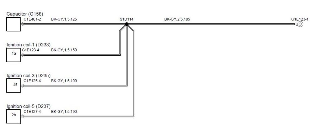

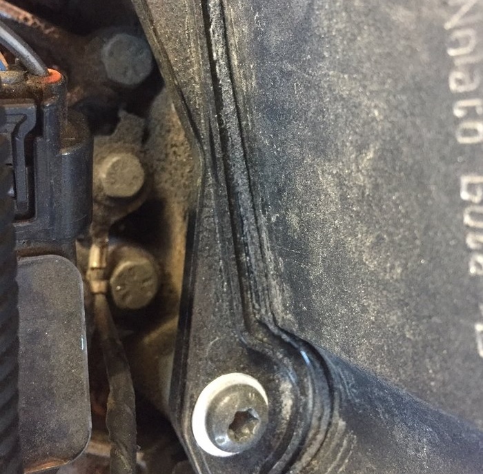

Did you measure the Voltage Drop at those connections with the Engine running? (Exposed metal on the crimp shown in the picture below to the Battery (-) post)?
Some pictures that may help
Note: the wiring diagram is for a LR2 that uses the same engine as your V70
Did you find this connection for the ground? Note: yours won't say Land Rover but it will be connected in the same location.
