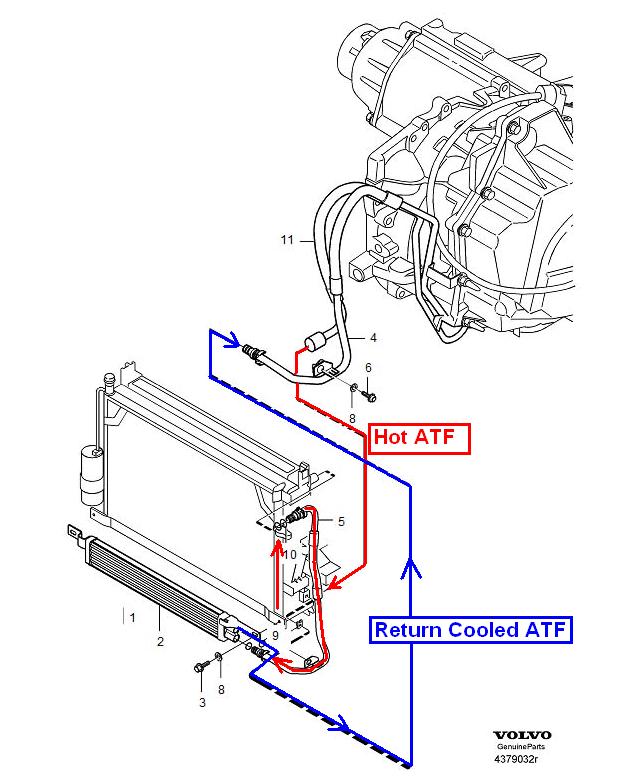

Can anyone give me a definitive answer (pictures help a lot) on which line is the OUTPUT from the trans in order to get the filter direction correct? I want to make sure it's proper for after the valve body rebuild.

Bottom hose is the output from transmission, upper hose (attached to the valve body cover) is the input. The filter placement is in upper cooler line, direction from cooler to transmission.

I put mine in the line marked "return cooled ATF."
If you don't have an aux cooler, this diagram still works, just imagine the aux cooler isn't there, or that the aux cooler in the diagram is your in-line filter.
