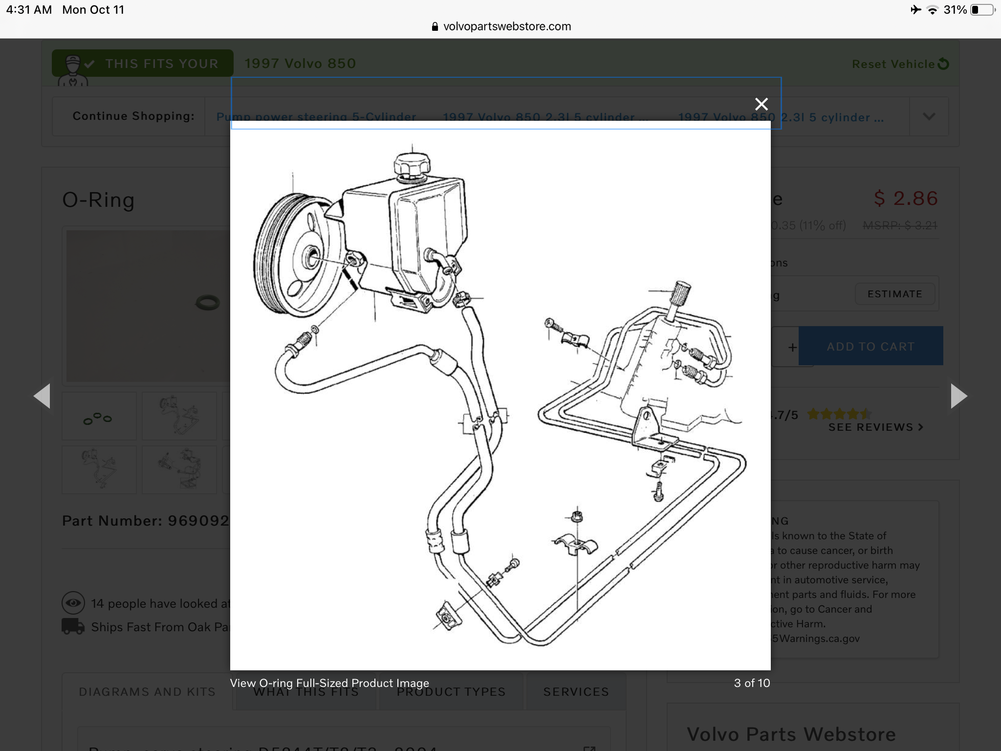

Okay so I replaced my power steering pump today since the previous owner messed up the tank on the other one. All is good except I have power steering fluid pissing out of the fitting and am wondering if and how many o rings are supposed to go on the pressure line and where they should go since it had two on in but they are really chewed up.

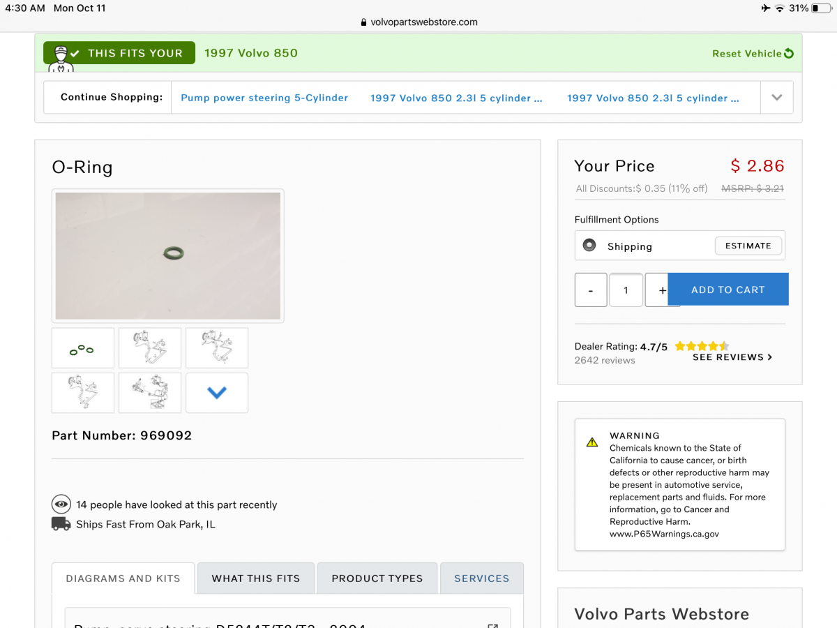

This brings back memories. What happened here was the OP serviced this thing, the o-ring hung up I the ps pump, s/he put another one in to replace the “ missing” one and the two o-rings got mangled on the reinstall.jboncher01 wrote: ↑10 Oct 2021, 18:02 Okay so I replaced my power steering pump today since the previous owner messed up the tank on the other one. All is good except I have power steering fluid pissing out of the fitting and am wondering if and how many o rings are supposed to go on the pressure line and where they should go since it had two on in but they are really chewed up.
Just get a new one and replace.
We might have the size documented in the master thread.
Well, crap. This thread says there should be 2. Size is in there.
viewtopic.php?f=1&t=88572&p=498100&hilit=969092#p498100
