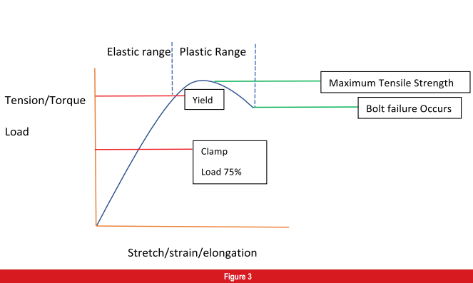

It is done this way because the point of Maximum Tensile strength is in the Plastic range.Oka wrote: 16 Oct 2021, 00:31
C. 2001 Volvo XC70 Vibration Damper (4 screws)
Stage 1 = 18.5 ft.lbs
Stage 2 = 30 Degrees
3. First stage means to torque to that set amount, then turn 30 Degrees.
4. If so in (#2), why isn't the "30 Degrees" calculated and included to the Stage 1 torque. In such case, there would be only one torque to say, example, instead of the specified "Stage 1 18.5 ft.lbs" it would be just one 20 ft.lbs torque?
Thanks, for I am still work in progress!
The 18.5 ft.lbs is the end of the elastic range ... The Yeild point.
30° stretches the bolt a specific length in to the plastic range to get Maximum Tensile strength.
Elastic Phase: The bolt will stretch while under torque, but returns to its original condition.
Yield Point: The point that separates the elastic phase from the plastic phase is known as the yield point.
Plastic Phase: Once a typical bolt reaches the yield point and you continue to apply torque, it enters the plastic phase. Bolt will not won’t return to its original length and condition when torque is removed.
Don't over stretch the bolt. If you do you will over shoot the Maximum Tensile strength and can stretch it to the point of failure. This is why one does not reuse the bolts. Go slow on the stretch.
You know when you entered the plastic range. The bolt will suddenly start turning easier as if the bolt turned into plastic. You have all done it at one time or another and wondered what the hell!

Thanks Rick Parker. This explanation of torque and plastic strain is from college level engineering course in Strength of Materials. Careers are built on these ideas. The concepts of bolting torque expands on elastic/plastic strain and is complicated by friction between the bolt head and clamped surface, nut and bolt thread, and the nut and clamped surface. Dirt, lubricants, imperfect machining of threads, previous damage, and any washers in the stack add other factors to the torque to obtain the desired bolt stretch. The tools to measure torque are also subject to errors. Thick books have been written about all these details.
The joint design difference (real or imagined by the designing engineer) are the likely source of the Volvo and Toyota torque specification differences.
