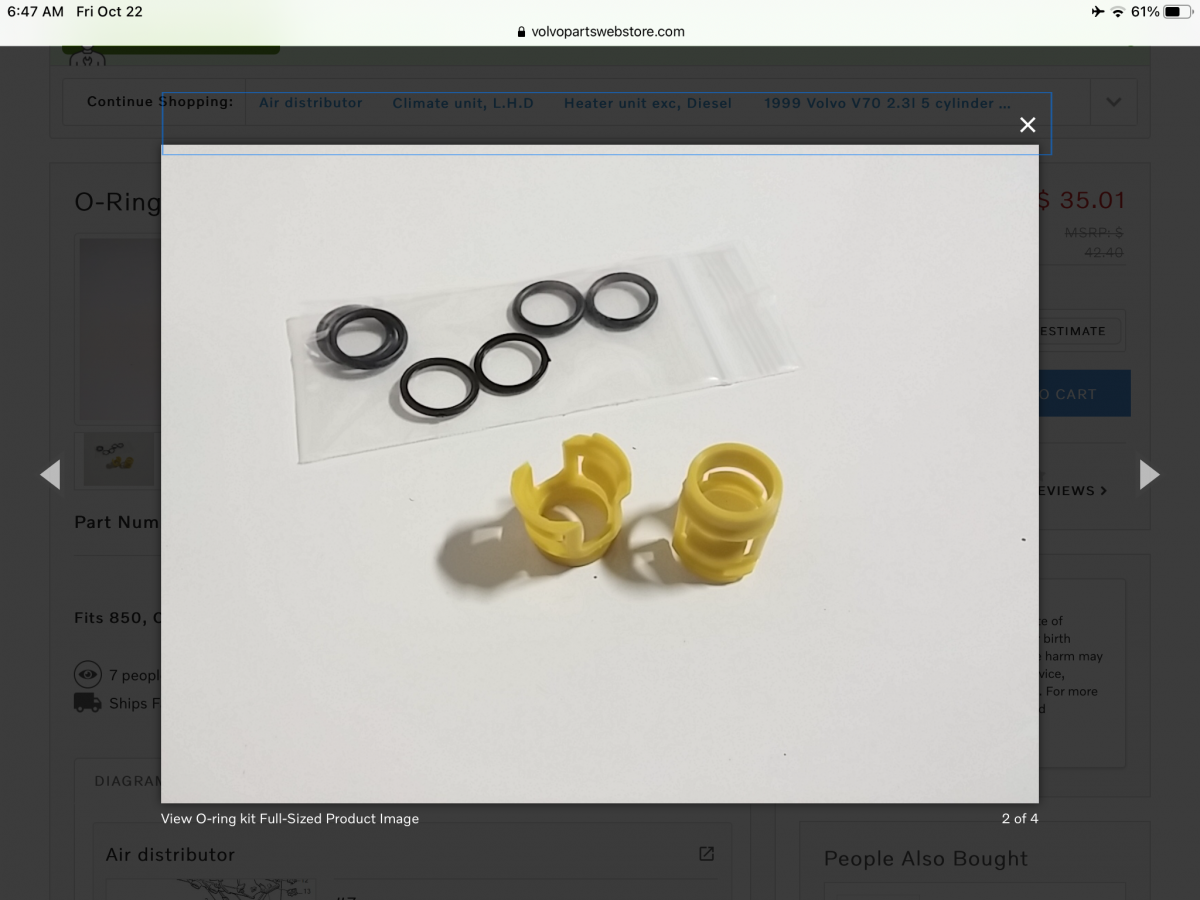

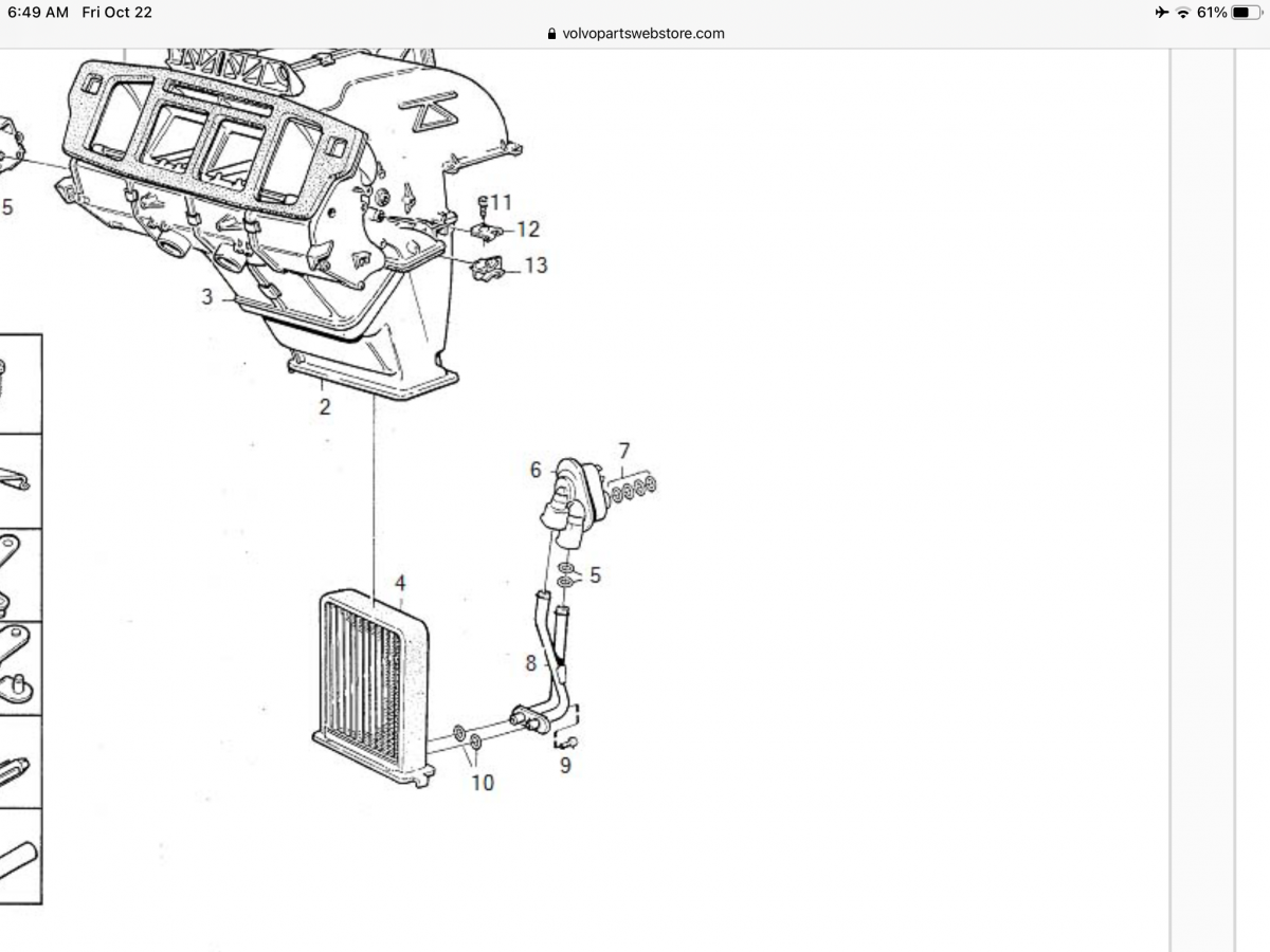

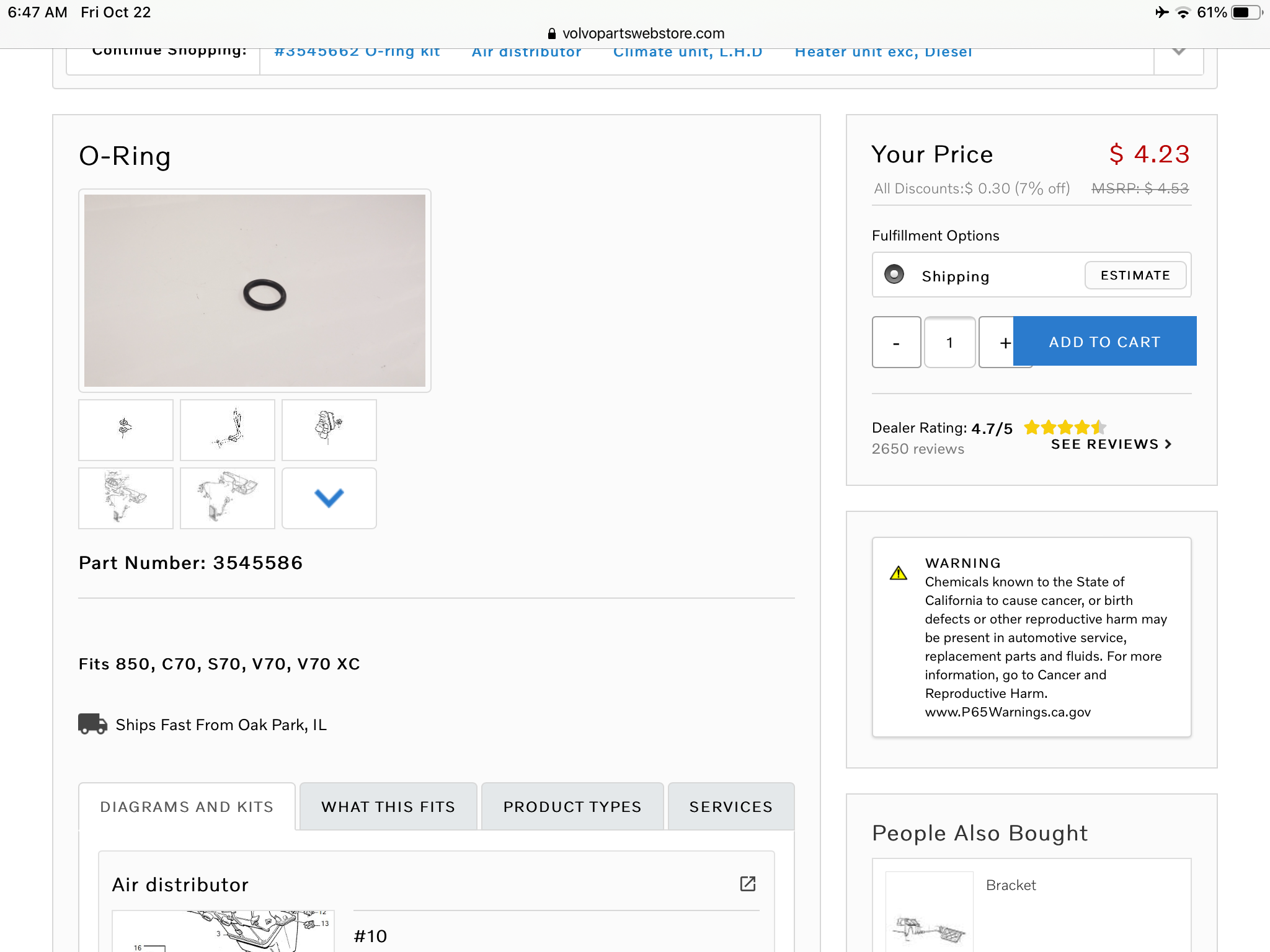

There is a little bit of confusion in Volvo webstore. These-rings are used in three places on the heater core
1 one on each pipe, in compression between core and pipes
B. INTERNAL O-ring sealing pipe to plastic junction inside car…one or two per pipe?
iii. At the firewall connection, where I believe the fitment is, from front of car ( amd so loading order)
Fat spacer, oring, thin spacer, oring

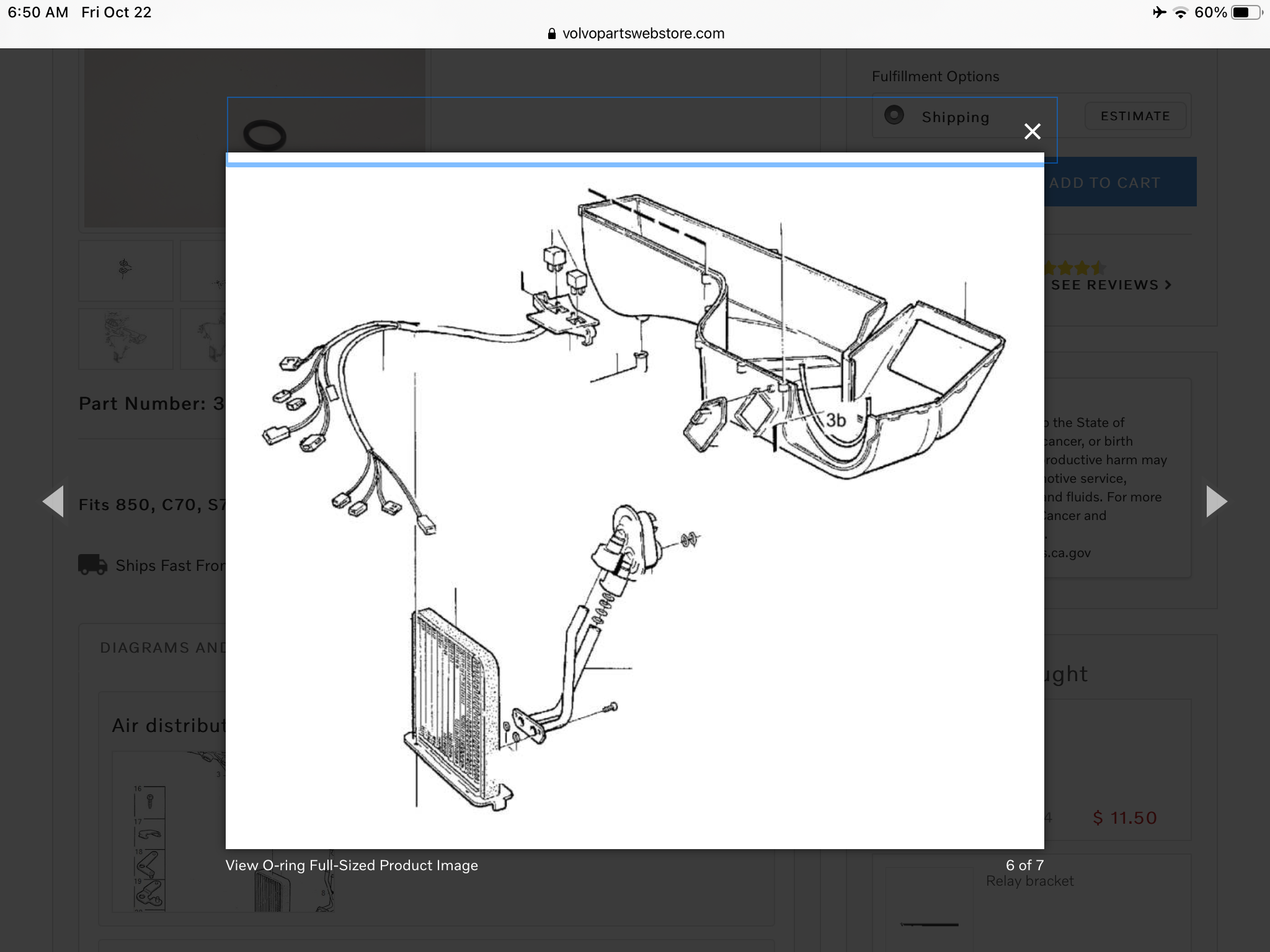

The diagrams in Volvo webstore, for air distribution box, conflict a bit.
P80 air distributor heater core o-rings 3545586 confusion

Also , number 9 , a t25? Torx screw is loaded from the rear, not front of car as depicted

The torx screw number 9 indeed loads from the rear of the car.abscate wrote: 22 Oct 2021, 04:57 Also , number 9 , a t25? Torx screw is loaded from the rear, not front of car as depicted
The o-rings and spacers, it's been too long since I took one apart. Hopefully it stays that way. But if you search it is definitely in the fora.
EDIT: I had it wrong, fixed the text to match reality.

Hmmm. My 1999 the Torx head is rearward and the 1999 I just did was the same
The threads are in the black plastic manifold , Professor?
- Posts: 11913
- Joined: 25 Jul 2009, 14:03
- Has thanked: 312 times
- Been thanked: 818 times
Yes, I refer to the solo screw down at the bottom of the heater core. And you are right - I will edit above to avoid confusing others!

Let me share the diagram I got with the set I ordered from skandix
You need 2 per hose, and additional ones for the heater core and internal connection if you replace those. I did not take apart the internals so can't help you there
Btw, make sure you pay attention to that plastic ring... It seems there are different clips, and with the longer clips you can't use the ring, the drawing confused me but in essence that is the reason behind the 2 different drawings as far as I can tell.
I first tried to leave the fat ring on, but it wouldn't fit. upon removing it I realized the differences in the old&new clips and in the drawing.
(edited with attachment instead of link)

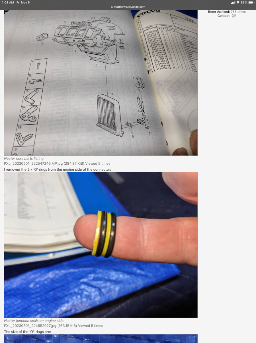

Sizes on the firewall heater o-rings measured by scot850…
