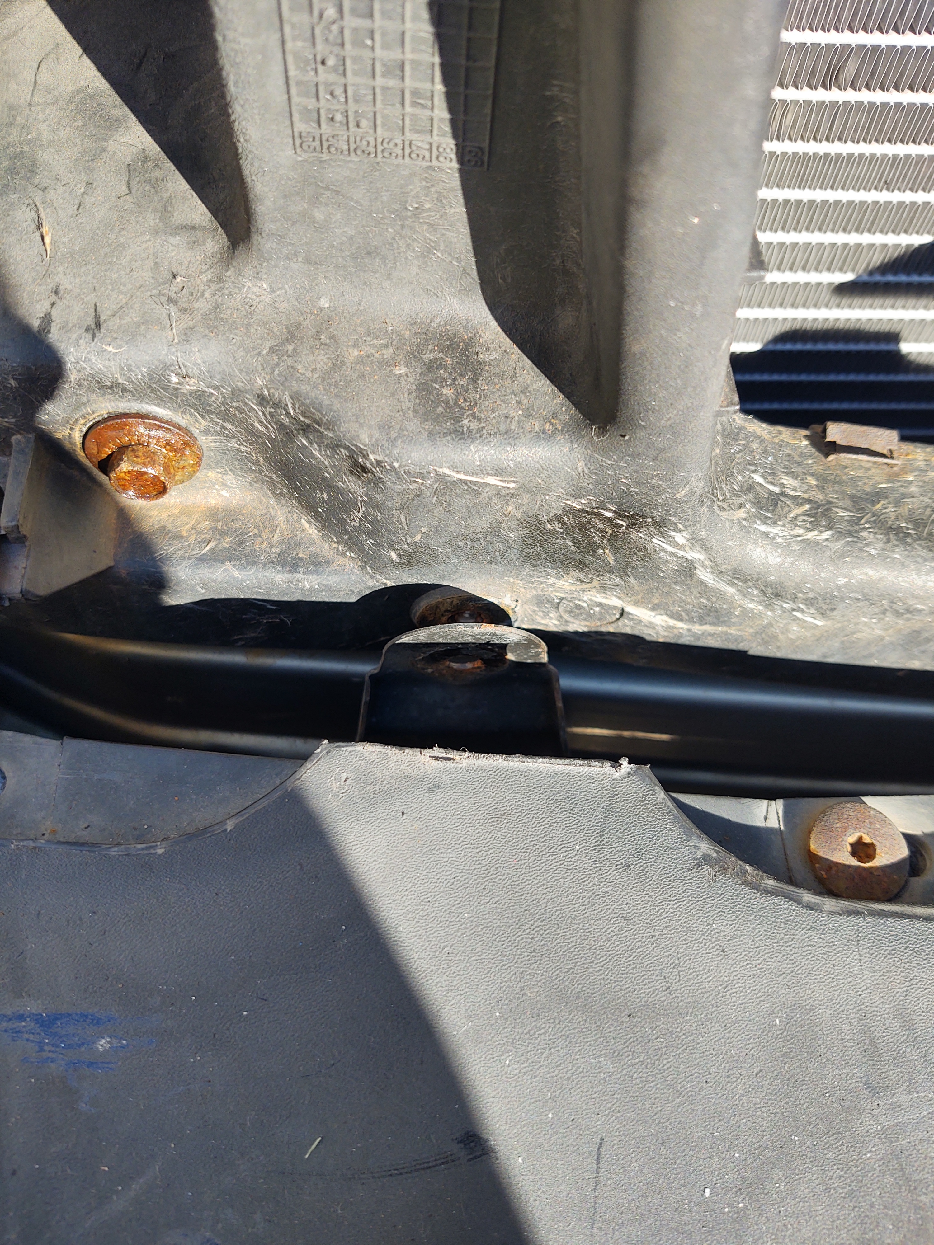

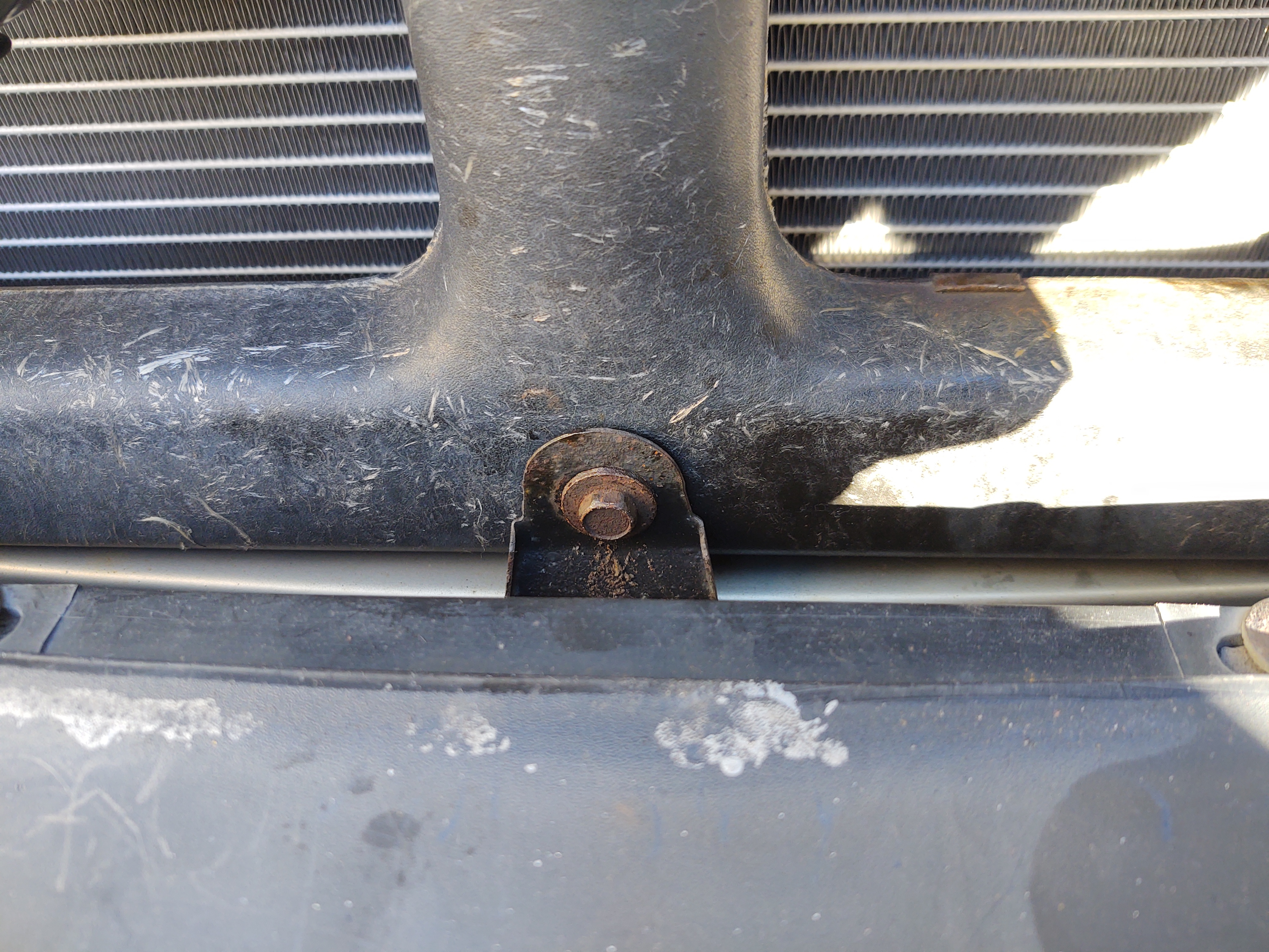

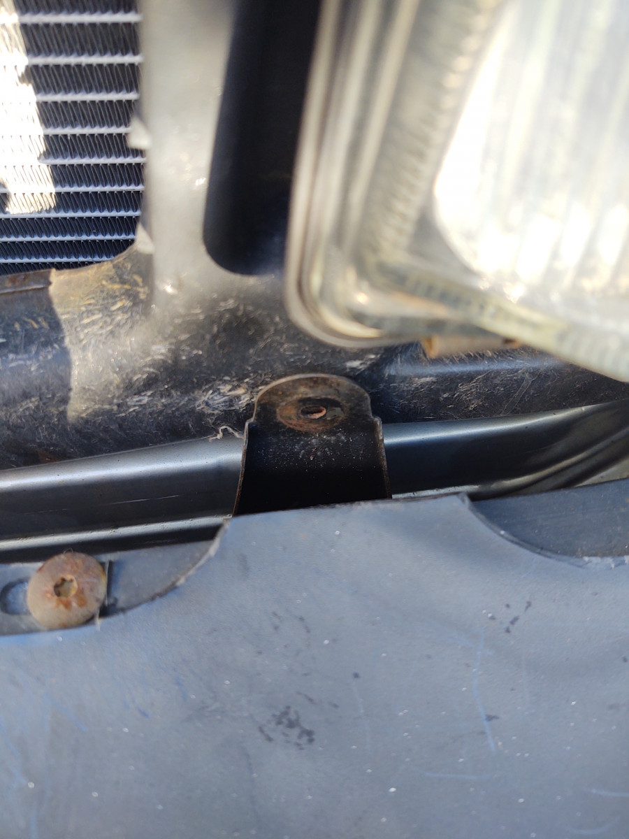

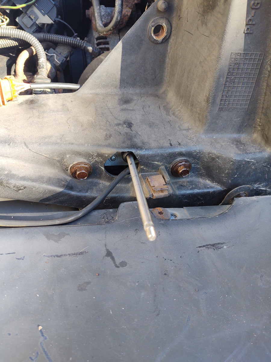

I got the passenger headlight wiper motor out and replaced it with a new one. I followed the instruction in this thread viewtopic.php?t=62676. However, I was not as lucky as the OP of that thread. My car is 26 years old and located in Boston area. So some of the bolts for the radiator core support (front panel ?) were very rusty. I tried to be very careful and used PB blaster; still three of out the 7 bolts were broken during unscrewing. The remaining 4 bolts are holding the core support (front panel) now. So far, it feels solid. The 2 bolts holding the radiator/condenser to the core support were fine too.
