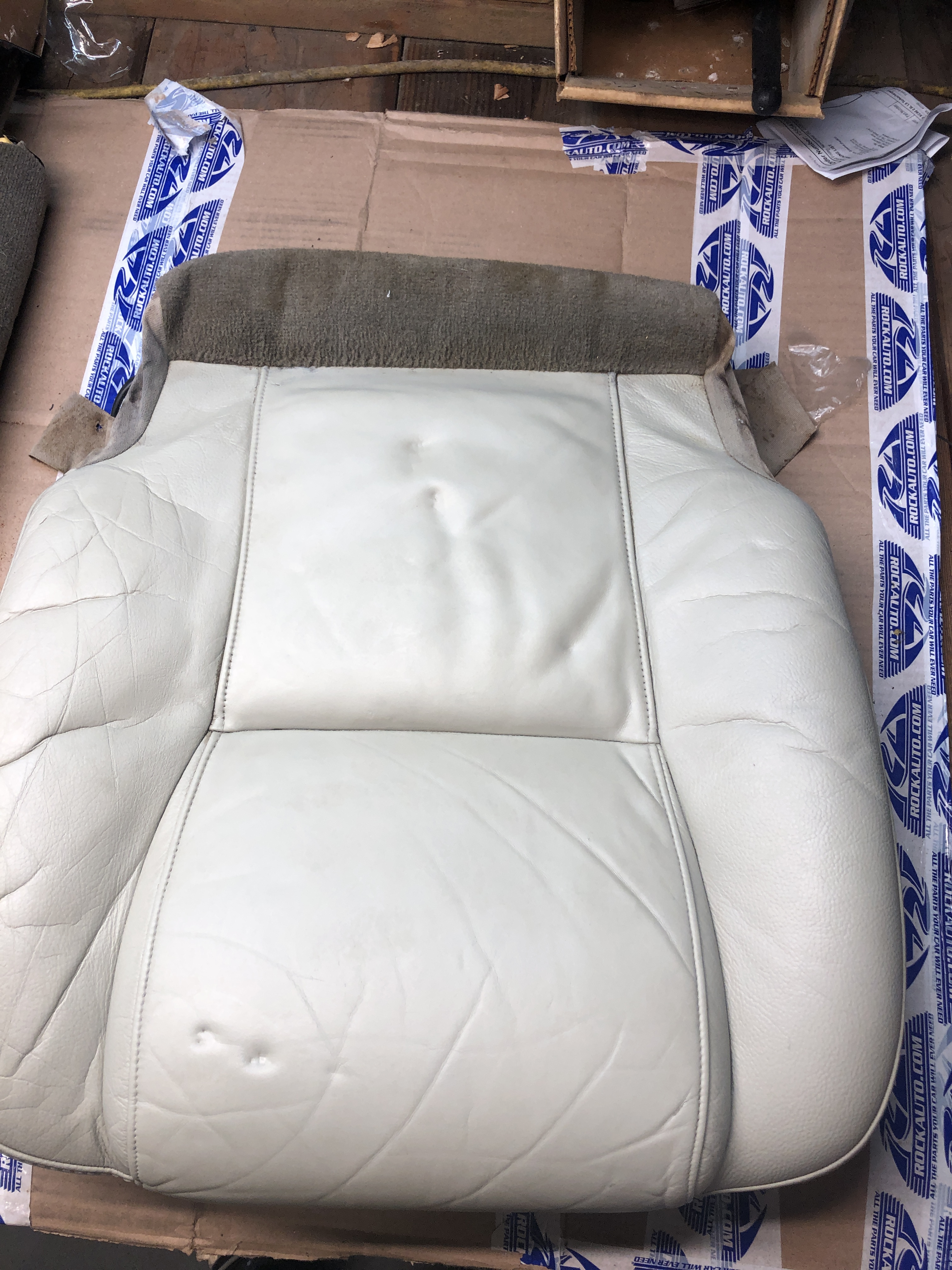

Old seat
Old seat

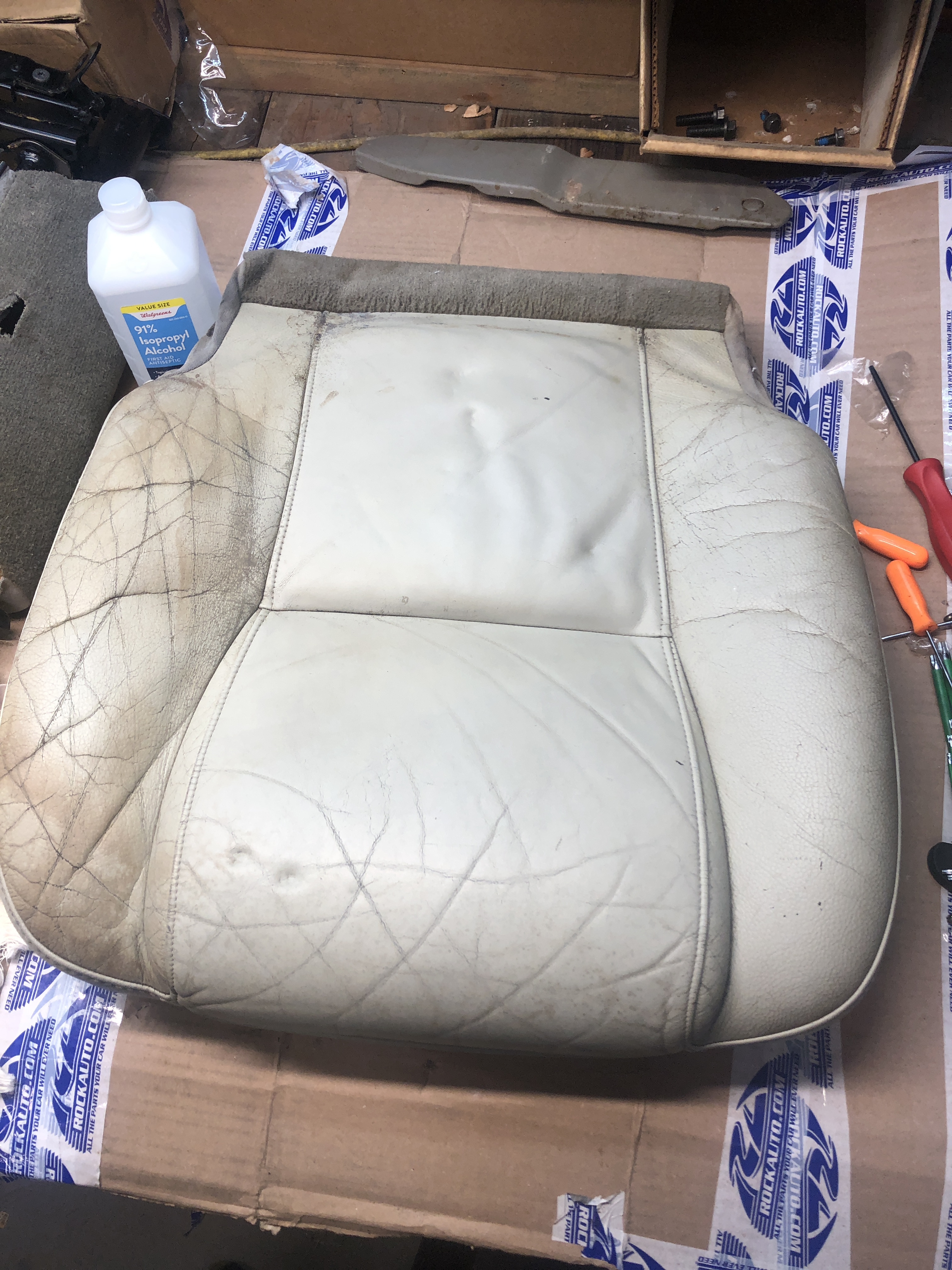

New seat before refurb

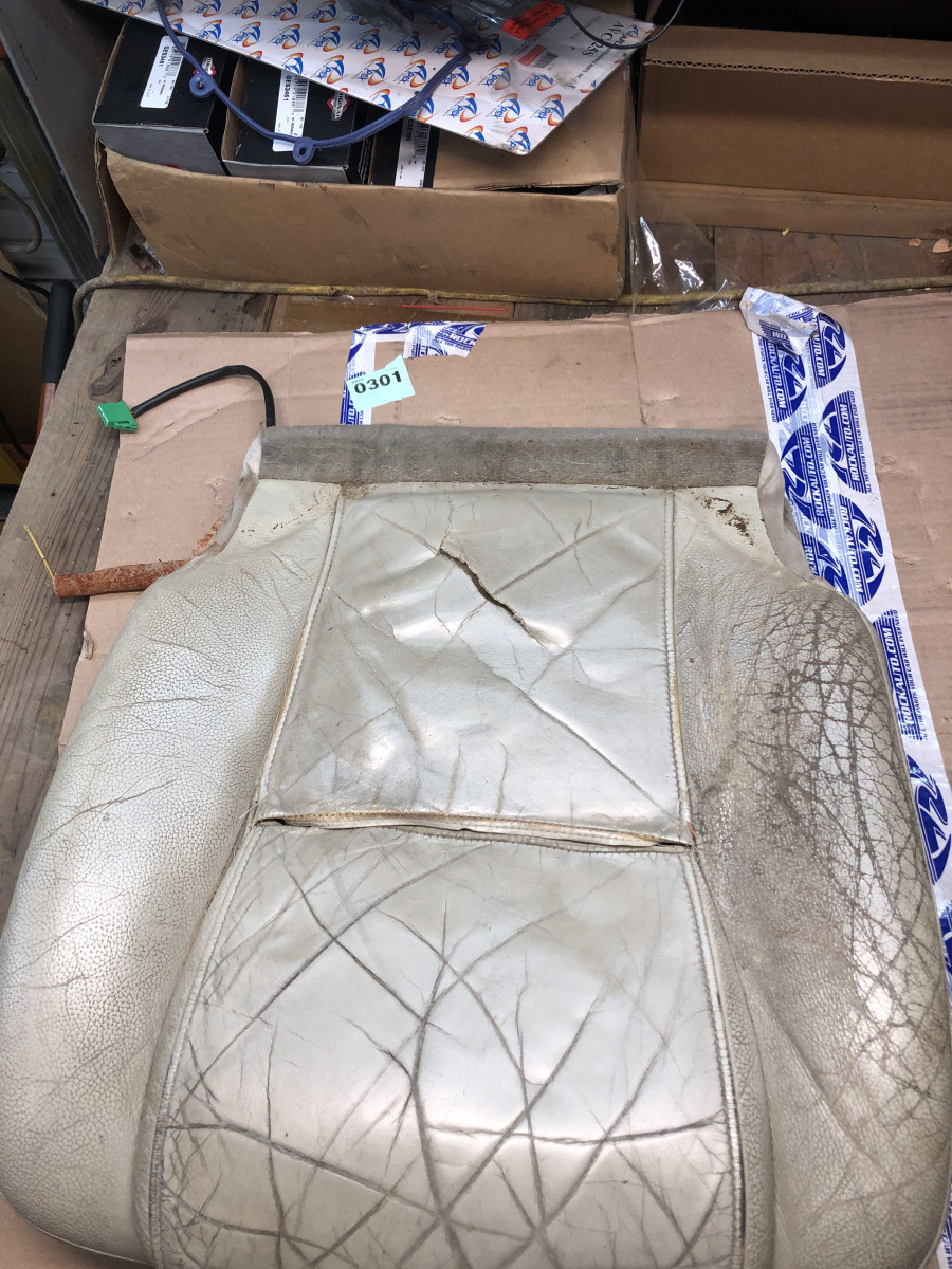

New seat after refurb
