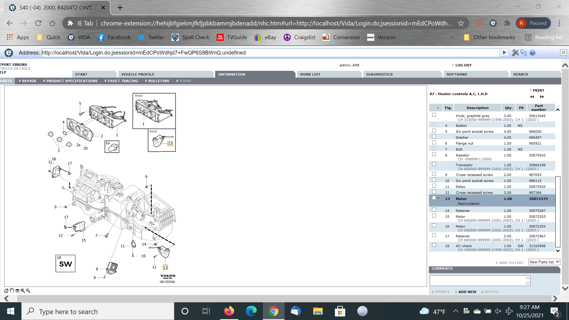

Recirculation motor is #13. Check to see if it is working. A finger on the motor as you work the controls should get you the answer.
If you remove the Cowl under the Windshield, you should be able to see or feel the inlet door opening and closing.
