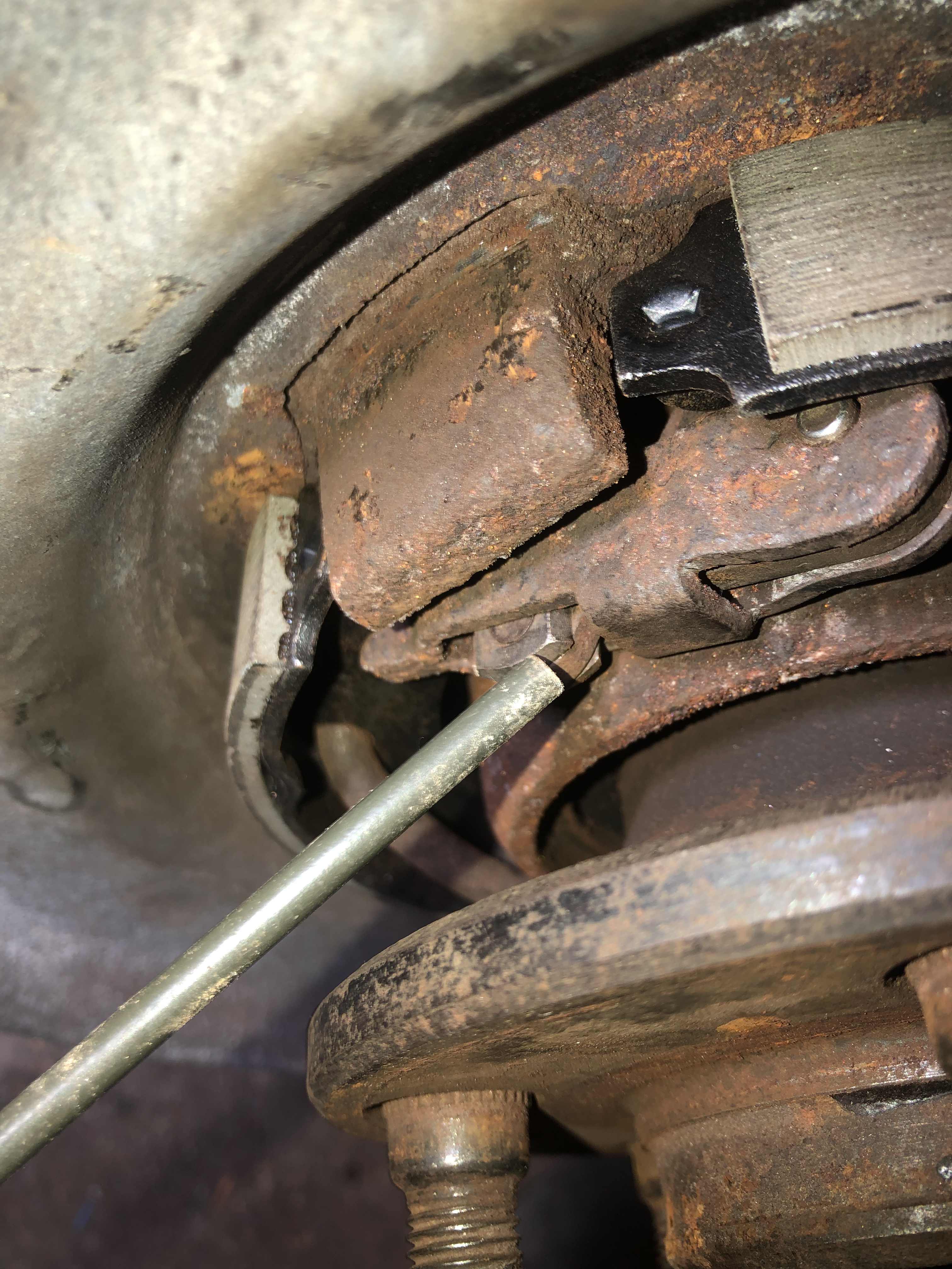

zupta82
Posts: 82
Joined: 06 Jan 2019, 18:01
Year and Model: 1995 960
Location: Utica NY
Been thanked: 1 time
Post by zupta82 »
Hello everyone I’m about ready to go nuts!! I am able to get one rotor on and fits very easily on the passenger side. So it’s definitely not an incorrect parts issue. It seems that the cable pivot point on the drivers side is stuck in. I tried adjusting the nut under the ashtray every direction. I really need to get this car done. I took some more picture to help explain what I mean by “pivot” point
