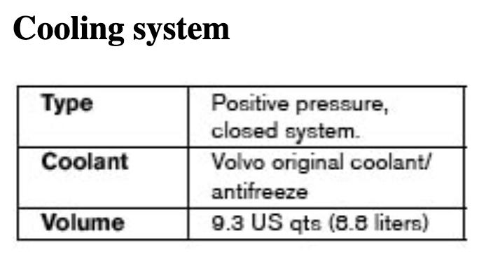

About cooling system volume, I have been going by the 07 XC70 user's manual (total capacity 9.3 quarts = 8.8 liters). This does mean you need to pick up and crack into a second bottle of coolant.

Just to close this out. I ended up flushing multiple times (maybe 6) with distilled water, letting teh water cycle thru the engine with thermostat open each time. Then on the final flush let as much distilled water drain as possible from the radiator petcock (about 4.5L) and added 148 fl oz (1.16 gallons, 4.38 L) of Volvo coolant. The resulting mix had a specific gravity reading on my refractometer that indicated -45C freezing point which based on graphs I found for ethylene glycol indicates about 55/45 mix. Doing the math that means the overall capacity is 8L. Obviously not exact but certainly in the ballpark. If I understand it correctly while 55/45 lowers the freezing point more than 50/50, it reduces the specific heat capacity. I also believe anything more that 60 or 65% coolant and the freezing point start to rise again so 50 - 55% is about right. All a little too precise I know but now I know where I stand I will top up as necessary with distilled water until the dilution goes down to 50/50.
