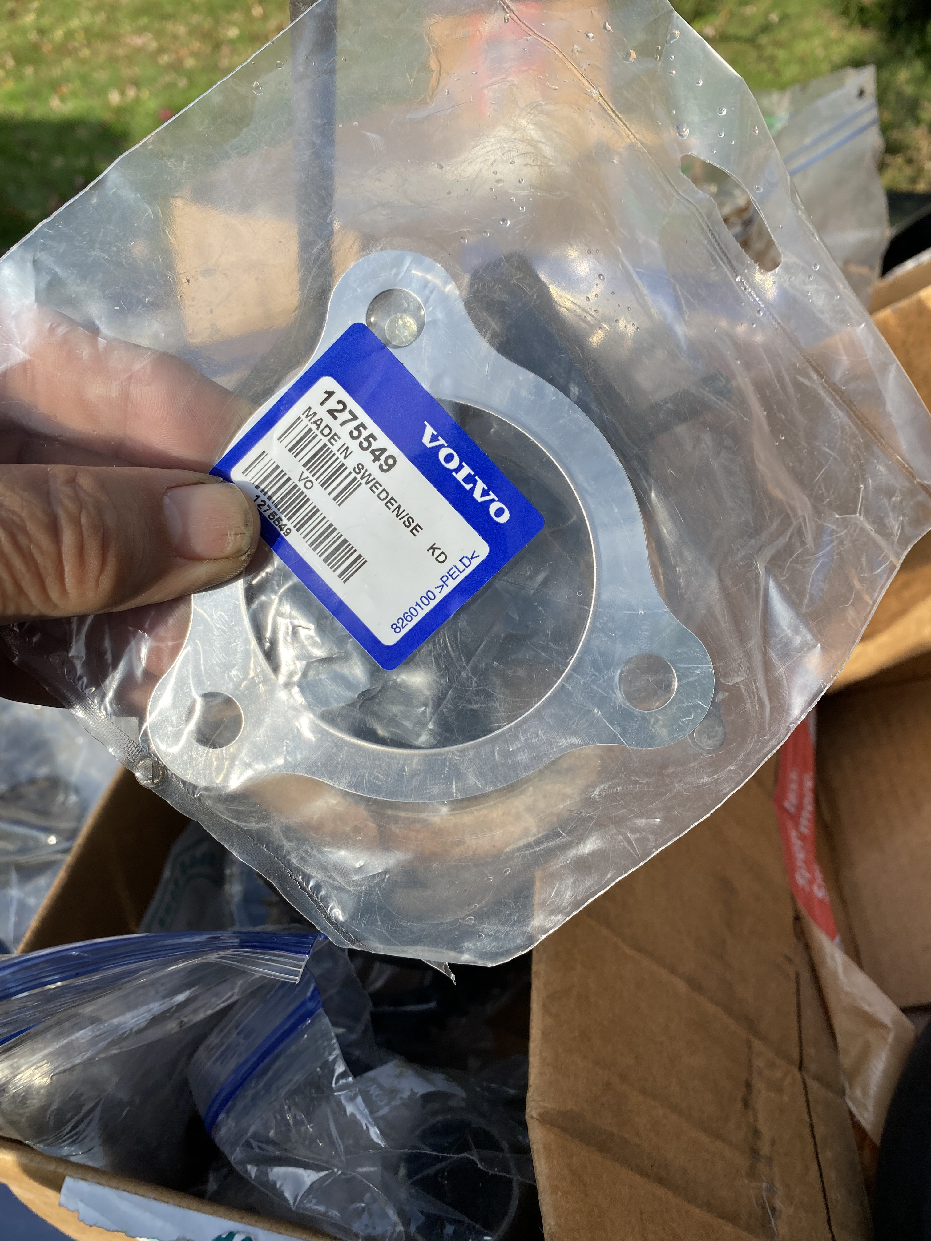

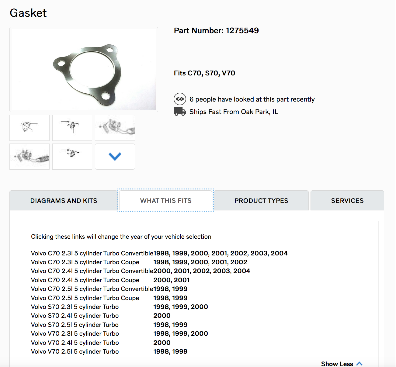

Both Volvo webstore and FCP report part number 1275549 , incorrectly for this part
I believe correct part is 8642449 , on order to be confirmed

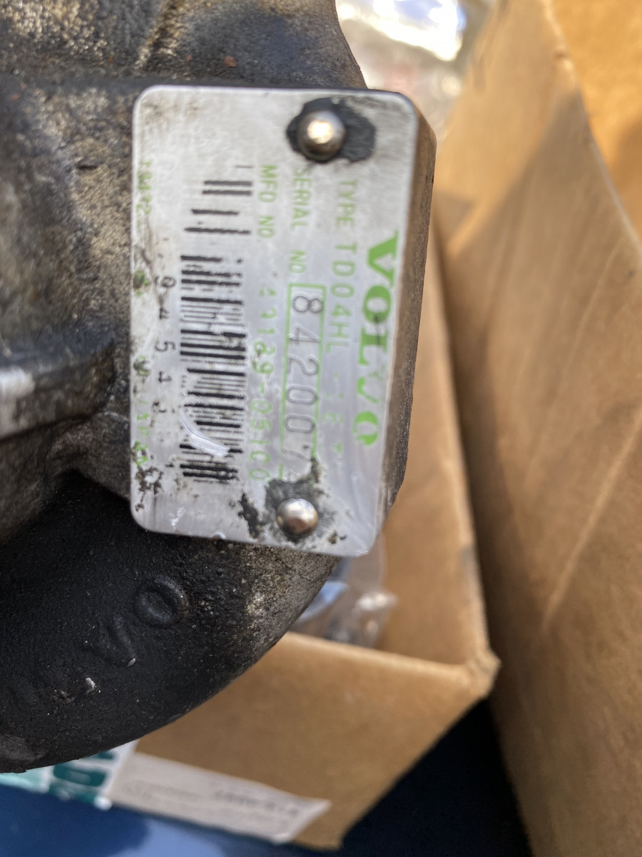

Turbo part number is
Volvo 9454561
Mitsubishi 49189-5100

Top stud lined up , bottom two miss by about 1 cm
