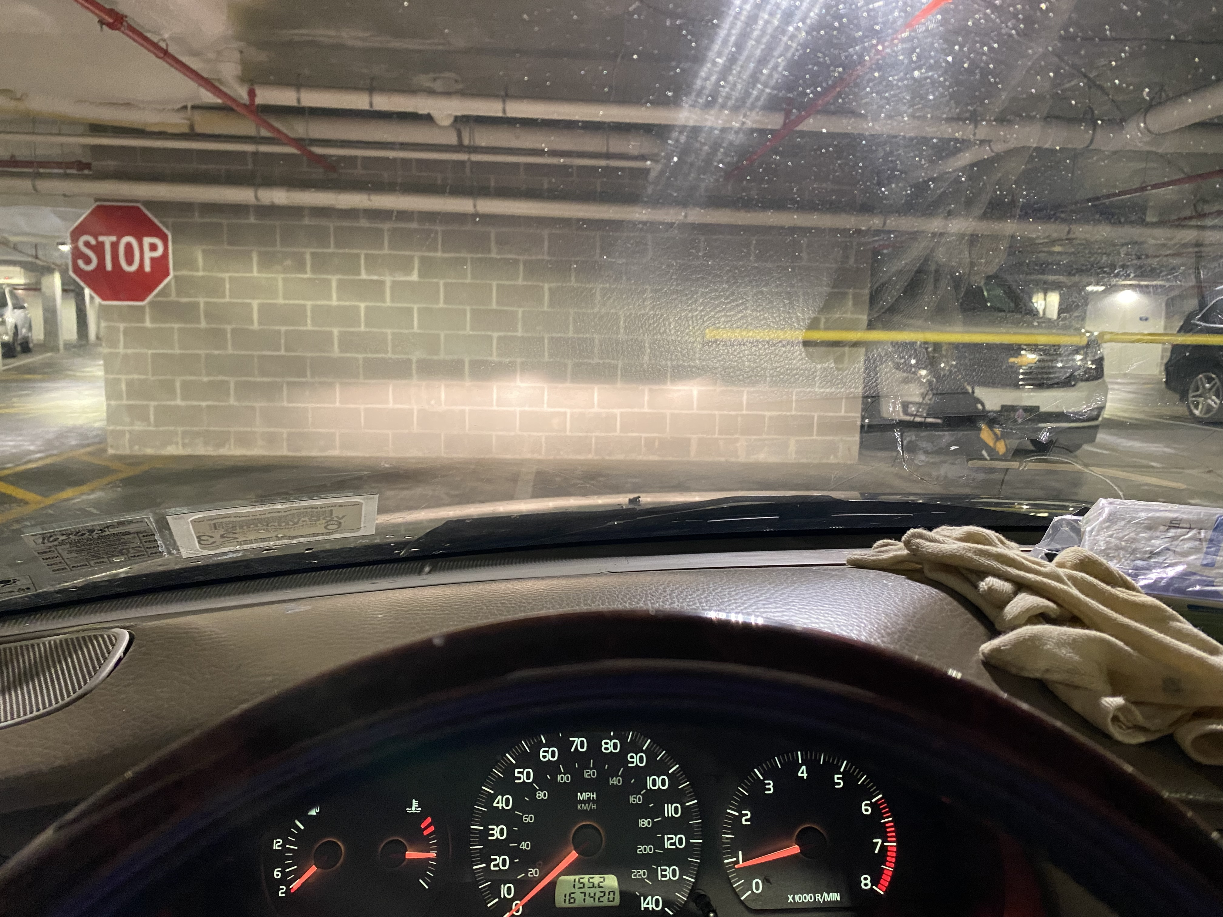

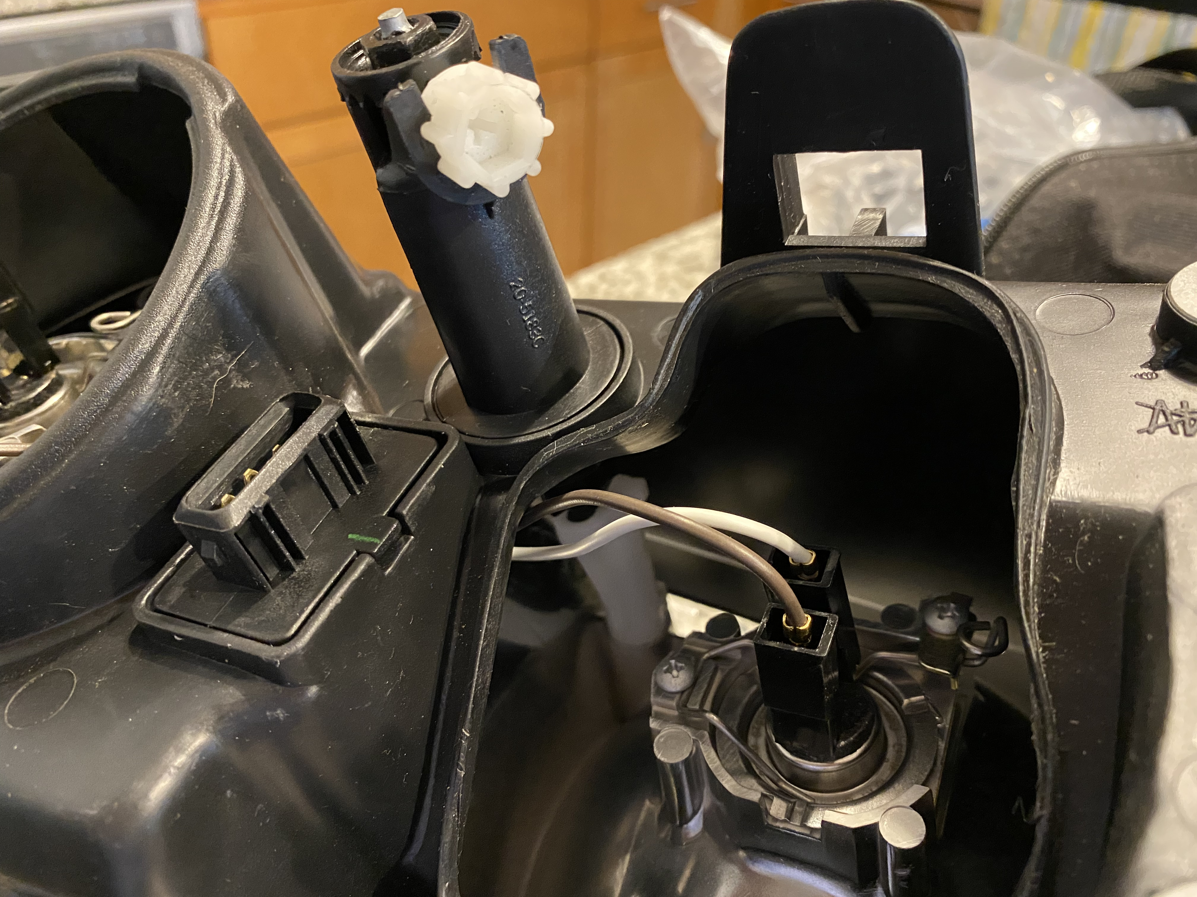

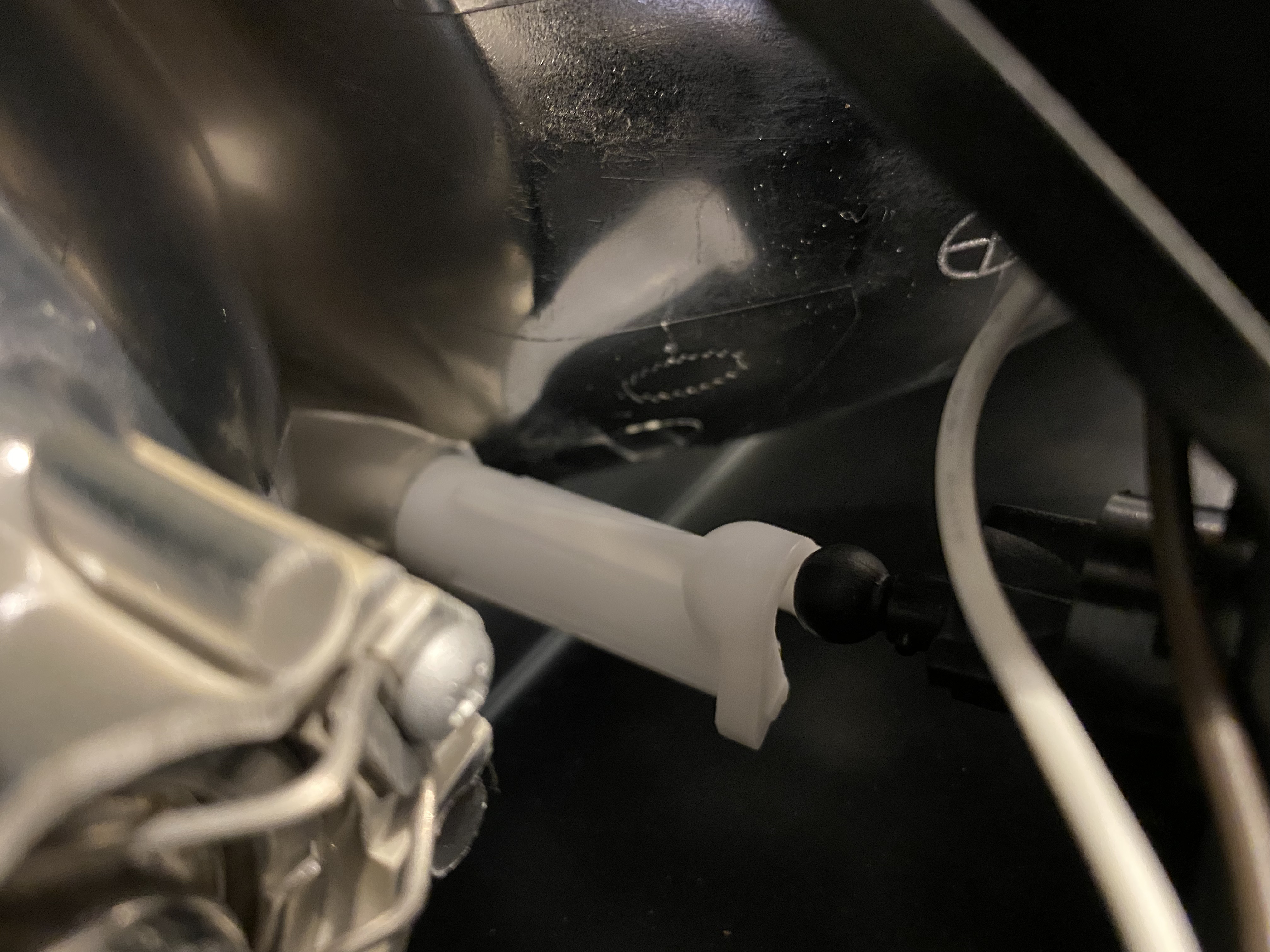

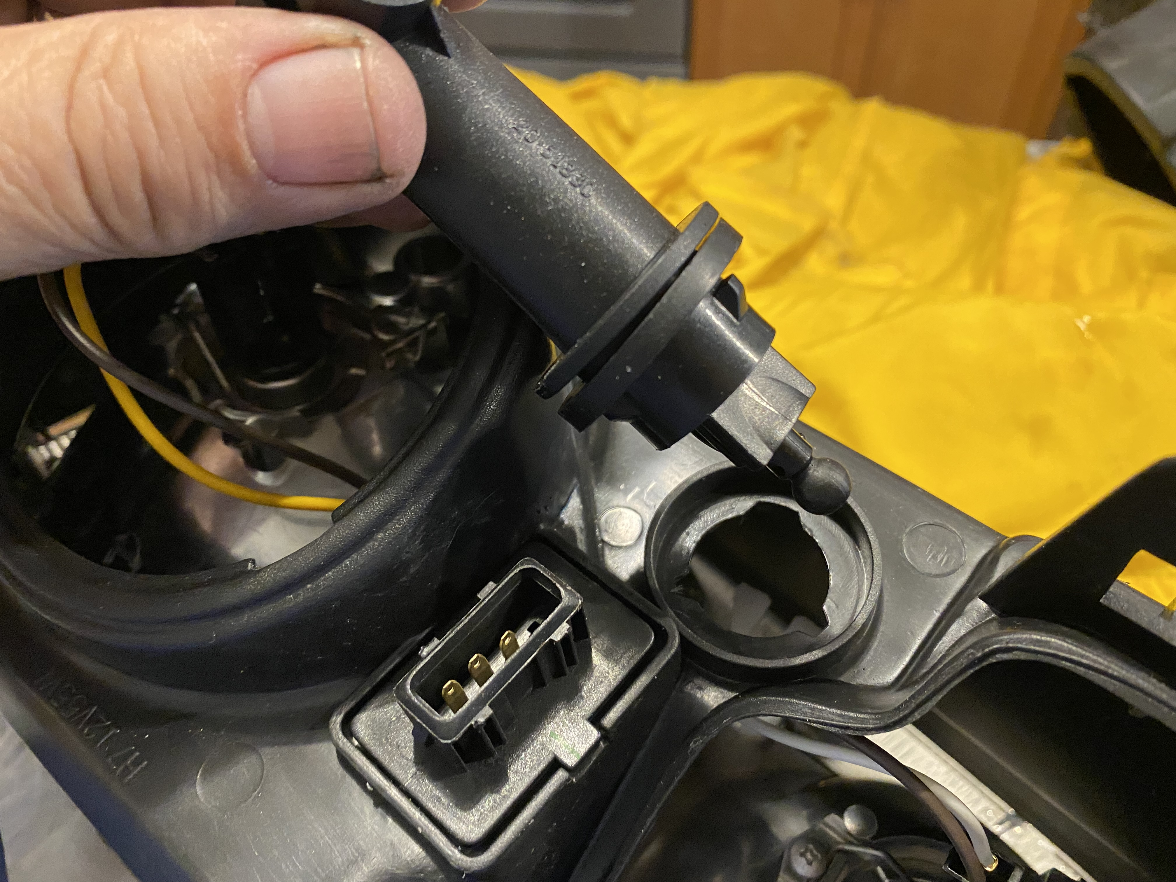

Put in pair of TYC headlights. The adjuster on one had popped out, but I was able to snap it in by hand.
Adjusted at 20 feet to centerline them. No horizontal needed, both needed raising slightly from zero bubble
