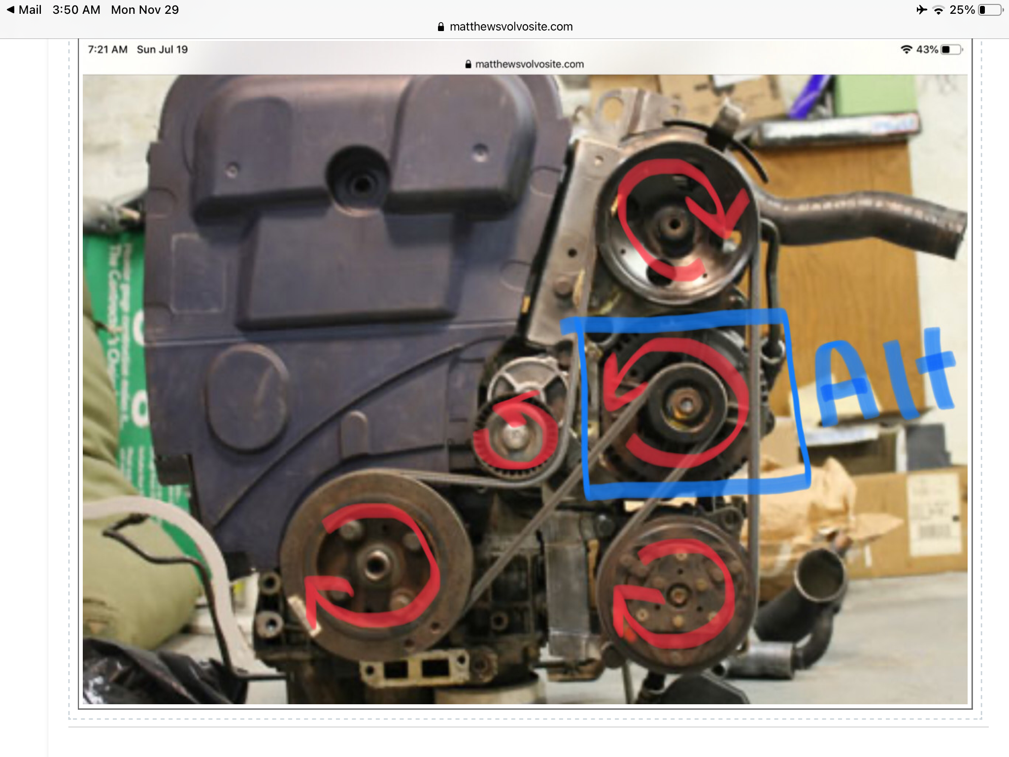

I did a lot of serp belts bringing 4 1999- cars up to 50k PM this year, and did find a quick way to both Route and install serp belts.
Part numbers in title, both Volvo and Continental
I used a 14 mm wrench and a 2 foot long broom stick or tire iron.
Make an upside down U with the belt. It’s ribbed on both sides for your install pleasure.
Now squeeze the top of the U under the tensioner pulley and drop the two loops - one under the crank pulley, the other under the AC
Use the stick to seat the ribs in those two pulleys
Now you separate the top of the U, and the lower part goes over the alternator pulley. This turns backwards on 1999- and will only charge turning ccw
You know have the top loop last, and it will just reach the power steering pulley but not quite Go on.
With the14 mm wrench, pull it forward to ease tension on the belt and slip it onto the PS pulley.if it won’t go, you usually have some ribs thst have slipped off a ribbed pulley somewhere. Mmmmmm, ribs….
Voila!
Picture of 1999- belt routing attached
P80 1999- serpentine belt install 6DK1841 9458376, 30731808, 9471981
