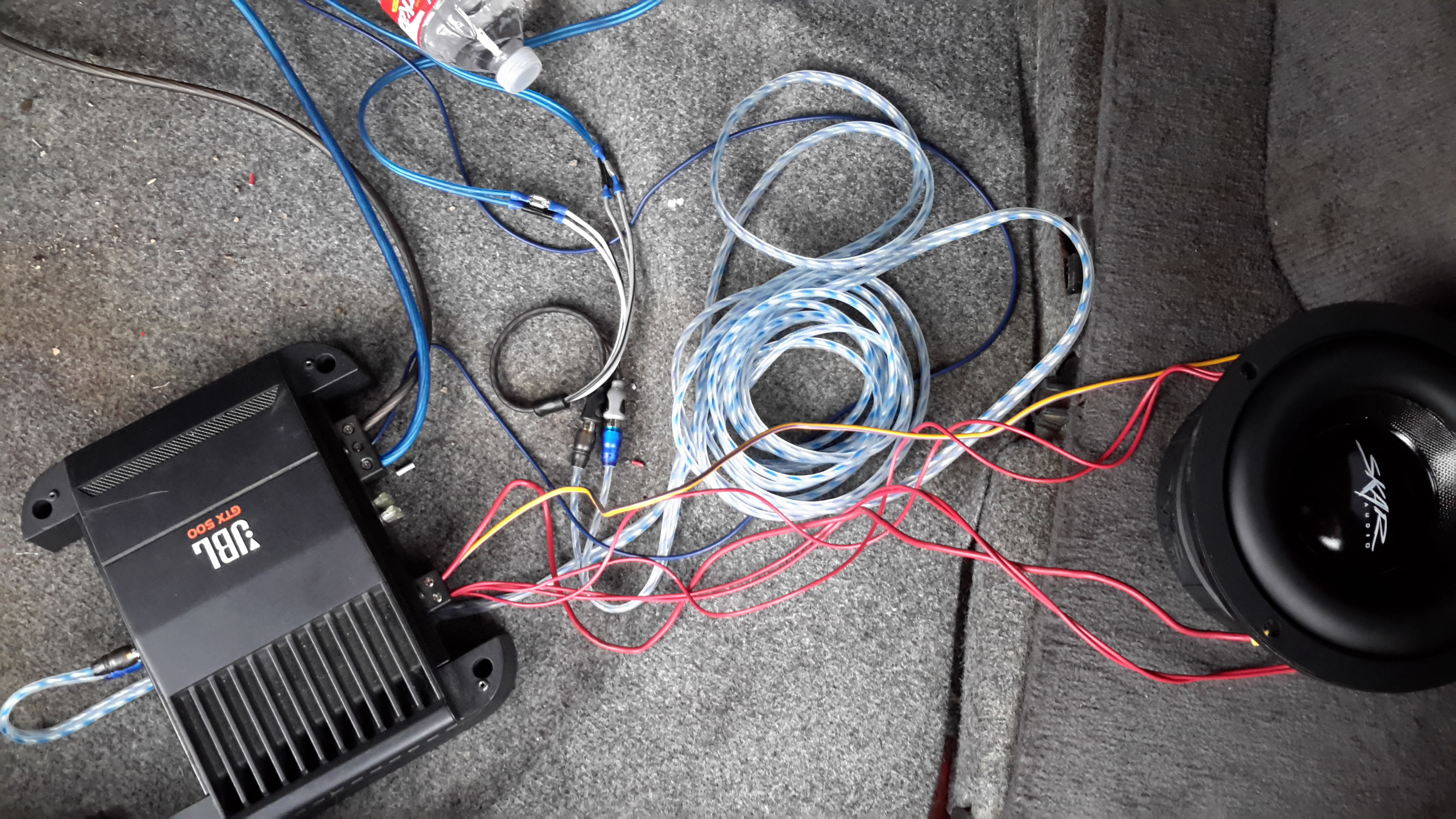

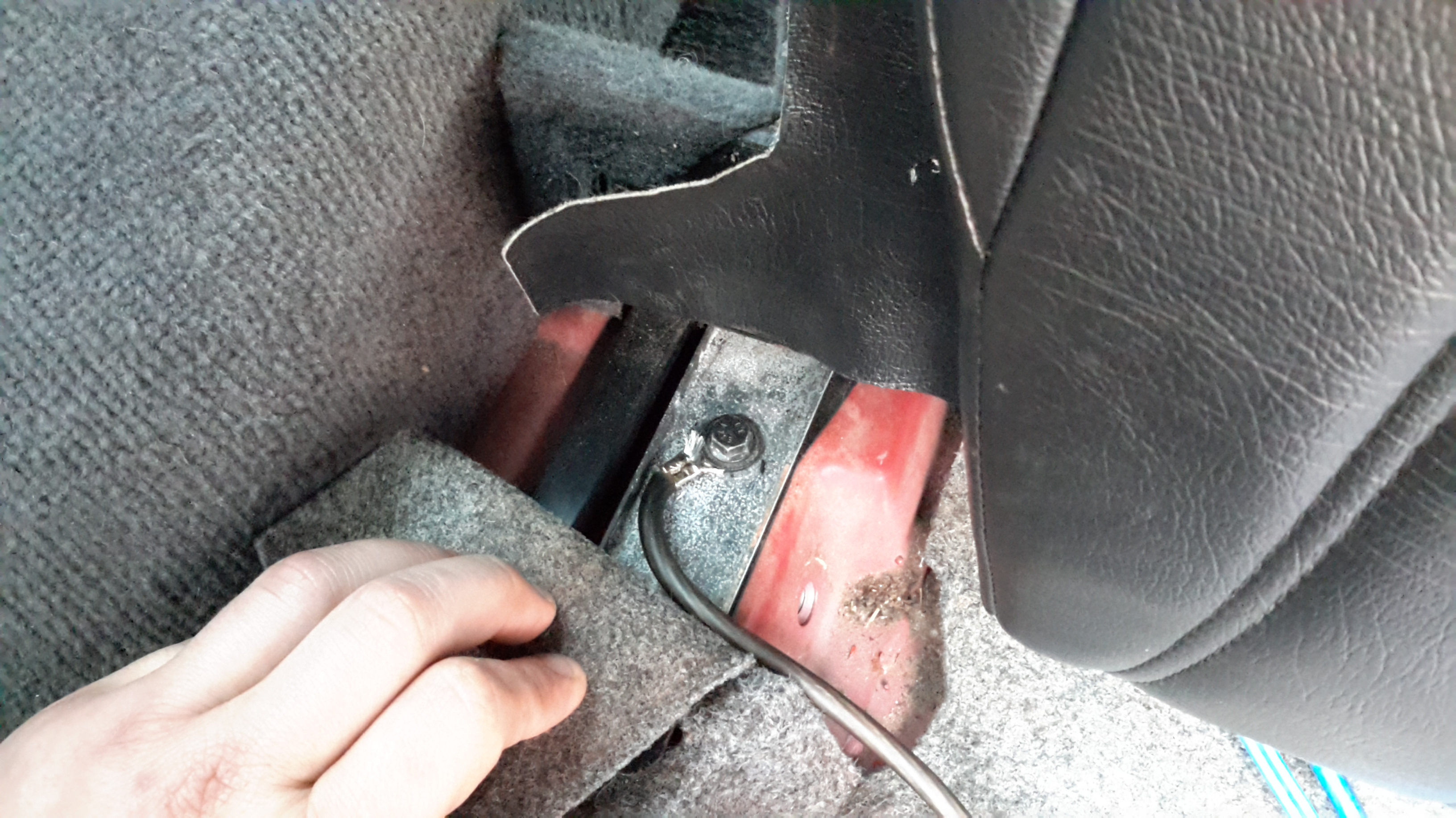

Pics attached of trunk connections. To connect the blue 'turn on' wire, I created a 3-wire branch for the ignition wire on the harness on back of radio (pin 13). I put the ground through the bolt that holds the left side of the third row seat down. If I cant figure this out, Im going to disconnect the amp/sub and wire the Skar sub to the center channel of the SC901.RickHaleParker wrote: 04 Dec 2021, 05:38No.CIK7 wrote: 03 Dec 2021, 17:05 Would this create a high pitched squeal? I dont have static or buzzing. I have a high pitched squeal that has blown the factory radio/amp fuse #7 twice. What could this be?
Squeal: check your power grounds. If they are at different potentials that can cause squealing. For example one grounded to the metal chassis and another grounded through a small wire. Measuring the voltage from one ground to another ground will tell if you got this problem. Ideally the difference should be zero with the equipment turned on.
Too small of power cables on the amps can cause squealing and even damage a Amp when the amp is drawing a lot of current. The voltage drops across the cables .... or a bad ground.

Take the ground bolt out an clean the metal, frame, lug, bolt, washer and threads.It should be shiny bare metal. Any coating will increase the resistance. Solder the lug to the wire that, will decrease the resistance also. Flow the solder into the connection.
