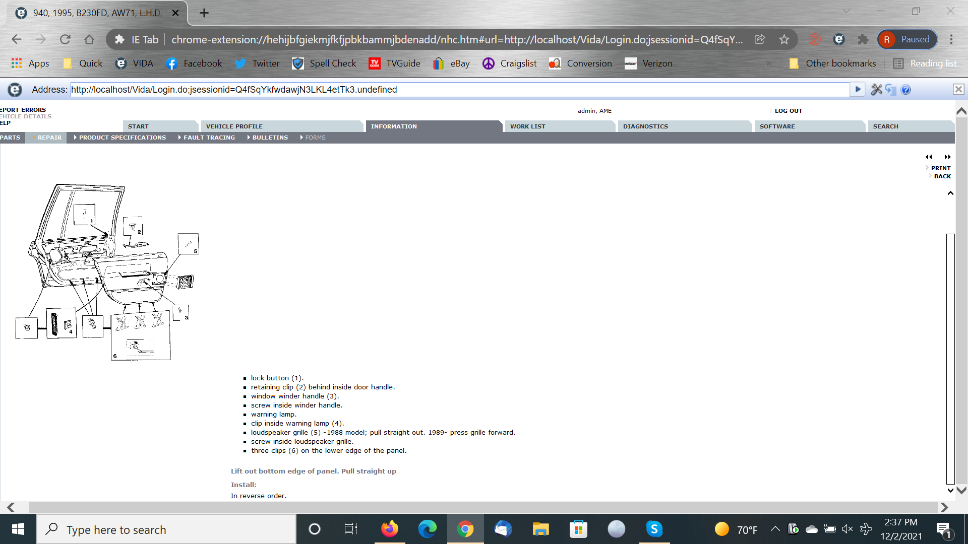

I am Marilyn, I am 75 years old I own a 1995/940 volvo. My grndson slamed my right back door and window jumped off track I am trying to take off panel to put it back on. Can't find out how to remove the panel can I get any help? Thanks so much
- RickHaleParker
- Posts: 7204
- Joined: 25 May 2015, 14:30
- Location: Kansas
- Been thanked: 979 times
Removal
- 1. lock button (1).
2. Retaining clip (2) behind inside door handle.
3. Window winder handle (3).
4. Screw inside winder handle.
5. warning lamp.
6. Clip inside warning lamp (4).
7. Loudspeaker grille (5) -1988 model; pull straight out. 1989- press grille forward.
8. Screw inside loudspeaker grille.
9. Three clips (6) on the lower edge of the panel.
10. Lift out bottom edge of panel. Pull straight up
Install:
In reverse order.
If you cannot read this click on it to enlarge.
