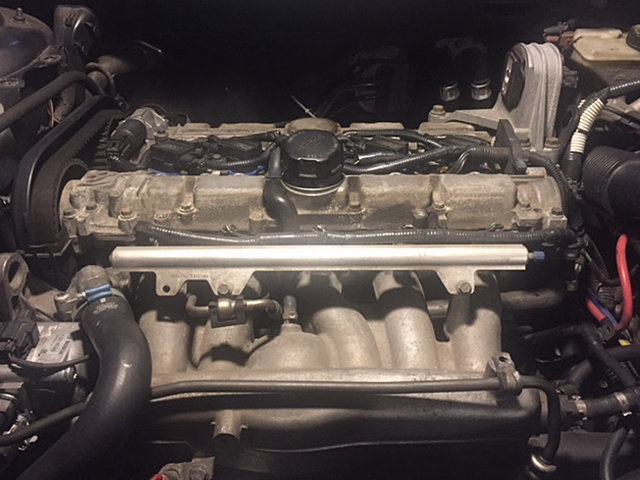

volvolugnut; next dumb question. Where is the "engine fuel manifold" located? Is that under the hood or under the chassis near the fuel filter?

This release valve is in the engine compartment -- see fuel rail item #1, right end.volvolugnut wrote: 13 Dec 2021, 10:56There should be a tire valve stem like thing on the end of the engine fuel manifold. Remove the cap, cover with a rag, and push in the stem inside the tube.Mr. Detail wrote: 13 Dec 2021, 10:27 regent, how do I relieve the fuel pressure other than pinching the tabs on each end of the old filter and pulling out?

Mr. Detail wrote: 13 Dec 2021, 14:10 volvolugnut; next dumb question. Where is the "engine fuel manifold" located? Is that under the hood or under the chassis near the fuel filter?
