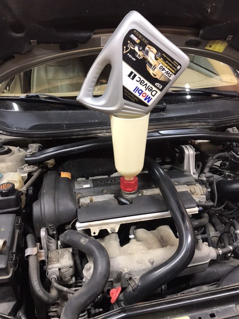

Is this the first time you yourself have changed the spark plugs?
Do you do your own oil changes or pay someone else to do it for you?
If it were me, I’d clean out the plug holes (with the spark plugs screwed in still) with some paper towels. Compressed air next. Then continue on with life and recheck the afflicted holes in a couple weeks time. Chances are someone spilled oil when they were pouring it in.
Here’s a marvelous apparatus for eliminating the chance of the aforementioned.
https://www.fcpeuro.com/products/europe ... it#fitment

That looks handy. I am always spilling a bit and wrapping rags around it.- Pete - wrote: ↑16 Dec 2021, 19:09Here’s a marvelous apparatus for eliminating the chance of the aforementioned.
And I am always worrying, about everything.
