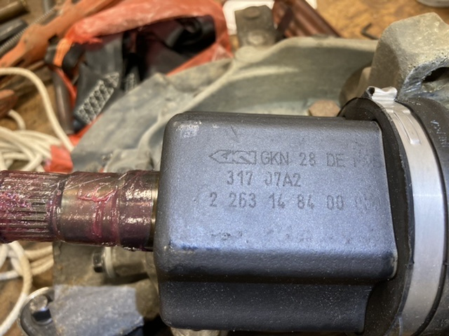

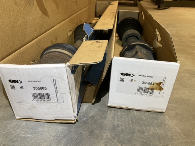

I haven’t done CV’s on my V70R, but I have done them a few times on our XC70’s. I always go with GKN Lobro. They manufacture the CV axles for Volvo & are typically 2/3’s the cost of a new Volvo CV axle. Lots of horror stories of ridiculously short life spans with non-genuine CV axles.
