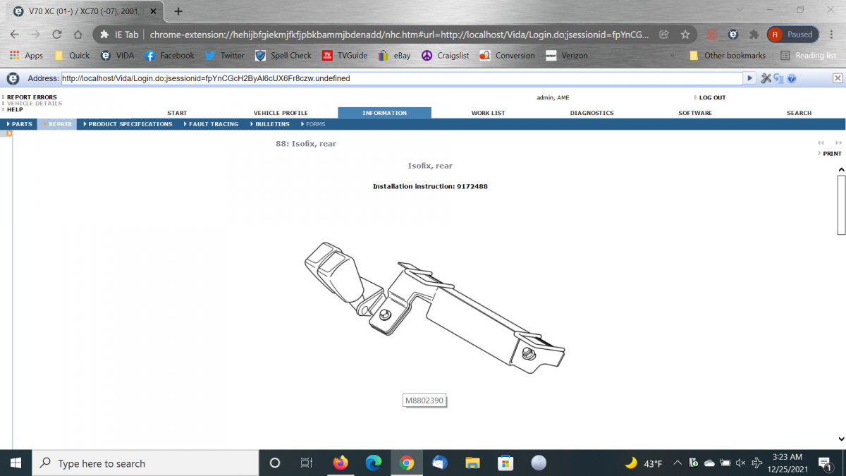

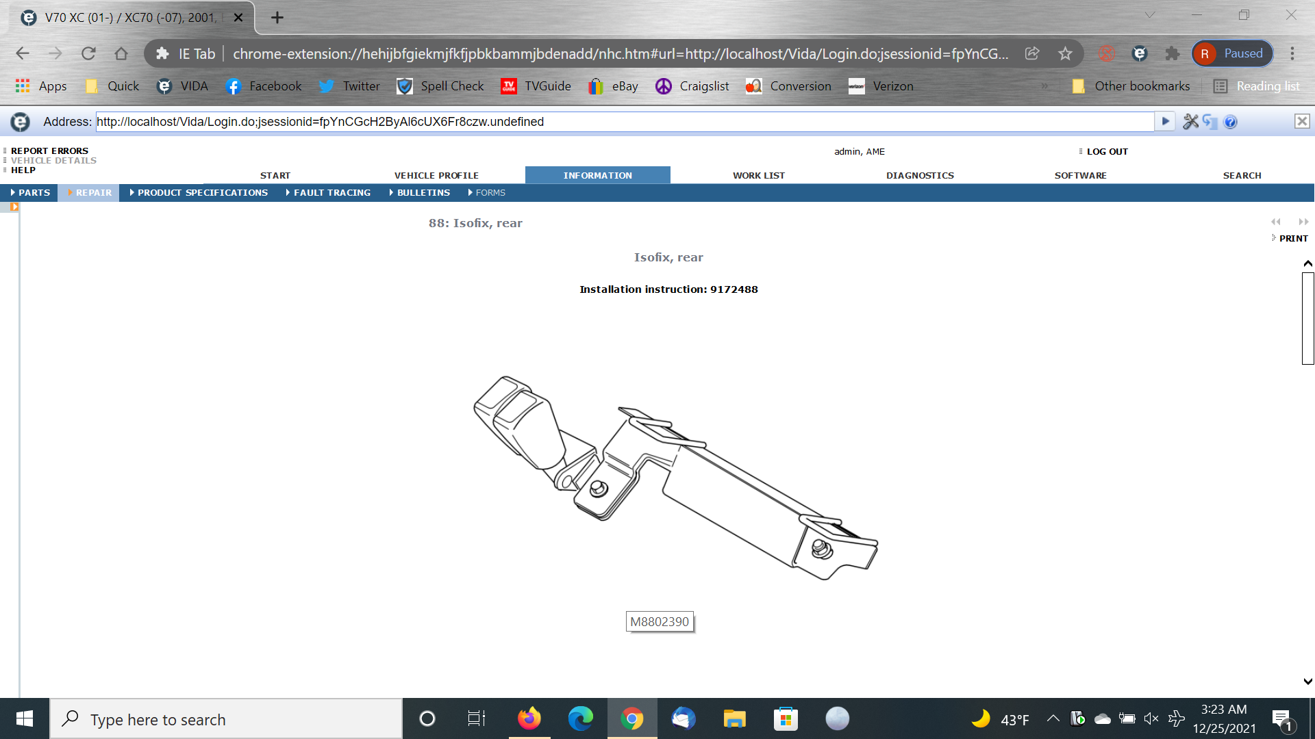

Thanks for your reply. Never heard of "Isofix mounting", so, I Googled it. Really nice contraption.RickHaleParker wrote: 25 Dec 2021, 02:25 The second row seat belt buckles? They are pinned down by the Child seat, Isofix mounting. Best to pull the rear seat cushion.
Compress the front of the seat backwards and up in one movement. Then do the other side.
The center seat does not seem to be mounted by it, or am not understanding what's holding down the middle seat.
The attached image shows what I have. The bolt is already completely unscrewed but will not pull out. I need to remove the bolt so I can pull out the seat belt catch.
Thanks.
