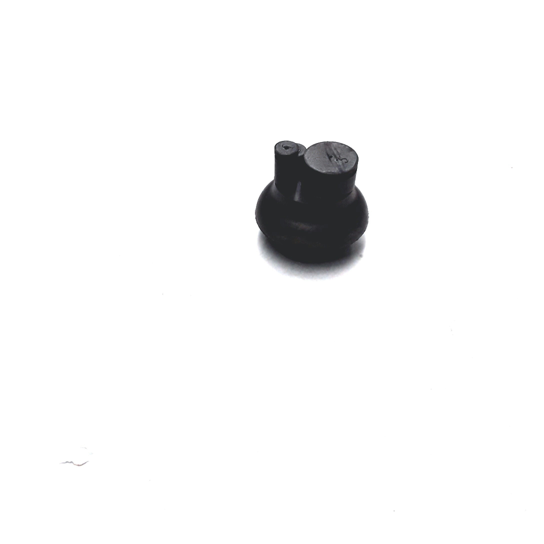

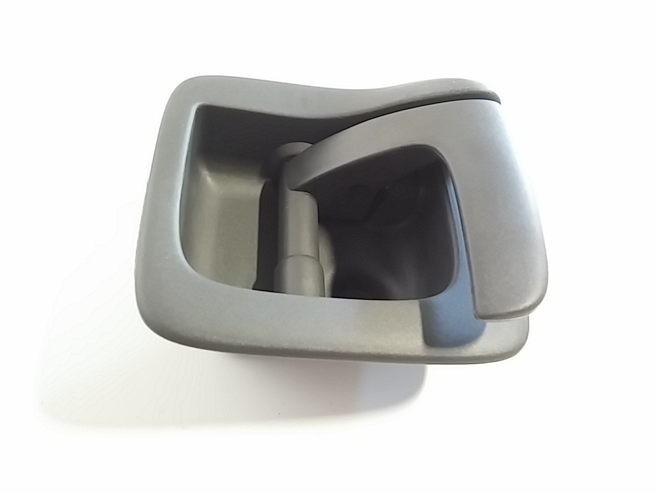

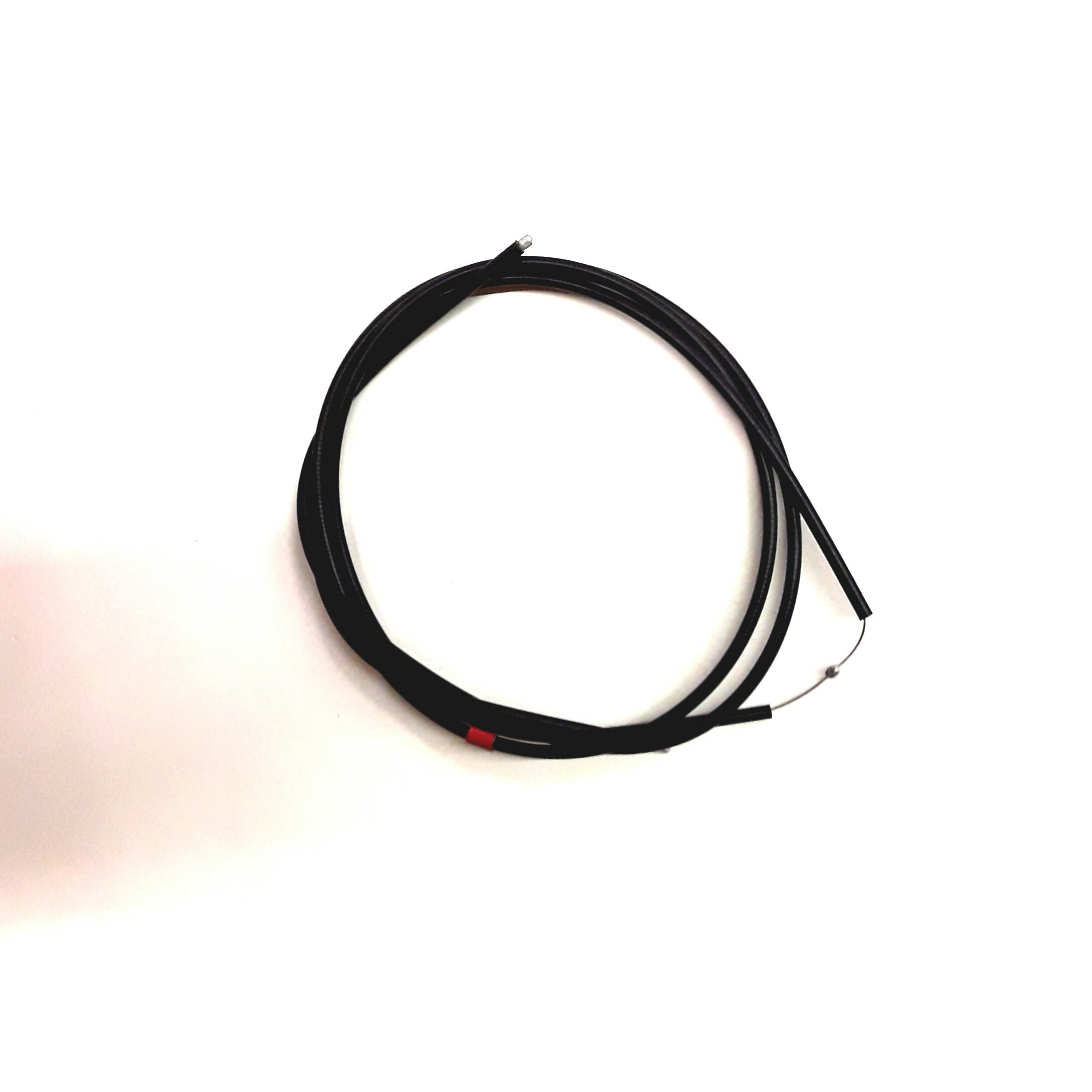

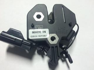

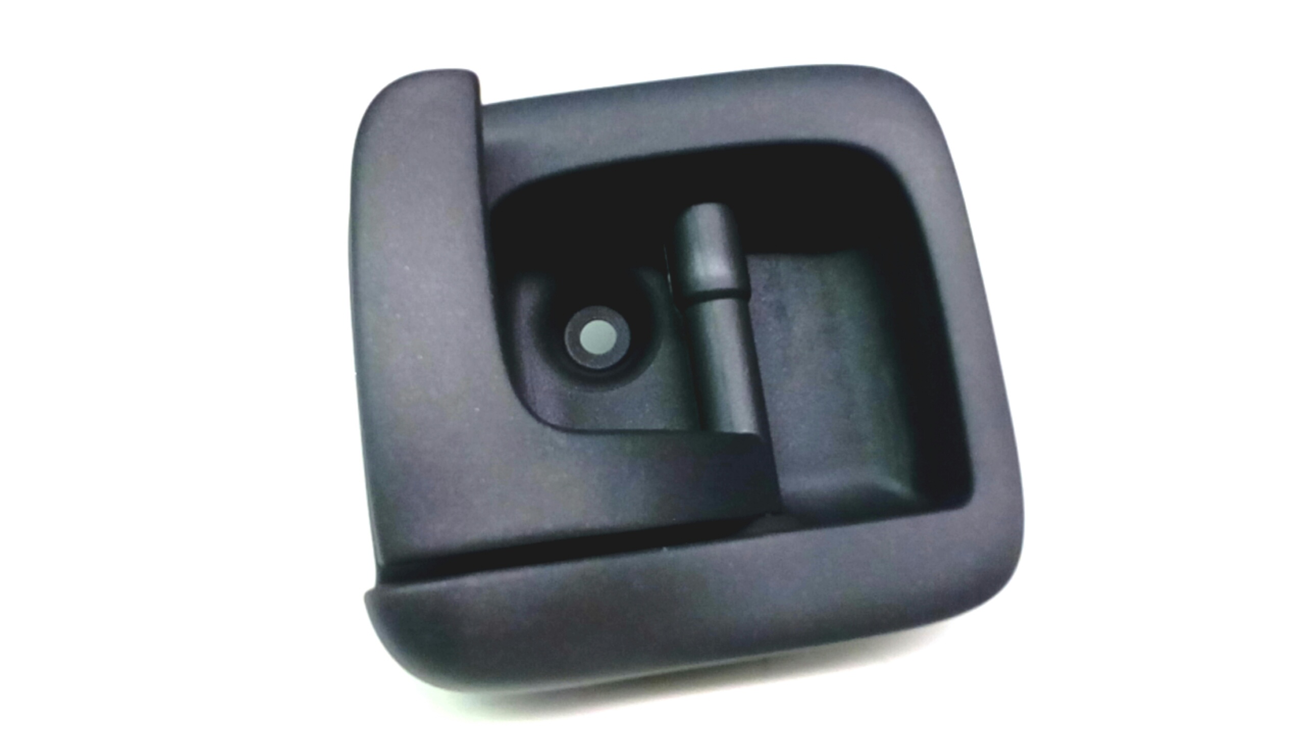

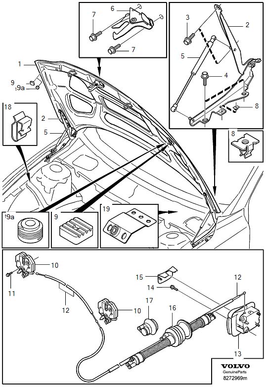

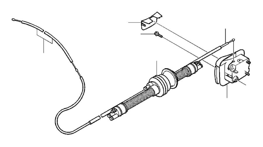

Here are the bits -
Cable runs through a rubber plug in this "grommet" assembly. I see a ball end on the cable that fits in a slot in the (all?) plastic handle.

In my experience with these, the break usually happens at one of these two places.
Stiff release/cable pull (especially in winter) is a good sign the liner on yours has accumulated some accumulation. You could remove the plastic hood release handle to see what broke, but I’d be ready with both a new cable & a new (junkyard/eBay) plastic handle. Last I bought one (as a spare to be used in the exact situation you’re experiencing) they were around $36. Not hard to replace by any means but time consuming; not something to do outdoors on a cold day.

I forgot to mention, I would probably refrain from trying to get your hood latched closed all the way…at least until you can verify that you can still open it. One time when I had this happen the ball end had snapped off the wire rope. You can’t see this until after you’ve removed the plastic hood release handle though. In my situation, I could still grab onto the end of the wire rope with a vice grips so I figured I was ok to close the hood, at least for a few times until my new cable arrived. The wire rope does disintegrate pretty quickly once the ball snaps off, so be aware of that! Once it’s gone, you you can trim back the liner to access more wire rope if need be.

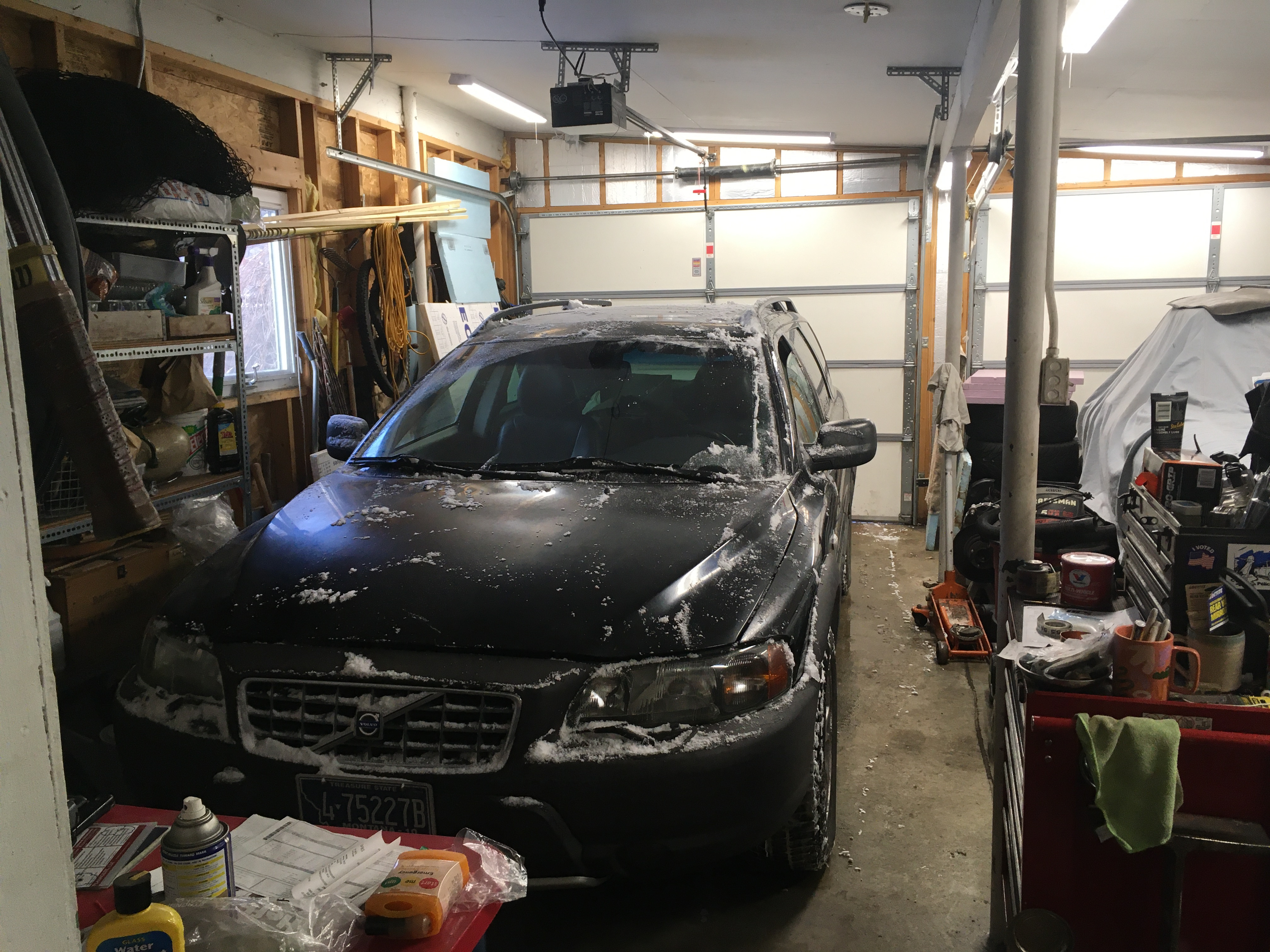

They promised high 20’s (F) but it only got to 16. Oh well. Got some heat in the garage and footwell and took a look. The handle is not broken, and the cable still feeds out the back of the handle. Mrs helper verified there was movement at both latches when I pulled the handle wide open.
Both latches have frozen dry white gunk, which I think is a PO’s grease. Did some scraping on the sides of the hooks, and sprayed some brake cleaner. Massaged the hooks with a screwdriver.
The hood shuts, latches, and comes back open with the handle! Handle seems less stiff as well. How far up the cable sheath are you really getting any lube spray from the ends?
vtl says no lube, cn90 says he adds silicone spray....any consensus?
