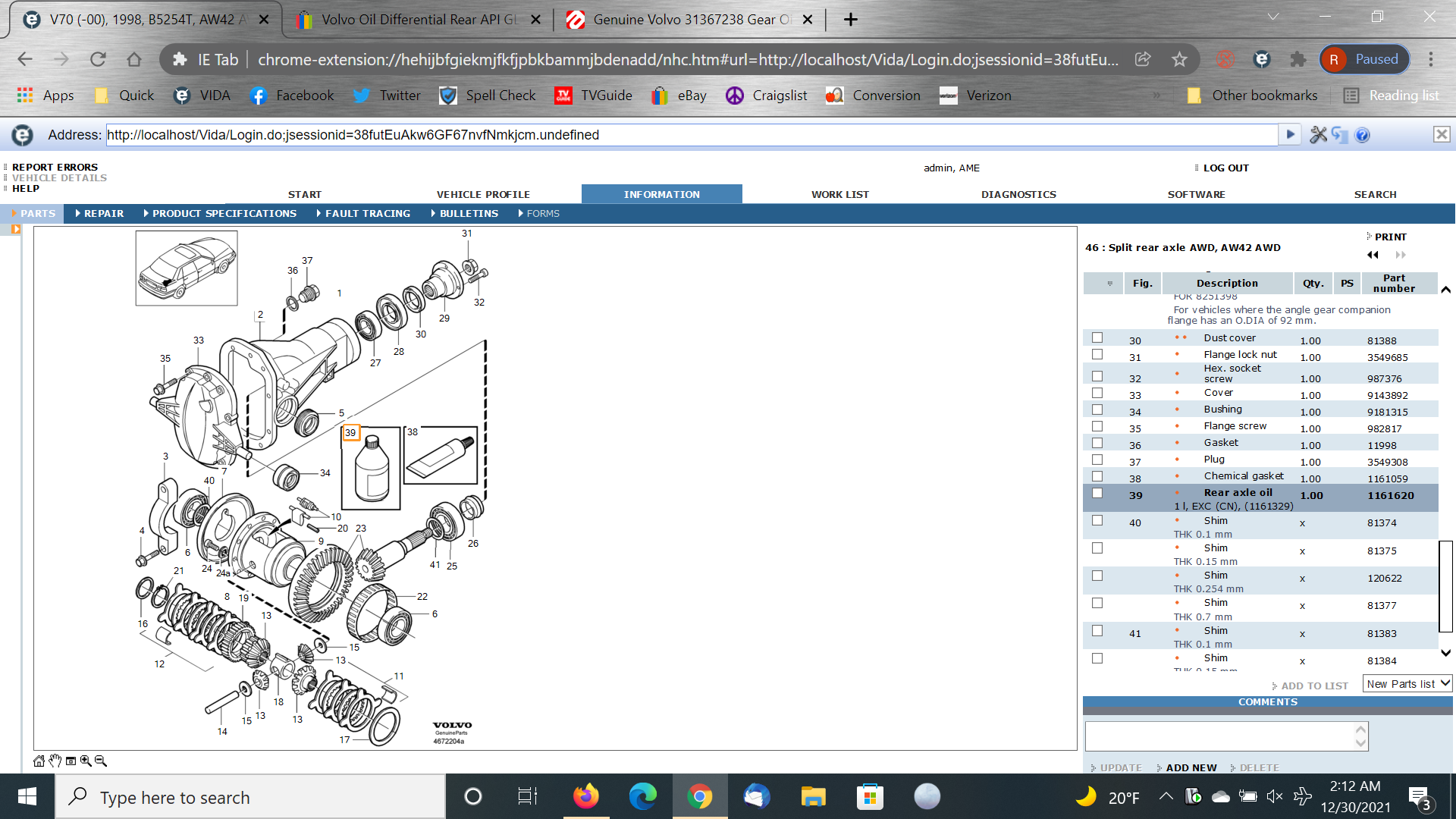

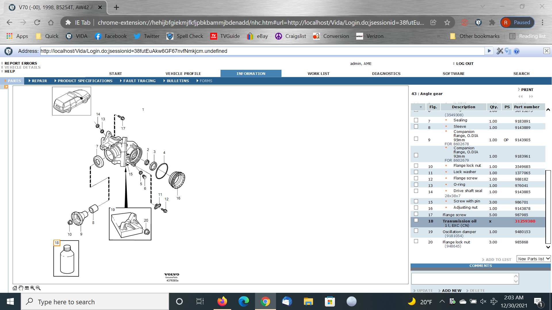

The rear differential grease is API GL-5 / SAE 80 W. Volvo part number 1161620.
The API GL-5 / SAE 75W-90 for the angle gear will do just fine. Volvo part number 31259380 or equivalent.

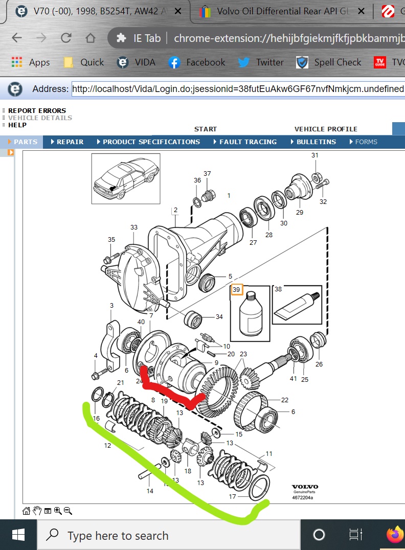

OK - back on track. Here's what bugs me. rickhaleparker showed above the exploded diagrams (very helpful!).
The rear diff has what is quite clearly a GM style "Posi-Trac" limited slip clutch unit built into the differential.
I did not know that was there. I've never seen these spec'd (elsewhere) w/o having to have friction modifier added to the gear oil to keep the friction right between the slip discs. Does the OE Volvo fluid include that, or should it be added if you are using non Volvo fluid like the OP is asking? Is that diagram right and there is a posi-trac LSD in the rear of all these cars? From the way the car behaves, I would say it's true - but I know what these units need fluid wise and that is not what I've seen recommended.

The part I marked from the diagram above in red is a Pos-Trac LSD differential (that is what caught my eye). The parts I marked in light green are the clutches that go inside it.YV1LW wrote: 01 Jan 2022, 16:39
What is the construction of the rear drive differential? Is it a limited slip differential? I don't have enough experience looking at the printout to know the difference.

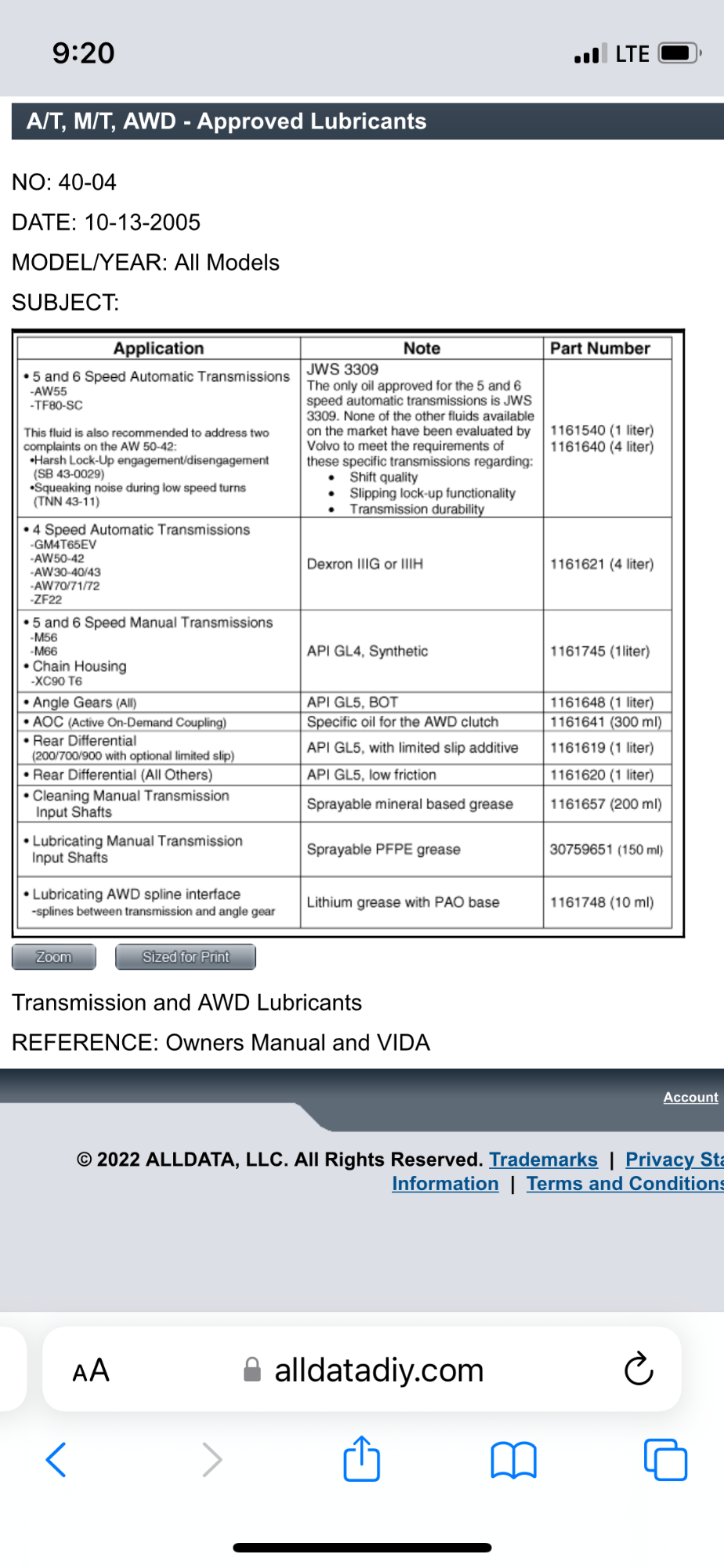

Well, some more intrigue as I bring Kat , the 1999 s70 AWD to stage zero
Volvo calls for two different part numbers for the
Rear diff oil GL5
Angle gear oil GL5 BOT328
BOT 328 turns out to be a low foaming spec , which makes a bit of sense as the angle gear case is spinning 4x faster than the big parts of the rear differential
I’m going to use different oils In each per Volvo
Rear diff oil GL5
