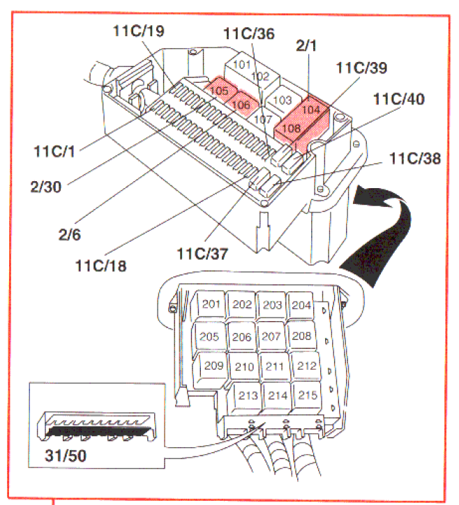

They switch in and out with the overload relay ( 2/30 ).
The relay is is witched with line X of the Ignition Key Switch ( POS I ).
? Hook up meter, turn to POS I or POS II, wait then crank ?
Or you could jumper 2/30 when you want to do the test.

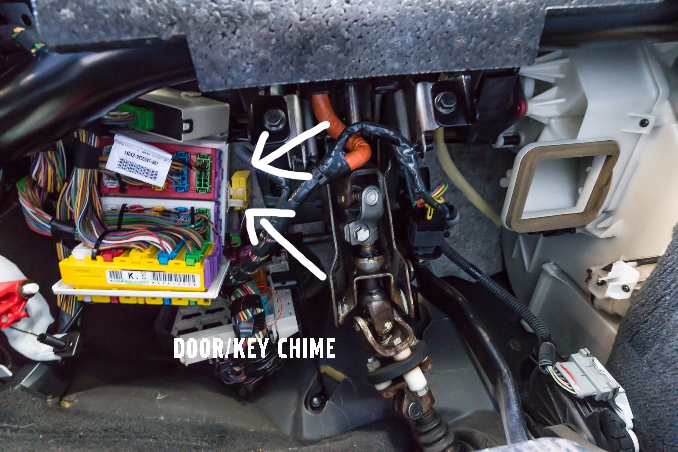

Accessory connector!
How come no one ever remembers the accessory connector?
Right there under the dash, little yellow 8 pin connector clipped
to the steering column just WAITING for a job like this.
It's got to have some pretty serious self-esteem issues by now...
The white arrows are pointing at it ( Ignore the Door Chime legend and it's red circle ) :
Looks like some enterprising individual even came up with a kit for
using the empty mating plug that it leaves the factory with - Sweet!
https://www.ebay.com/itm/254614458625?chn=ps

Pin 1 on the unused accessory connector under
the dash ( see picture a few posts back ) runs
through two fuses to the battery. No switches,
no relays, showing battery voltage at all times.
One might even describe it as Hot At All Times.
If you want to monitor your battery voltage
24/7/365, you couldn't ask for a better place.
If you’d like a relatively pain free way to mate
with that connector, buy the kit off of ebay.
