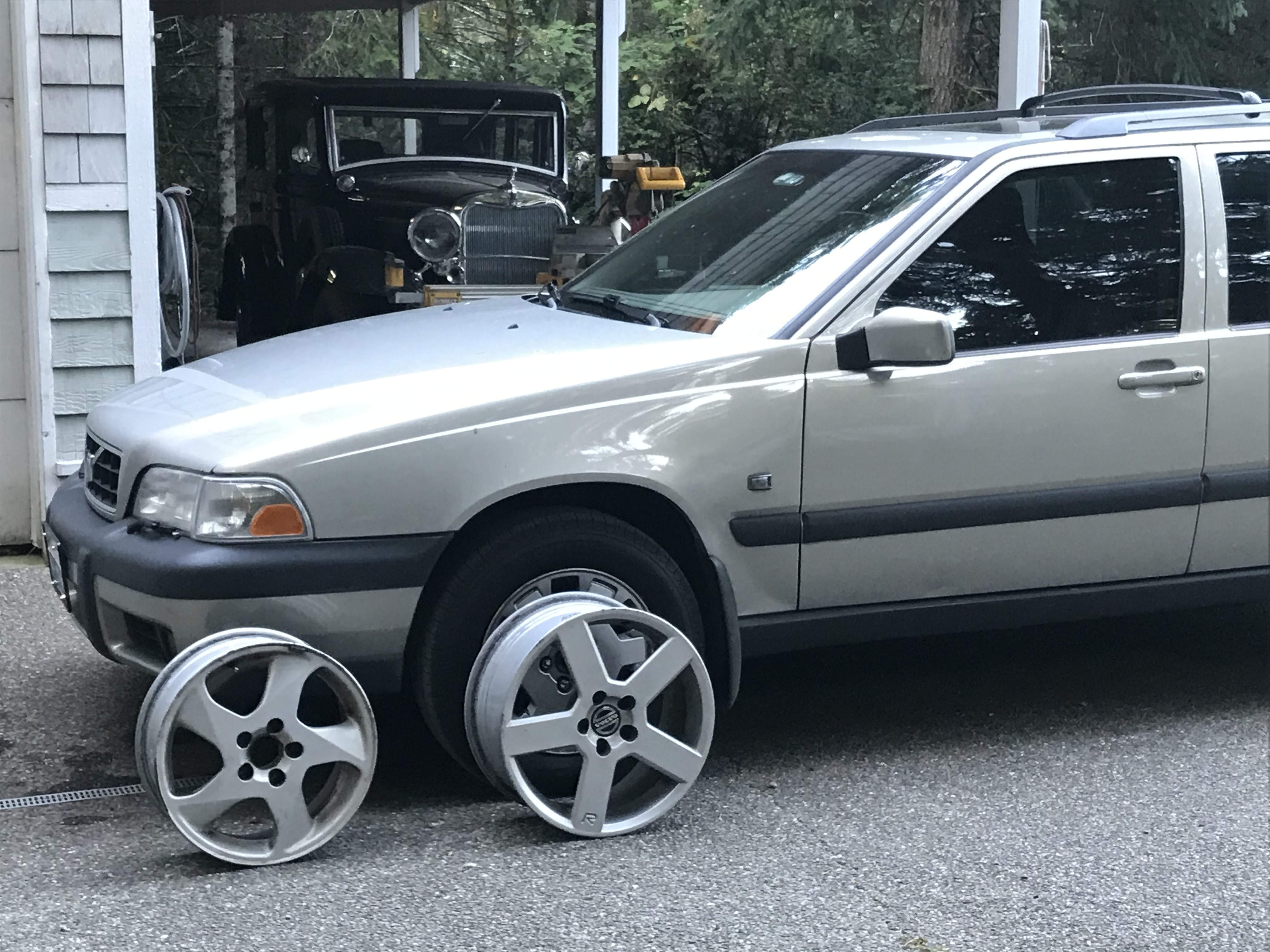

Congrats and enjoy. The P80 is really fun, but it does have some parts that, as you said, just "time out." I bought a really clean, (relatively, 117k) low-mile PNW car about a year ago. I've still had to fix about every possibly thing that afflicts these cars regardless of care and mileage; it does seem to be more age with these than some other makes. The P2 Volvo fixed a lot of this stuff but the P80 should be viewed more as 'BMW needy' than "Volvo reliable" IMO. But none of it is really heinous.
Here's my 'build thread' elsewhere. Not to promote but it may have helpful things. I still have a few things to scratch off the list but now that I've had the car a year (only put 2k miles on it though), I am beginning to like it and not missing other newer cars at all - which says a lot. if you are a DIY guy you will have a ball (and i am guessing "454cid" implies that!). You need to not plan on making it a dd car until you've had time to mess with it, find all the problems, lay it up a few days at a time, etc. I guess you know that.
My car is now my dd car, but for nine months it was not fun as I always found something to fix, improve, or refinish. Now that it is almost done, I'm really pleased with it and this month I'm dropping in a bigger intake, turbo, and getting a ecu tune. These cars handle well. If you are from the old school - meaning you got your driver's license before say 2005 - and had to learn to make car handle instead of just relying upon HP - these are fantastic. OK, I'm assuming you got a turbo...
https://www.swedespeed.com/threads/117k ... nd.639665/
No 454 in the background, but this '32 Dodge adds some credibility chops I hope.
