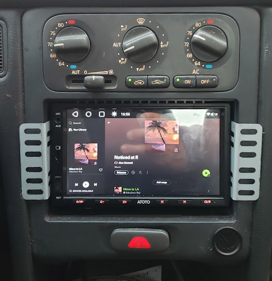

But I don't really like it's mounting system. Here's a crappy picture of how it wants to be mounted:
Note the two brackets. That works, and holds it tightly in place just with friction (meaning no need to screw into the dash), but those brackets are pretty heinous. I plan to paint them, possibly with Plasti-Dip, but I'd rather not have the visible brackets to begin with.
I was thinking of attempting to shim the stereo in there on the left and right, but it's a touchscreen so would be hard to get it tight enough to resist movement when pecked.
I was also semi contemplating removing the panel so I can install it from the rear of the stereo, does that panel remove somewhat easily?
Or any other ideas for how to mount an aftermarket double-DIN stereo?
And on a sidenote, I'm working on a faceplate built from the carcass of my old sc-815 to keep the crackheads off my new stereo... It's currently held in place with tape (soon to be replaced by magnets), but if I ditch the brackets it fits in the opening perfectly.
Any clever ideas for mounting a new double-DIN stereo?

> Did the new HU not arrive with a mounting sleeve and a trim ring?
It came with a tiny trim ring (if that's what this was, just a thin rectangular bracket). But now that I look at other installs I'm obviously doing something wrong, since no one else has those brackets outside the stereo pocket. Hmm.
This video shows removing the trim to install the stereo. Is that possible / relatively easy with an S70?

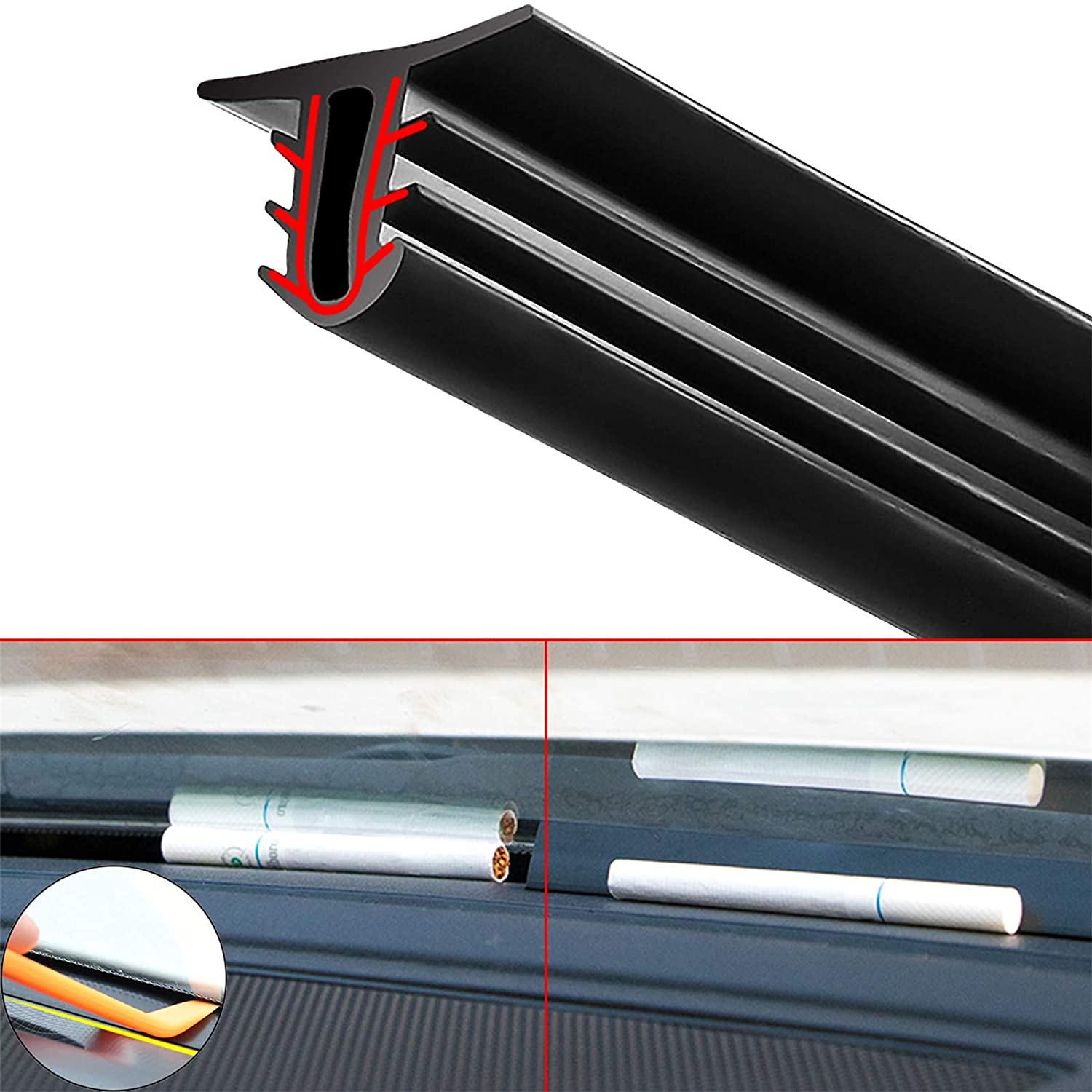

Hard to tell from the picture how you intend to finally have it sit in the opening. If inset and you can have it stabilized through the back then just look for something flexible like this with a different design / angle that would cover the gap / opening. Not perfect by any means but can buy you some time while you come up with something better.
I like it aimed up a little, making it a bit easier to see since the S70's stereo position is pretty low for a touchscreen. So not flush mounted. Another reason I'd like it inset a bit is to allow room for the fake cassette faceplate for when I"m parked in the city.

Put a plate down to rest the unit on top then create stops so you can push it back to as far as you want that to go. Next just use the suggested trim to wedge the sides to keep it stable. Still need to bolt it down for safety God forbid if you are in an accident and it gets catapulted out of the dash

No, Carlo is the name of my S70. In other words it's my car who sleeps under the freeway, not me. And the homeless camps sort of come and go. I should mount a timelapse dashcam so I see all the crazy things that must happen around my car at night.
Good point about adding some rock solid anchoring in case of a crash.
And good idea about the plate.
