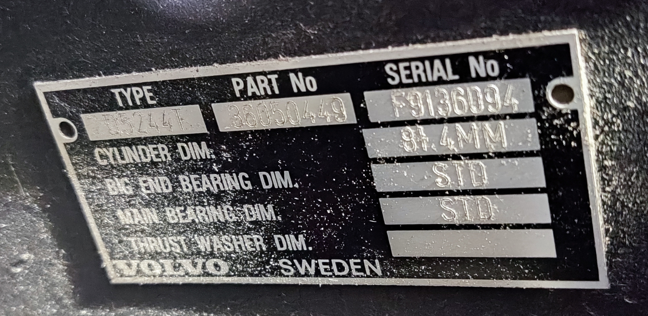

In Vida I found out, that there are two differen tensioners. Engine -> 349808 and 349808 ->
So I was looking for my engine serial, but it hat 7 digits (on the timing belt cover, and what's on the back of the engine seems to be identical. On the back of the engine I can only read the first digit's, as the remaining ones are covered by a cooler pipe...)
Maybe you can help me with this, as I don't think Volvo build 9000000+ D5-Engine's...
I assume the "F9" may stand for "Replacement Engine" or "Refurbished Engine", but I found nothing about it. Wether on google nor in Vida.

Post by sturmtiger »
Here's the update:
Skandix told me, that F9136094 is the SERIEL NO. of the Engine, but NOT the "Engine No.". :roll:
It should be on the back of the engine.
10 minutes ago I crawled in the engine bay with a torch and my phone and took a photo of what's engraved:
D5244T and the same No.: F9136094.
I guess I have to visit a dealer then. But it's hard to find a good one.
Here's an update, if ever someone will have the same problem:
Long story short: I was at another - better - Volvo dealer, who was willing to help me. He gave me the engine CONTRUCTION number (?) from my data card. Which has 6 digits and is at least in the range of the possible numbers. So I hope it's the right one for getting spare parts if needed.
He also said (combined VW and Volvo dealer), at some VW's - if they get replacement engines - the field on the new engine is empty and they have to copy the engine number from the old to the new one.
But he couldn't answer me how it's made at Volvo.
