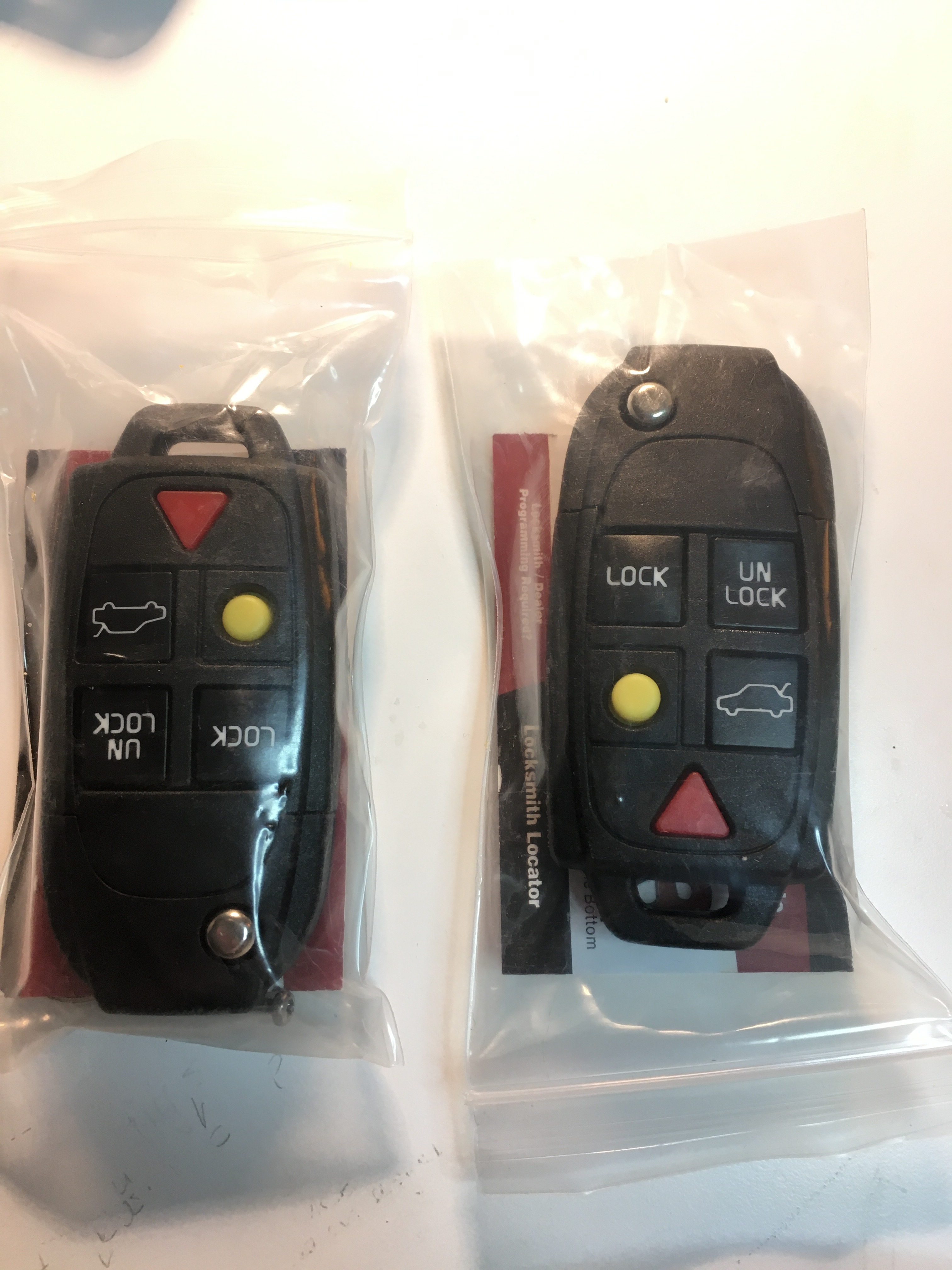

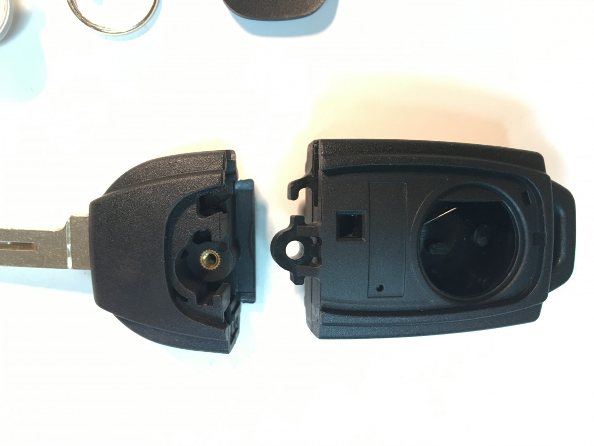

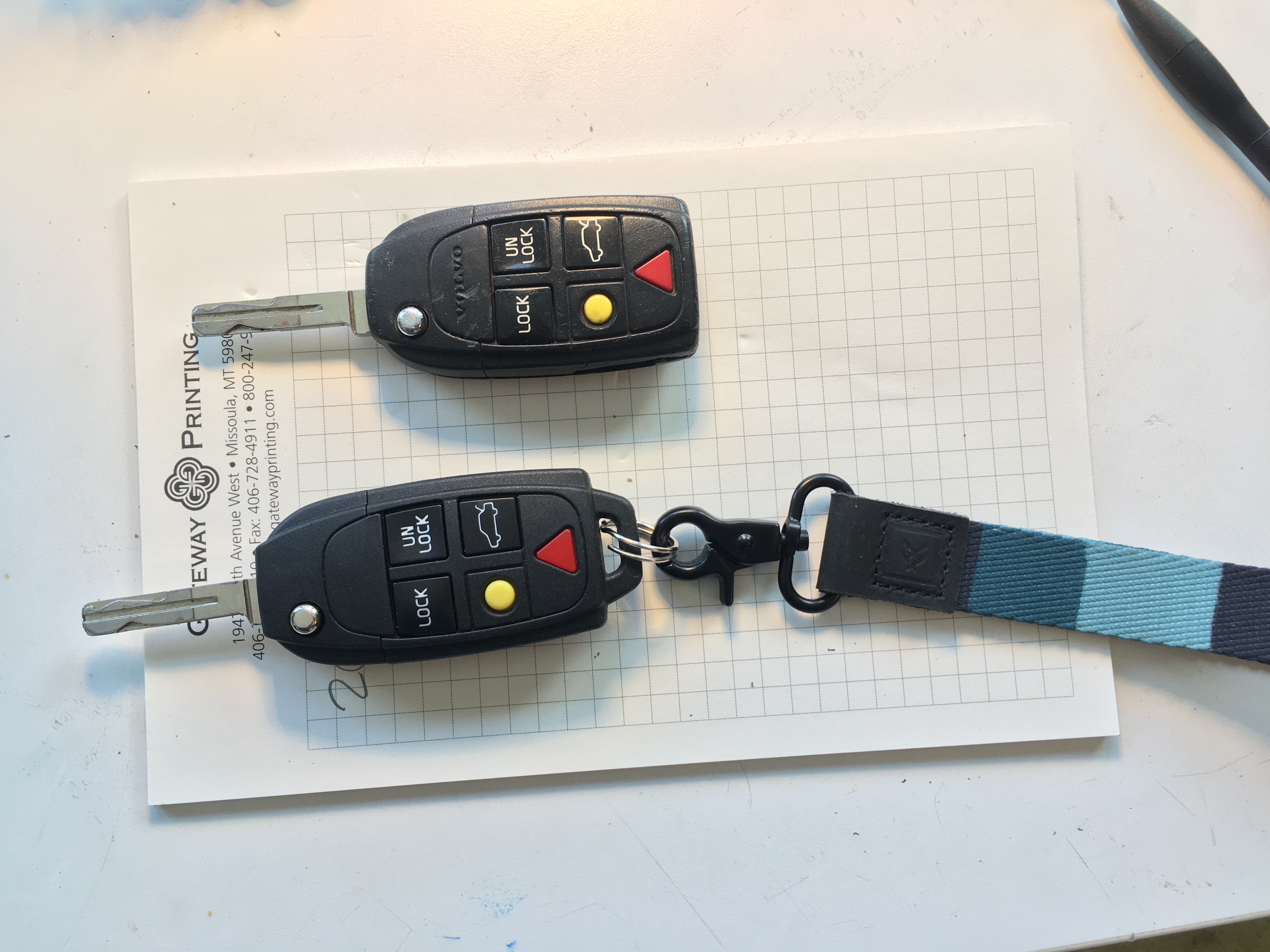

Both our keys came from the previous owner with the blades locked in the open position. They have been opened and obviously tampered with. One of them would randomly act up and set off the alarm. I read a few posts here and bought a pair of ebay empty cases for $20-something from a high rated seller. Dirt cheap, worth the experiment. I got the ones with a keychain loop since the tiny holes in ours were broken or pried open.

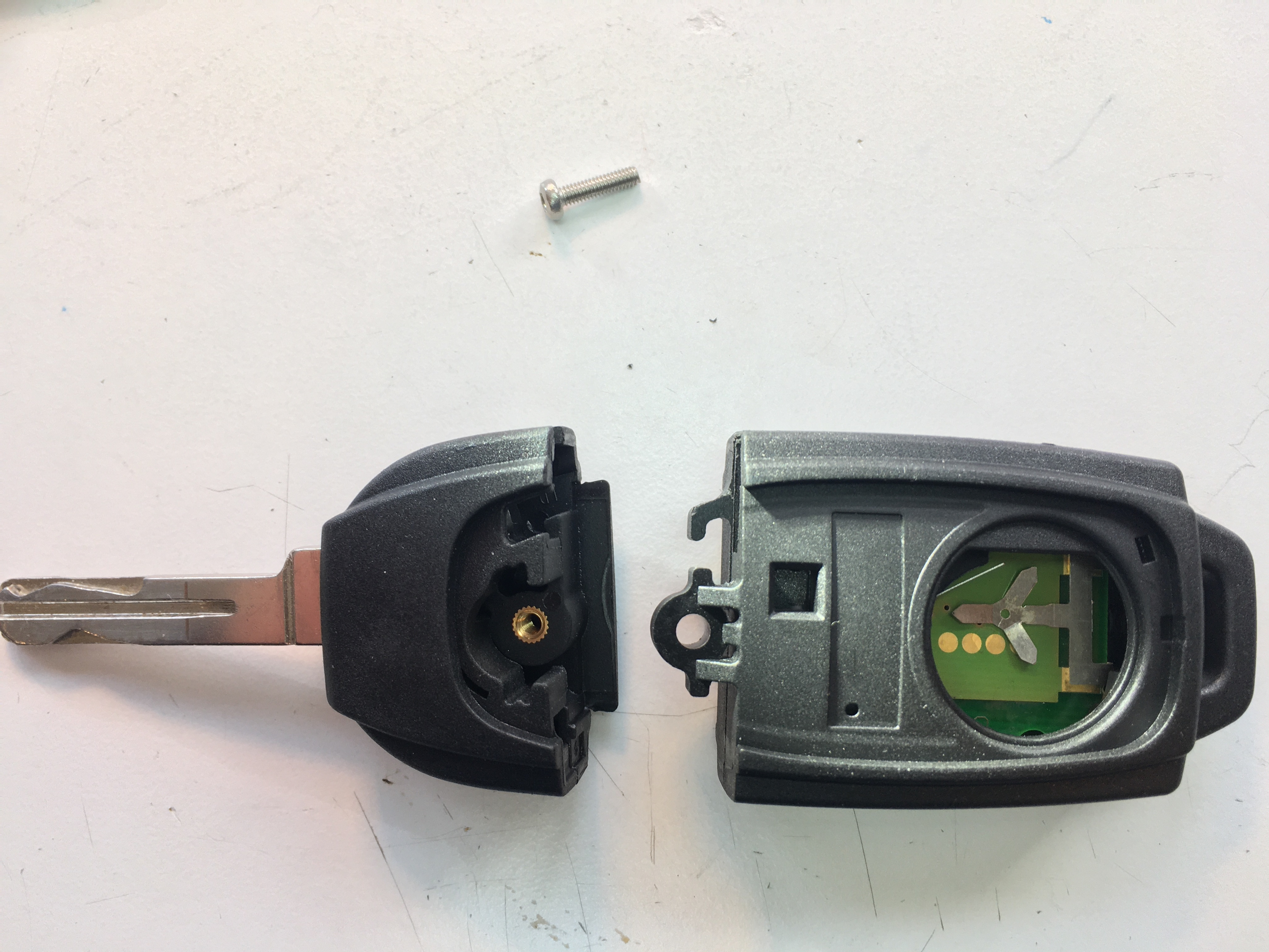

The old one. The buttons were crooked, the emergency button had slipped into the hole. The tiny torx screw was cranked in there - I used some HD hardware for such a tiny screw.
New one open -

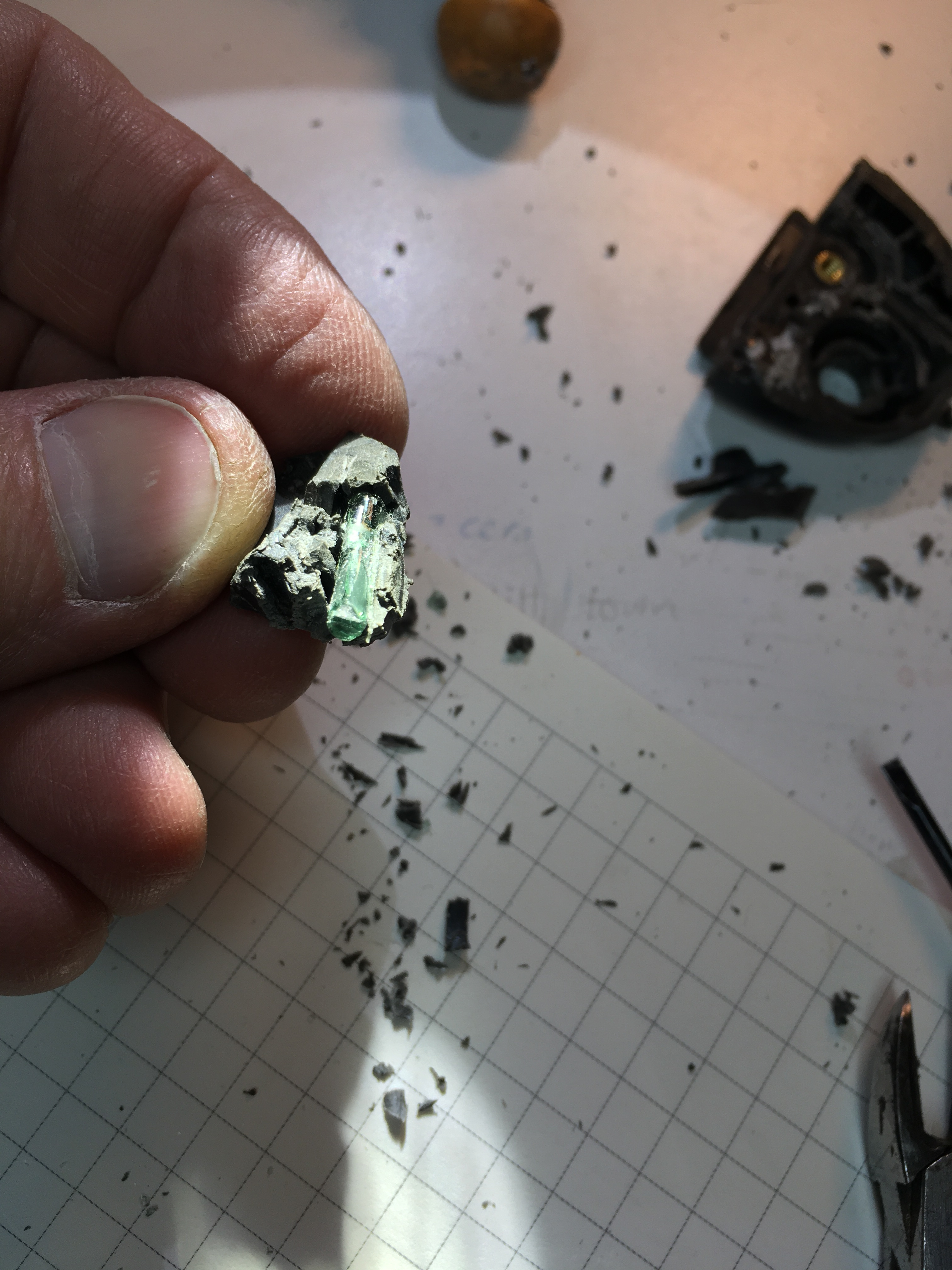

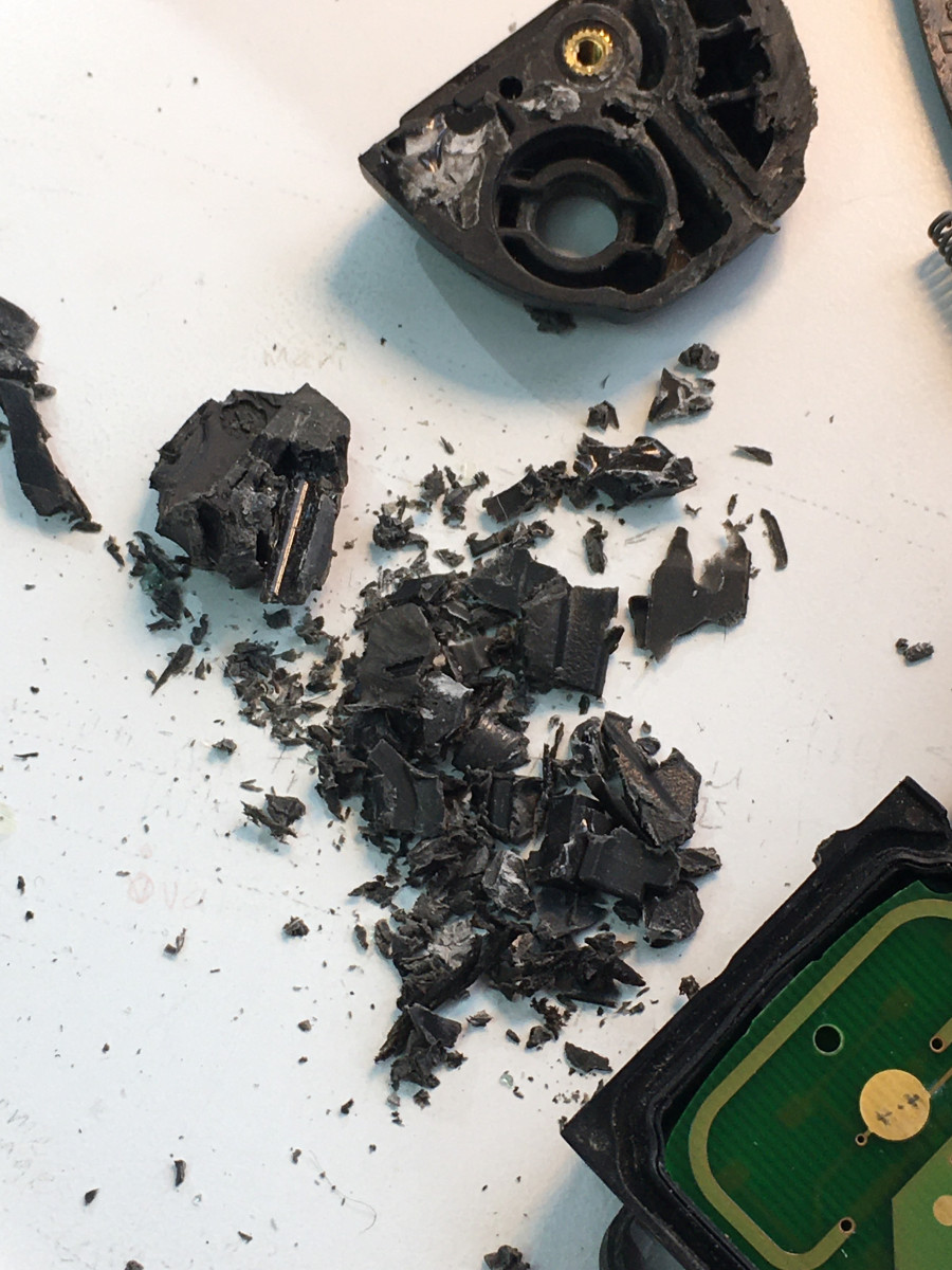

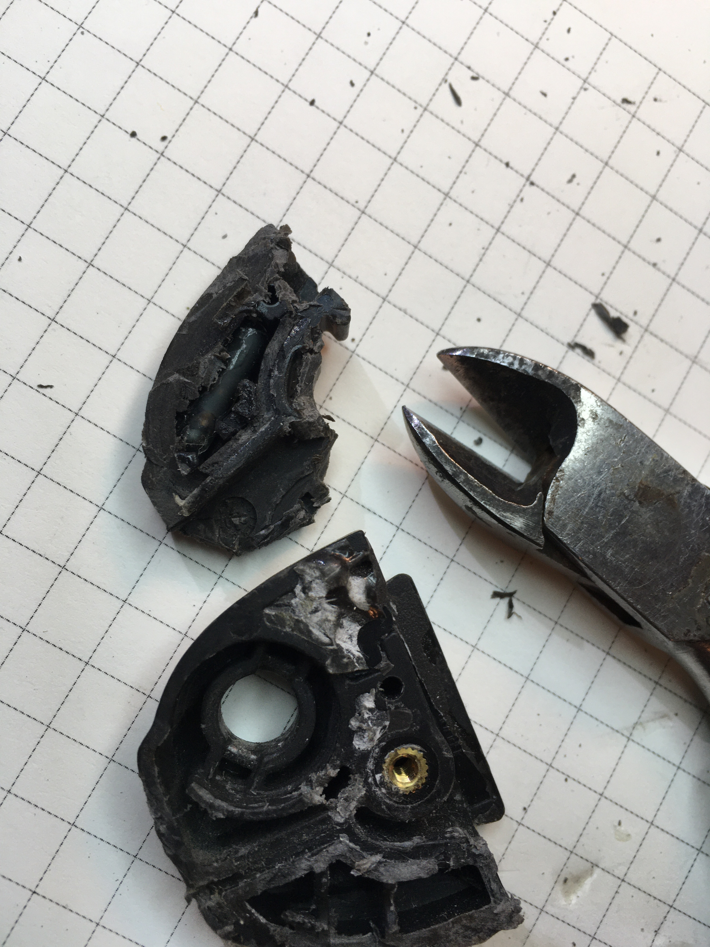

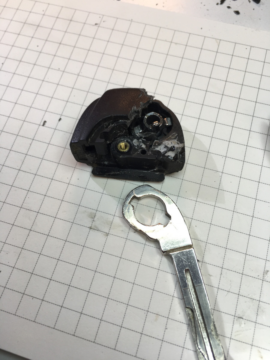

Then the trouble starts. I found that the entire upper section with the blade was filled with hard black epoxy. The PO's mechanic had filled all the voids and glued the halves together. First goal was the get the old blade out of there. It is hard plastic. There's a little glass transponder capsule somewhere in the upper piece - It's like an archeological dig in that you want to chop through the rock, but you have to make tiny progress with little tools in order to not destroy the priceless dinosaur bone in there.
OK, blade out. To this point I've used big snippers, tiny snippers, tiny screwdrivers as chisels, tiny needle nose pliers, and even a Dremel to very carefully split the halves. Two hours of slow and careful.
Ah HA! The dreaded chip / capsule / transponder!

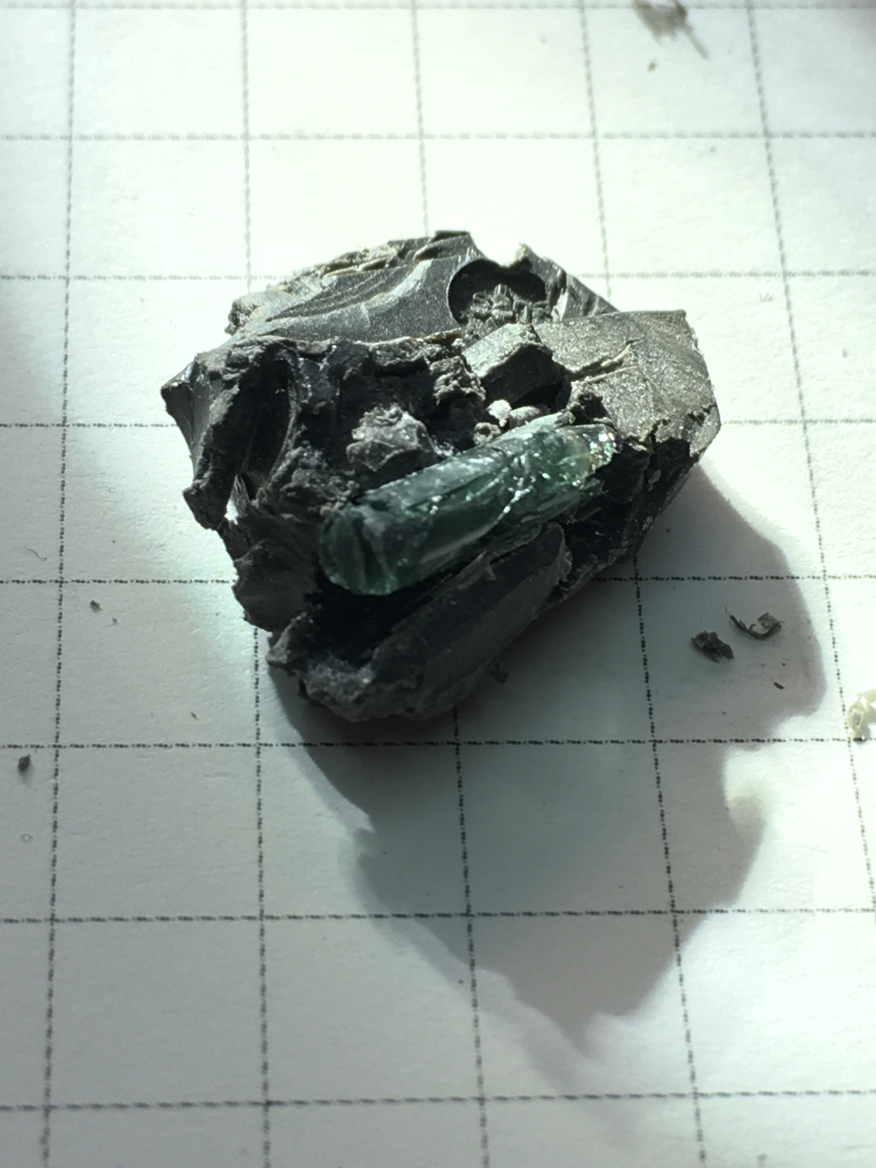

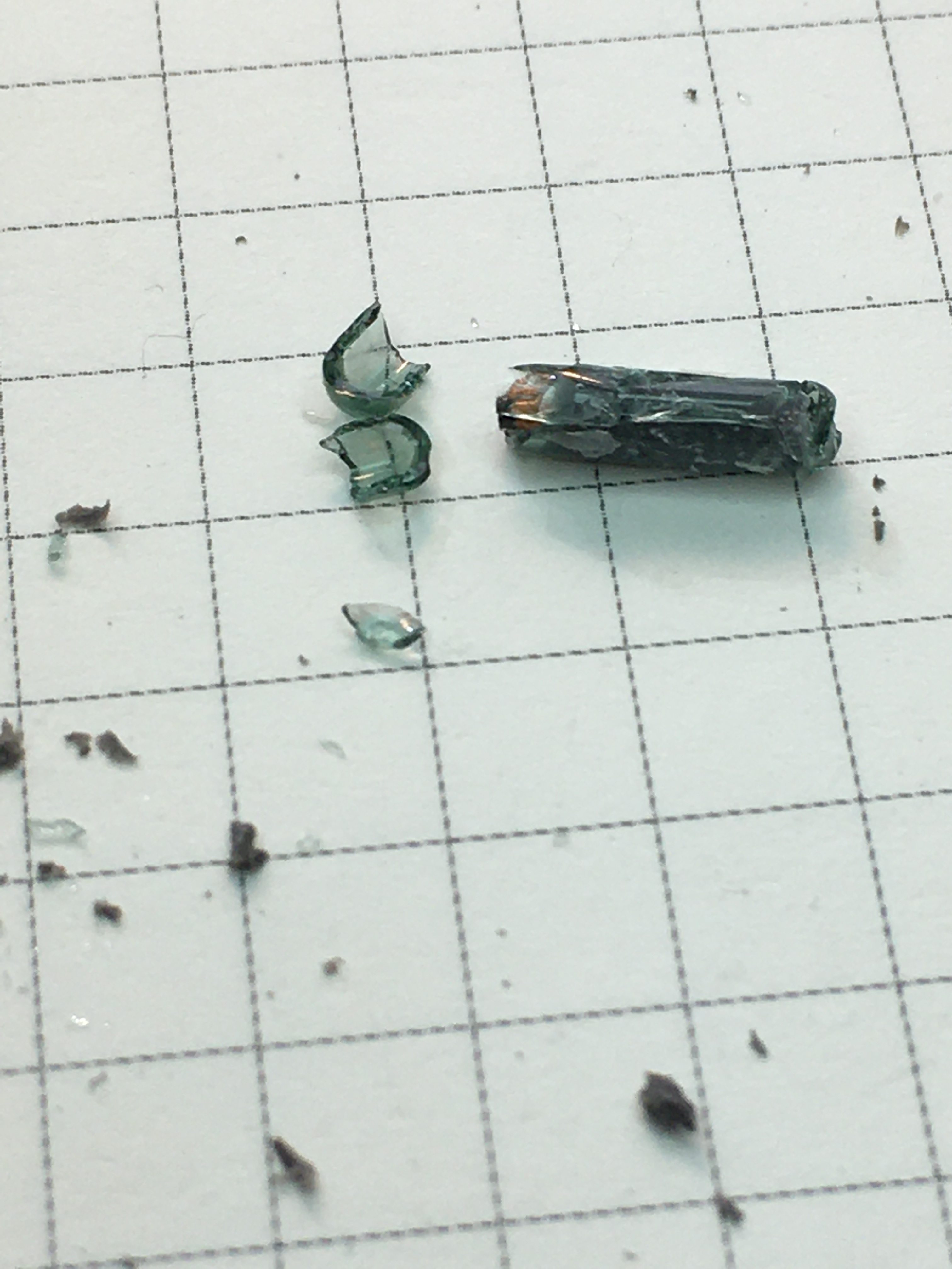

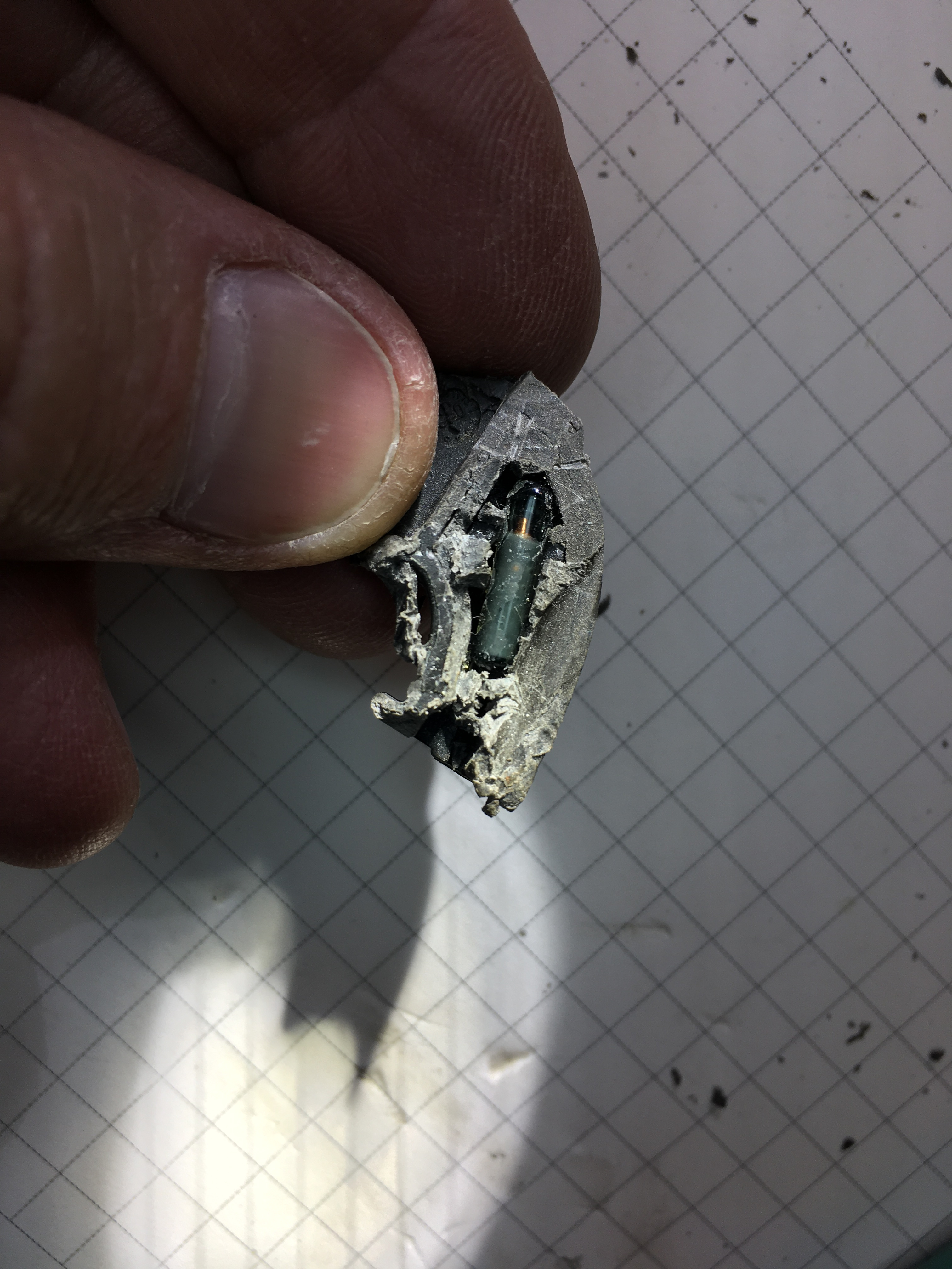

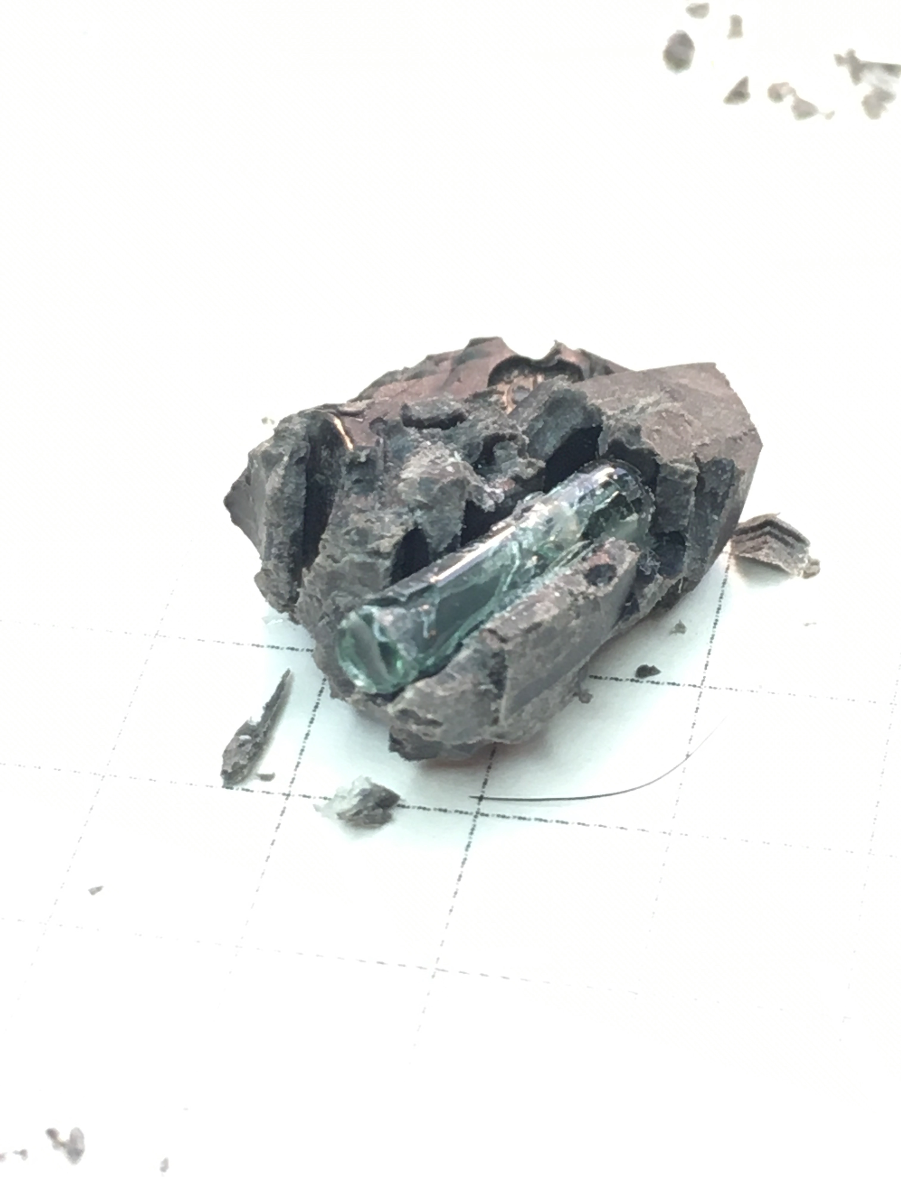

It's embedded in the plastic and epoxy. I snipped and carved with a sharp utility knife, but I did not pry.

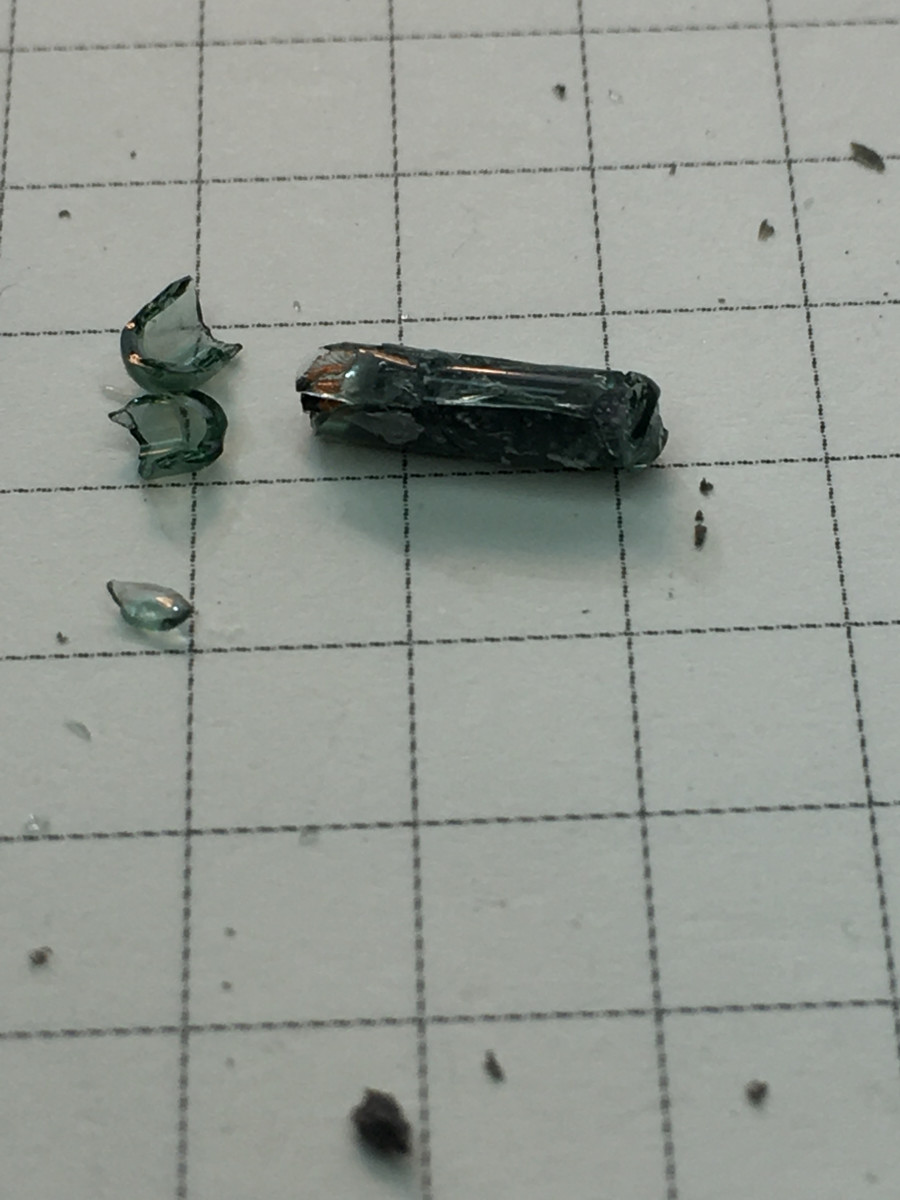

Then it's almost free, one more little snip....... ARGH, I've cracked the glass. ...
My mess is way worse than that German guys!
I got that little parallel ridge low enough, shaving with a utility knife, to loosen up the capsule.
And there it is...what a mess I've made.

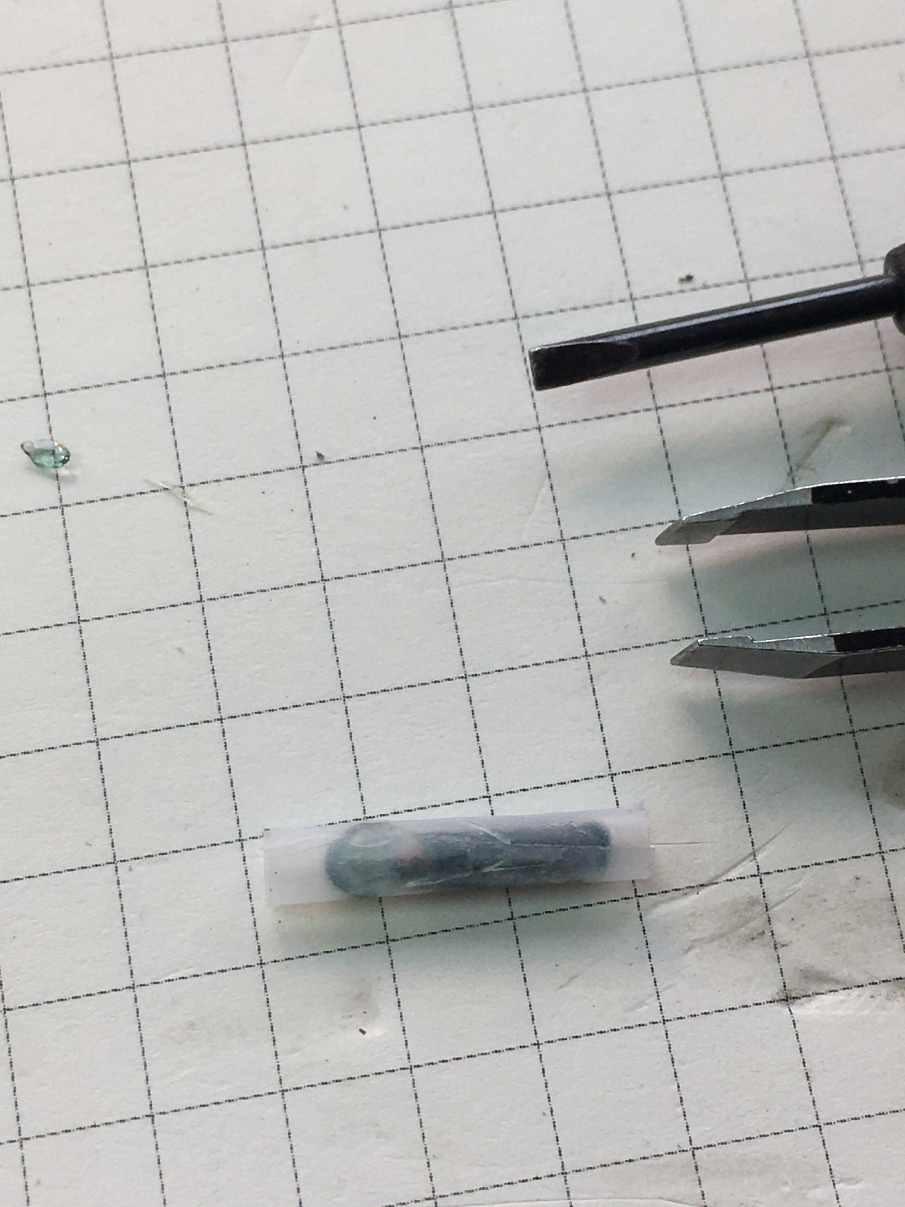

There appears to be a tiny copper coil inside. I read posts here at MVS that it isn't ruined..... yet. And someone said don't use glue, not sure why. So I gathered the little dome end pieces and set the whole thing on upside down scotch tape with a tweezers. After a lot of fiddling I managed to roll up the tape around it like a tiny burrito. No pressure, not too thick.
I pinched the ends shut and trimmed them.

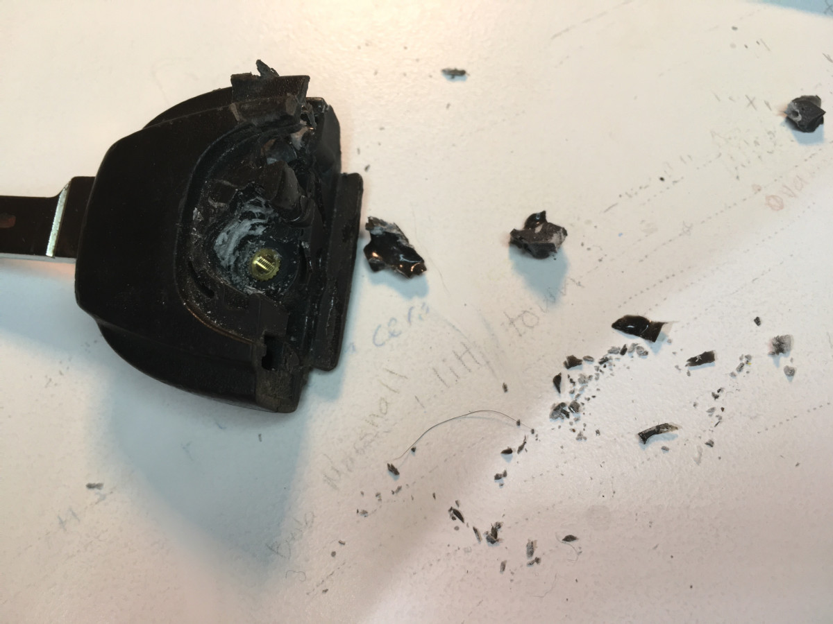

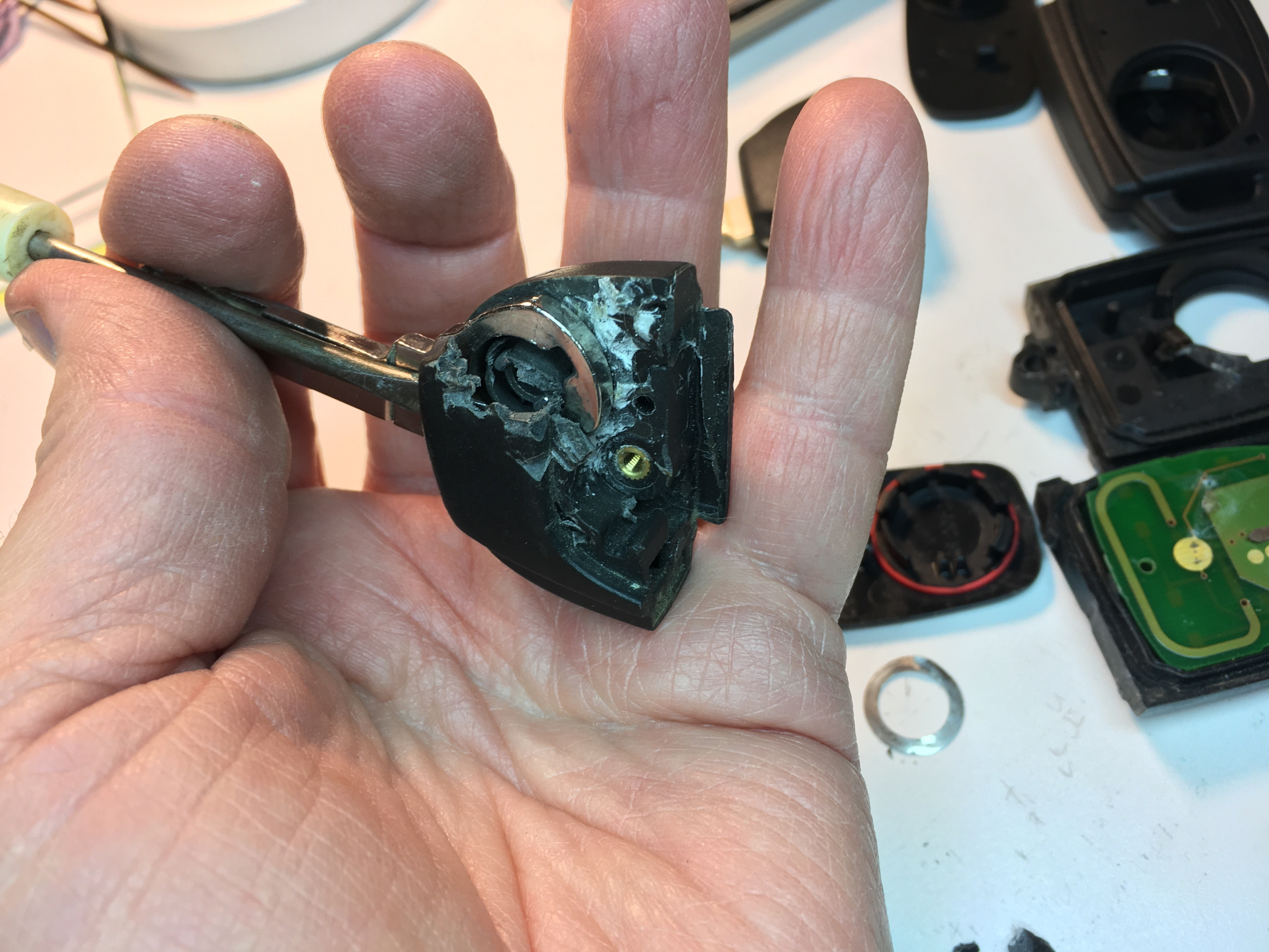

This is what was left of the upper section.....

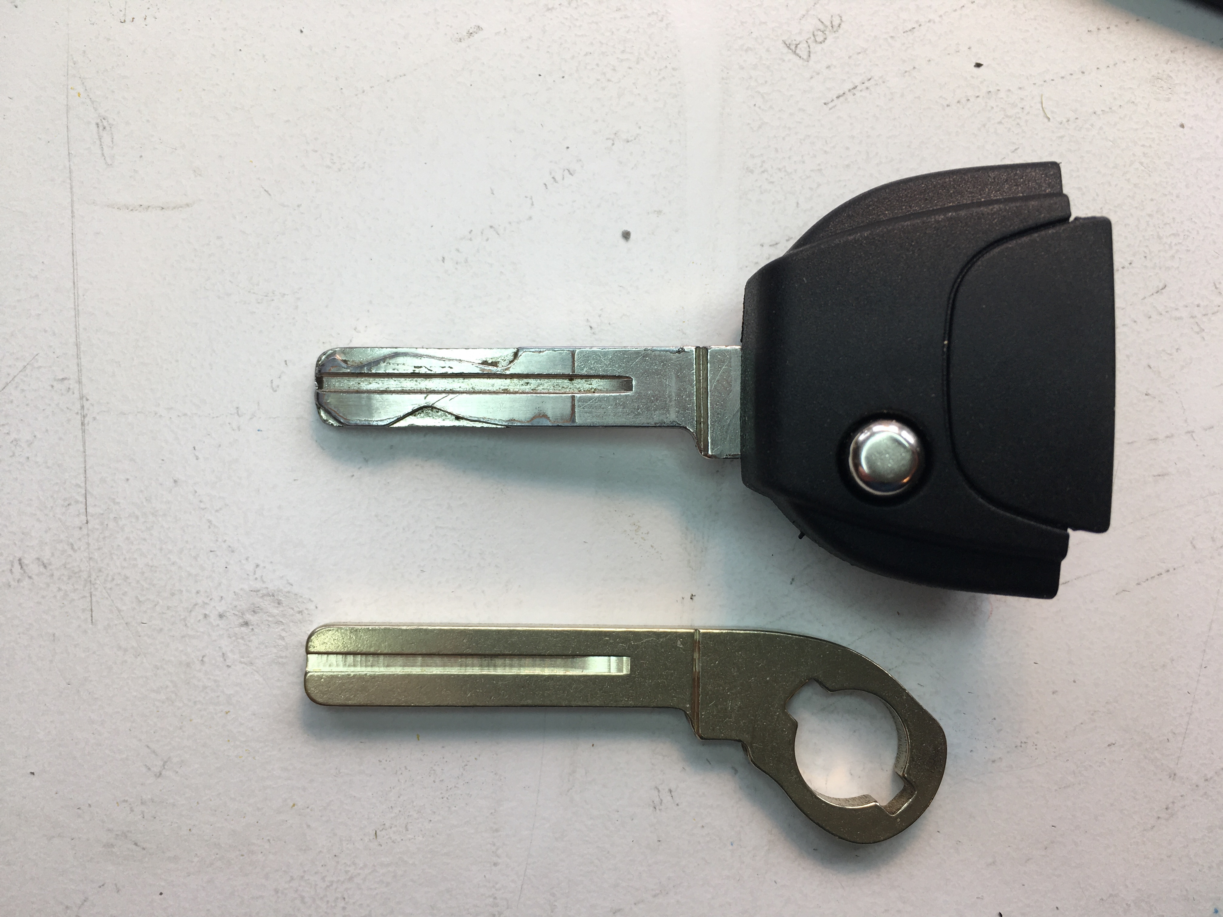

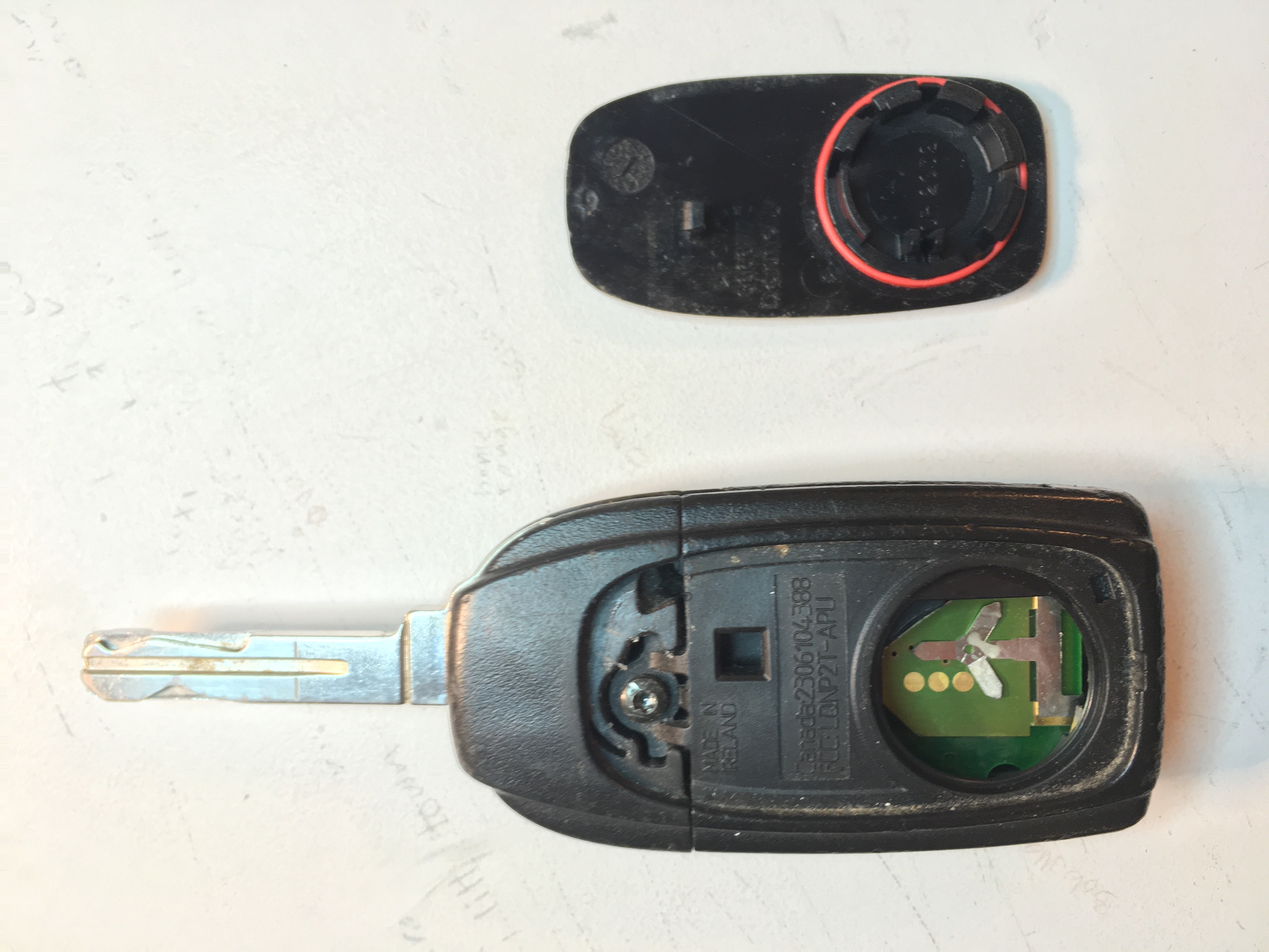

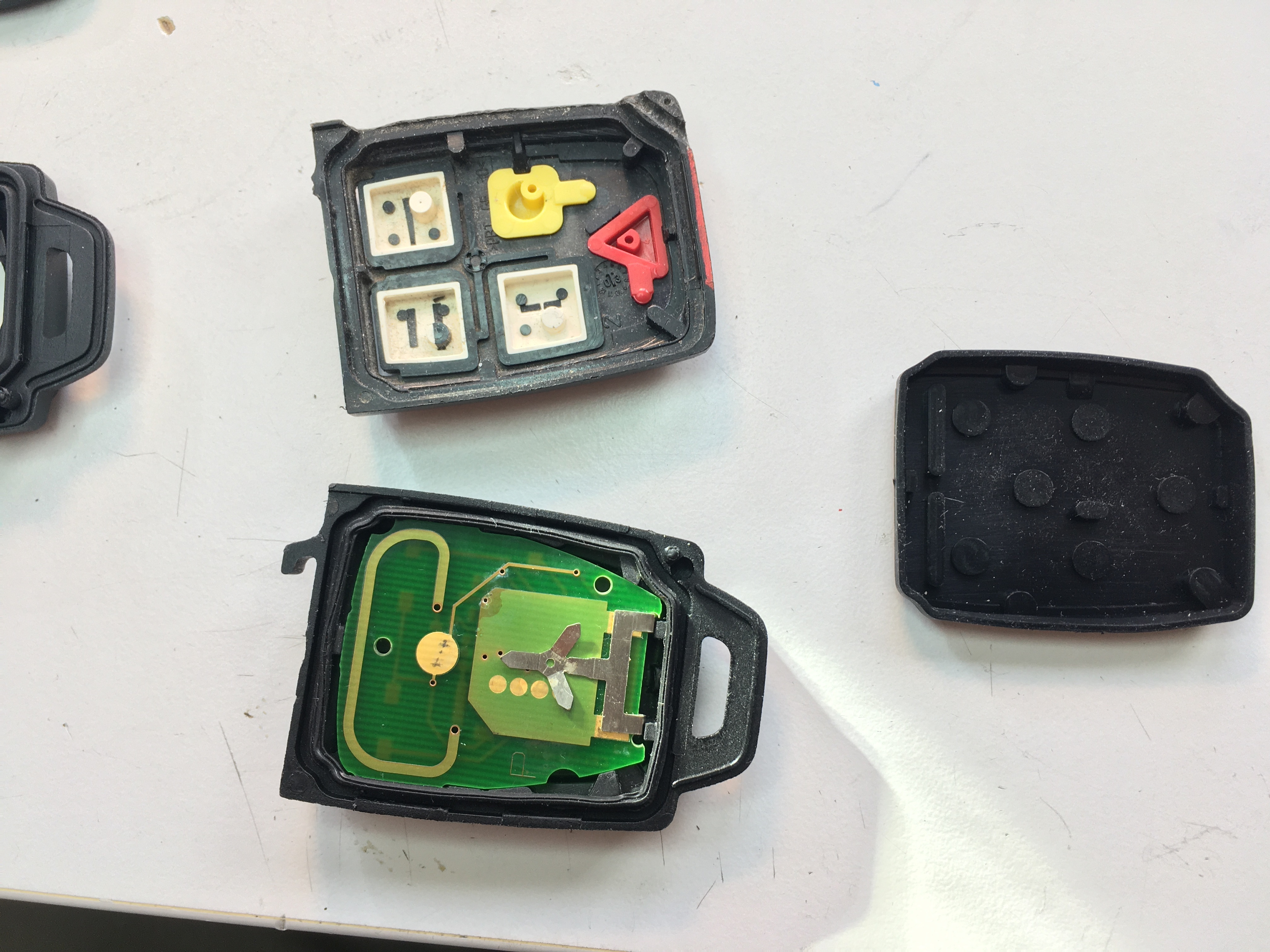

Old key blade in new case. (Forgot to put the capsule in here and it had to come apart again - at least this one is easy to take apart) You learn to fiddle a bit with fitting and twisting the spring to load the flip key, then snap the lid on over the button.
Old guts to transfer. The original rubber tray is shaped much better than the new one, so the circuit board fits. I used it.

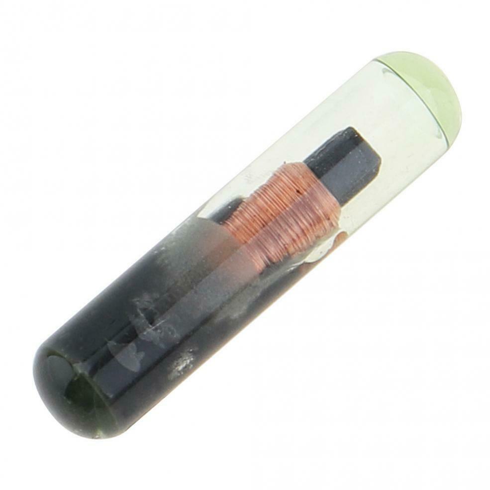

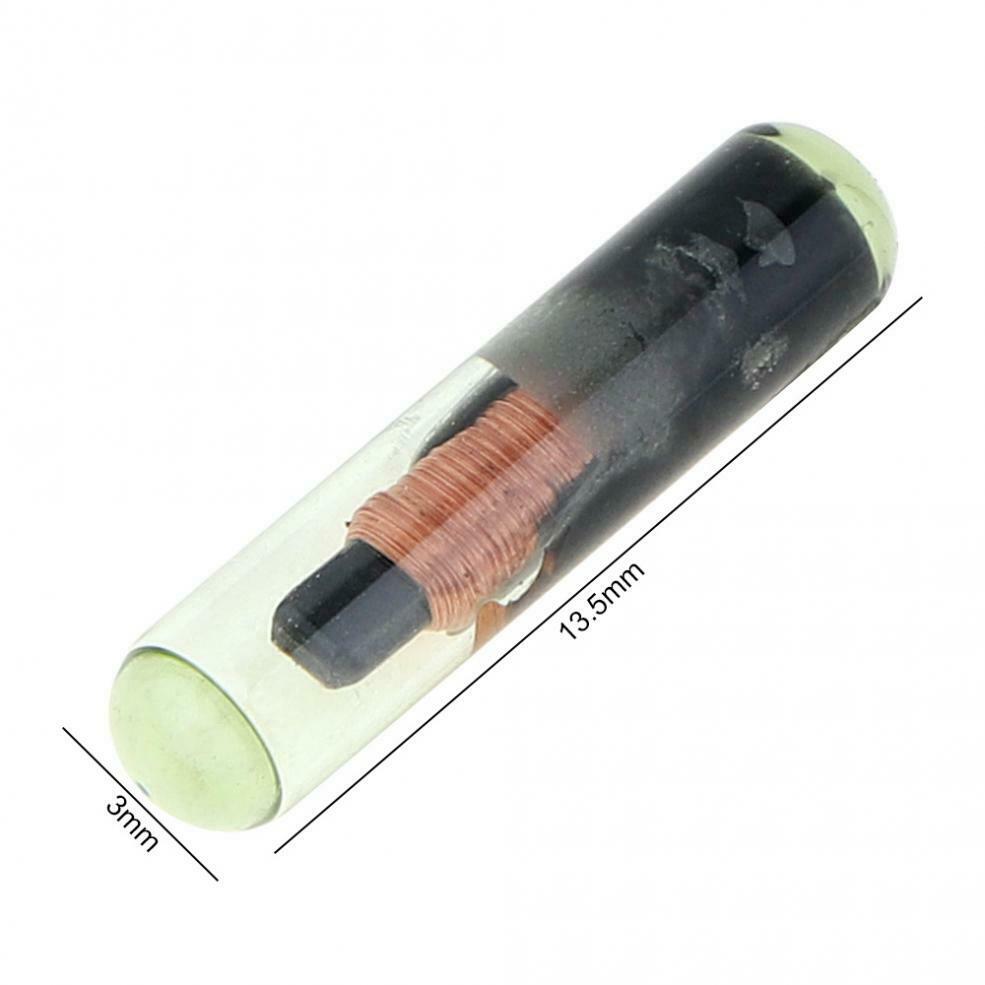

Here's a Chinese VW chip on ebay for 6 bucks. Looks very similar to ours. I see the coil and then some copper arms up the sides of the glass. Maybe one or both of these is touching the coil now.
