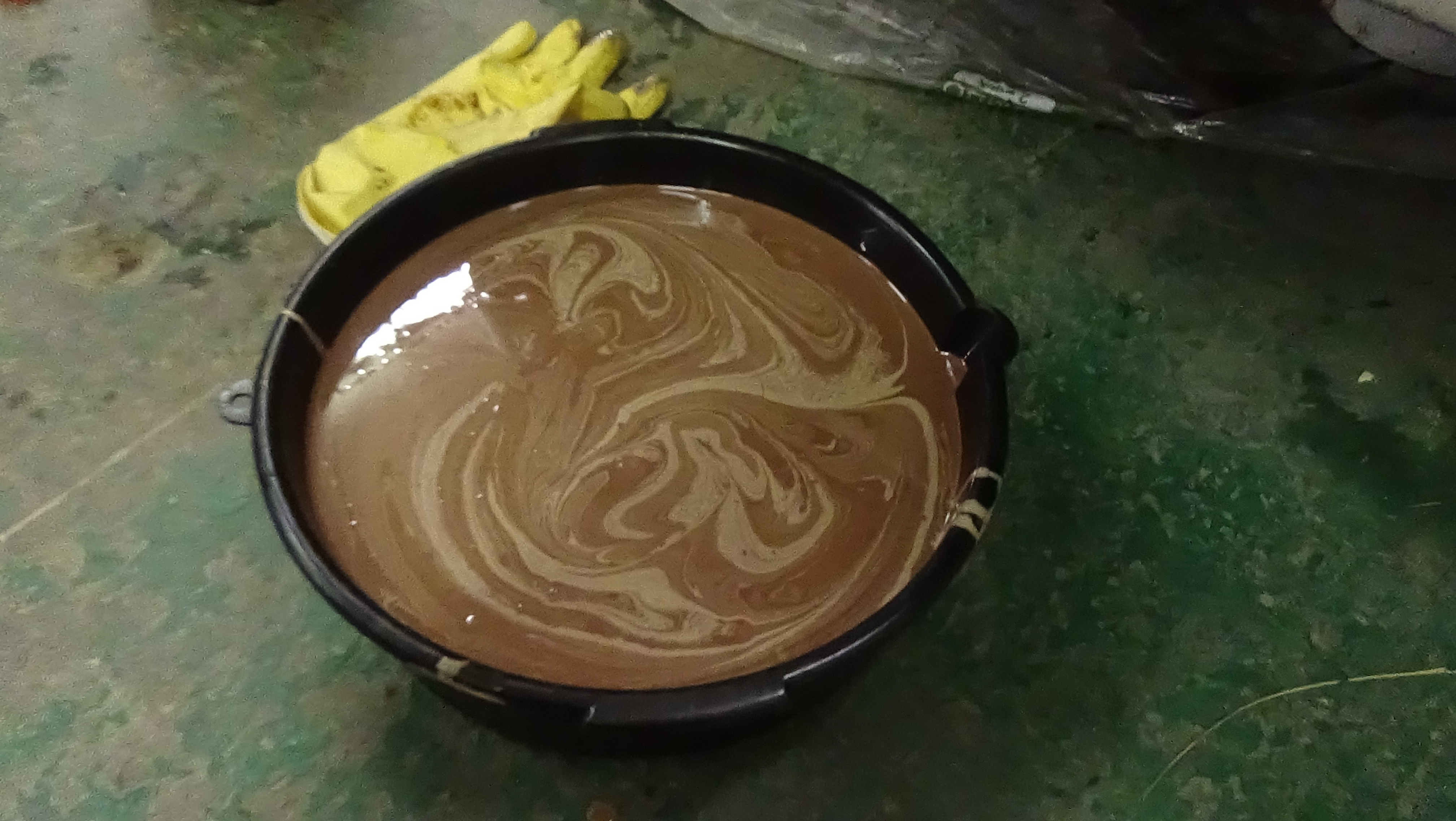

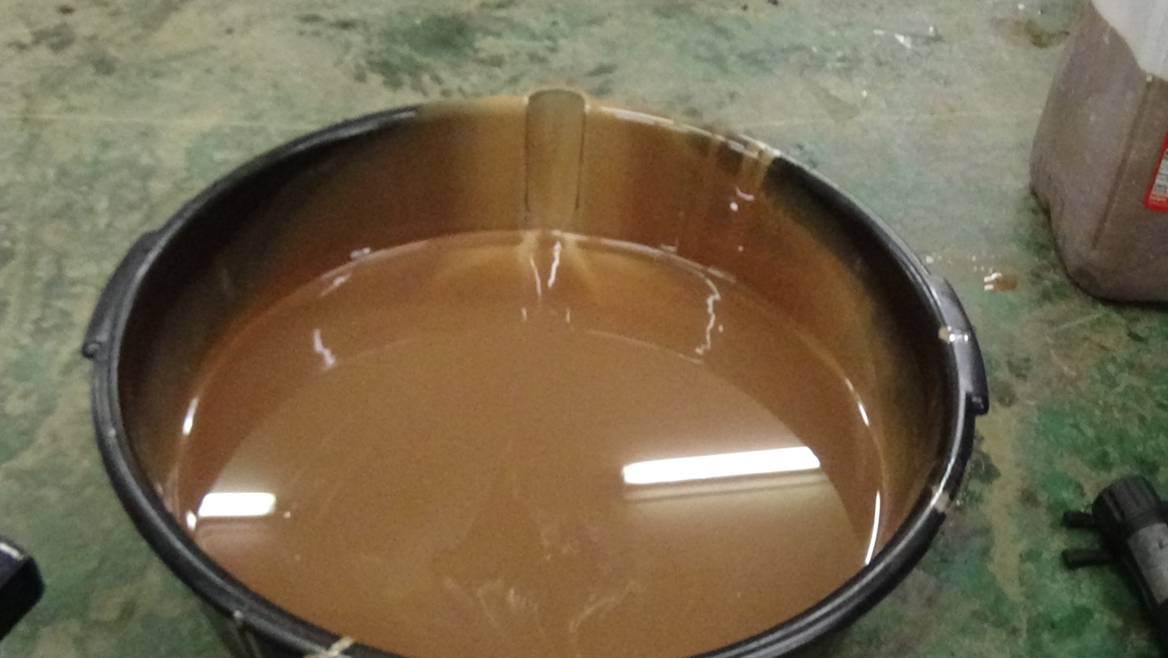

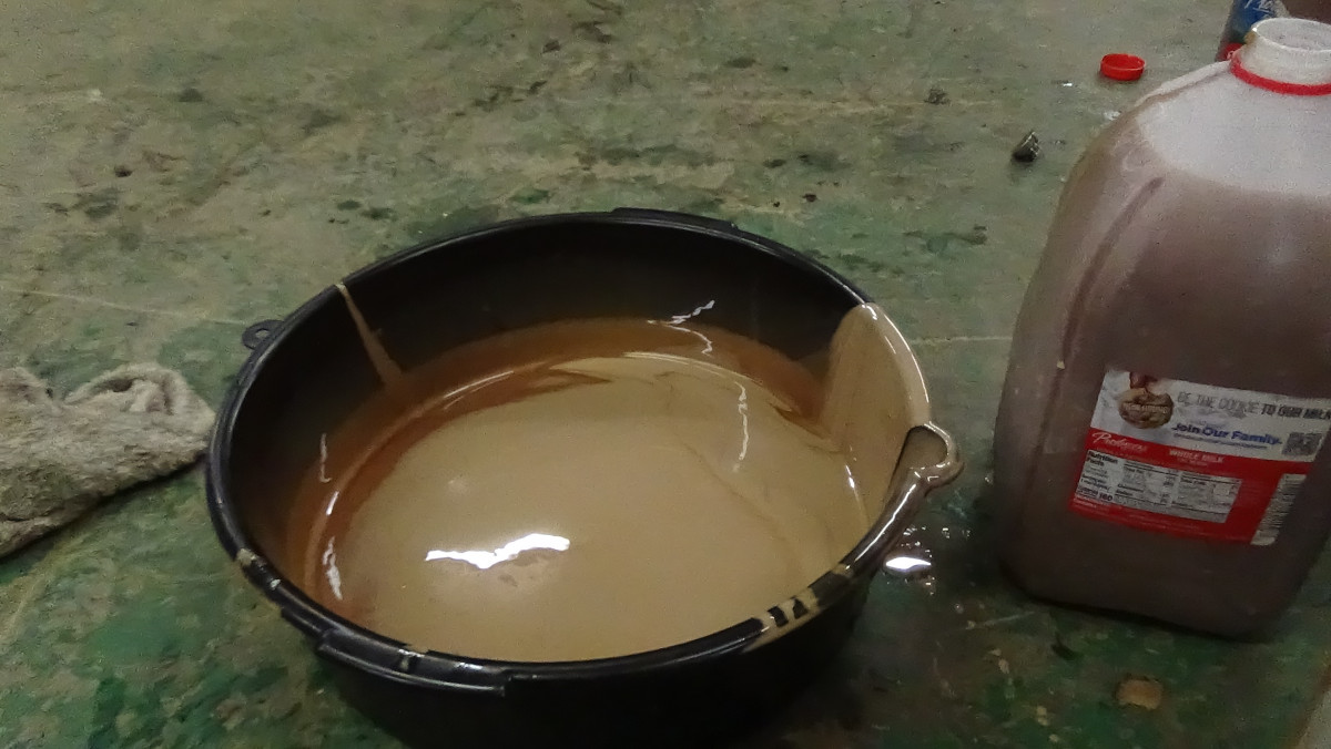

I'm waiting on parts to come so I can put my engine back together as I took the head off to change the gasket. I drained the oil, and it looks like this:
Thoughts? It seems there is coolant getting in the oil, but I'm not sure how. I think replacing the head gasket will fix it. The gasket blew when it overheated, and I can see how coolant gets into the cylinder by the break in the head gasket, but not the oil. How bad does this oil look? In total, about 2 gallons and a little more came out. is this around the oil capacity? I also stuck a magnet in the oil to make sure there were no metal shavings, and it didn't find any. Metal shavings are usually steel/iron right?

You have a liter or two of coolant in 6 liters of oil. The head gasket sill fix that as Long as the head of block is not cracked, a rare occurrence.
Flush the cooling system with lots of water and look got traces of oil. A couple of oil changes will take care of the engine side

Drop the pan, clean it out, attach back w/o sealant, flush the engine with any cheapest oil of good enough viscosity (Amazon 5w30), drop the pan, clean it out, install, now properly. Use new oil filter with each oil change through the process. Use new sump o-rings. Replace oil cooler just in case (needs two o-rings), Behr is OE and affordable.
It is a perfect time to replace the rod bearings, if you want to go that deep.

Might also be a good idea to check both fluids after running for a bit, and potentially do another swap after putting some miles on following the flushes.
If you check them and both are indistinguishable from normal, then you can probably skip the early fluid changes. The check is the important part, and you can verify then that your gasket job is solid as well.
