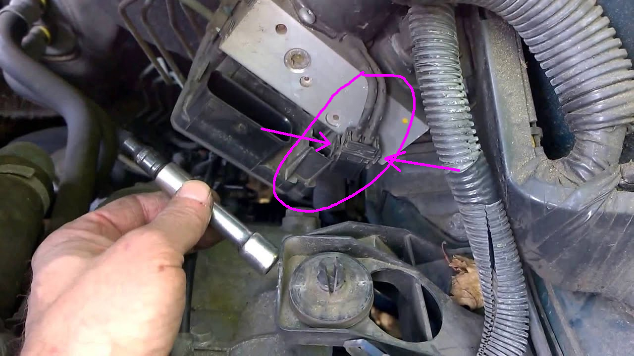

You can disable ABS while maintaining your speedometer and odometer. Disconnect the black two-wire power connector on the ABS module. It's next to (and a little hidden by) the large data cable on the ABS module. Squeeze the clips on either end to release. The data cable is kind of in the way but you can squeeze in there if you're careful. The attached picture (not my own) shows the power cable.
If you choose to remove the data cable, know that the cover is connected to a pair of rails which diagonally release the connector from the harness. Open the cover carefully and firmly, gently pulling the cable away from the module at the same time. Simply yanking up on the cover can easily break those rails off. It's fine if that happens because you can manually slide them, but you have to move each one a tiny bit, switching back and forth. When they're connected to the cover, that moves both at once. And when reinstalling the data cable, gently press it onto the connector while lowering the cover, assisting those rails in doing their job of pushing the cable in to place.

Thanks for having the same problem first:). That save me a lot of time. I am going to disconnect that ABS motor and drive it like that until spring thaw. Excellent directions!
