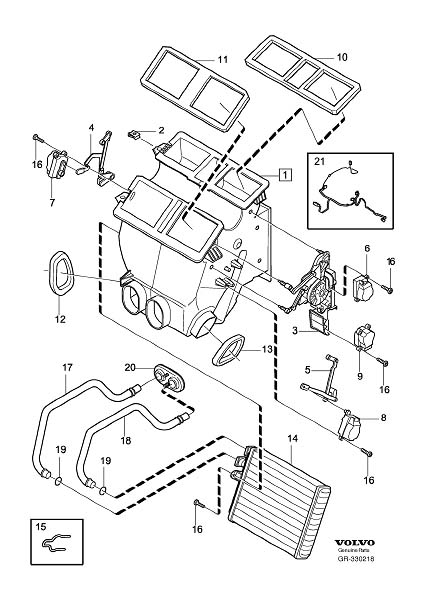

Are these of any help?
#s 7, 8, and 9 show as "motors."
Found parts diagrams here....
https://www.volvopartswebstore.com/show ... evel=28254
