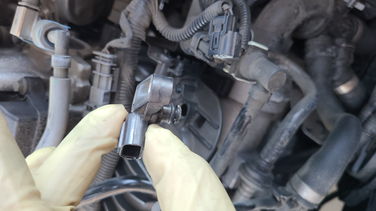

Been a while but I wanted to give an update now that this issue has been resolved. Thanks to @regent for help with the diagram. I was able to locate the MAP sensor and attempted to clean it but I was not able to clear the CEL. I ended up purchasing a new
MAP sensor from FCP Euro and swapped them out fairly quickly. After doing so, CEL is gone! I've added some pictures for anyone else who may need assistance.
