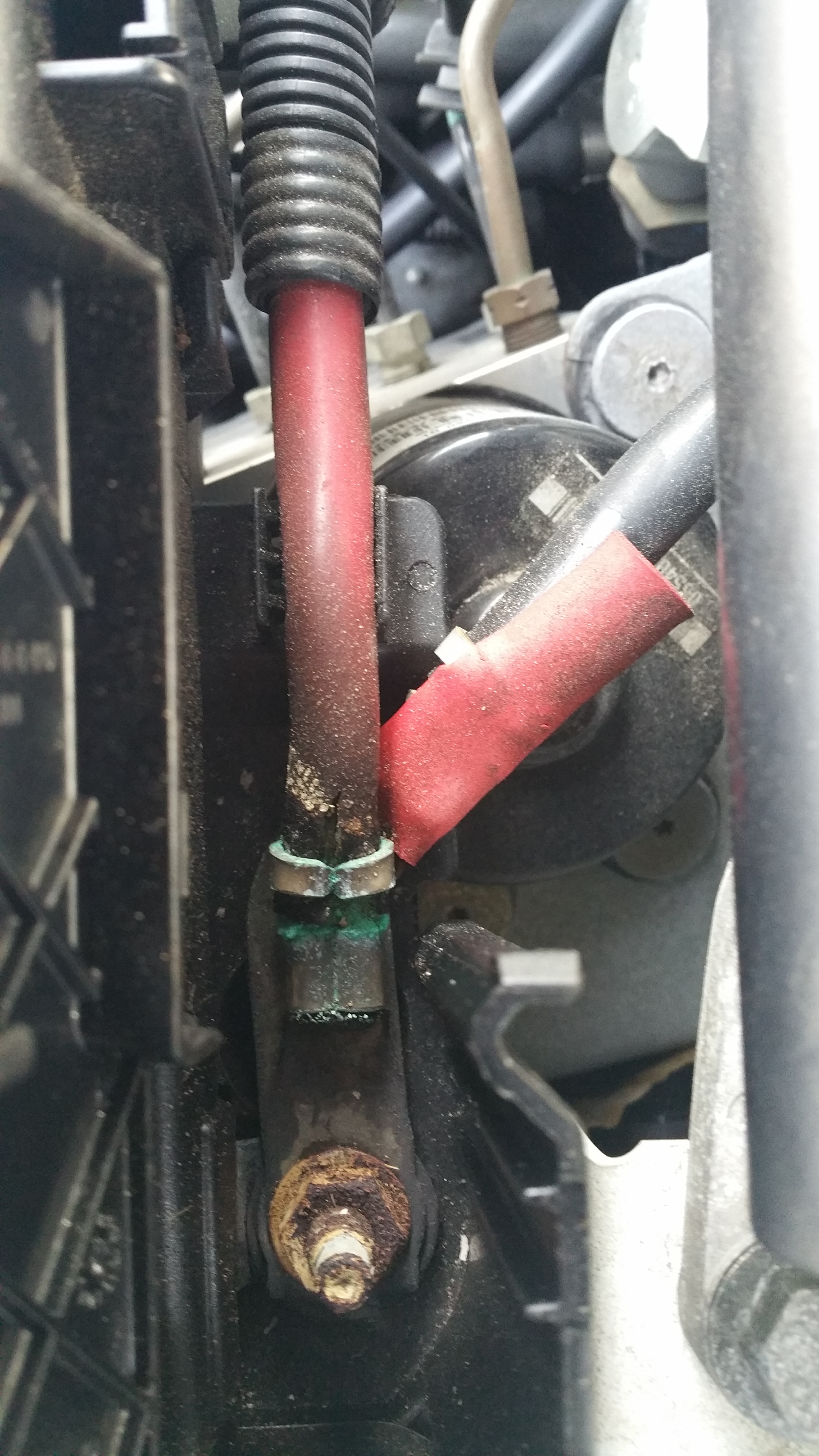

Do you have keys attached to the Volvo key? If original owner had a pile of keys and dangling things hanging from the key in the ignition. The swinging of weight like a pendulum wears out the ignition switch that causes intermittent running issues as the keys swing say from repetitive brake than accelerate traffic. Try using only the key by itself. Also you are due for vacuum line replacement to the turbos though that tripped the cel on mine so preventive maintenance on these lines is advisable. Also fuse panel fails causing erratic electrical issues so check it too. It's the underside electrical board corrode and is not a expensive fix. I attached photos of the fuse panel issue which is a known problem with the 2004 model year. Hope this helps, June
