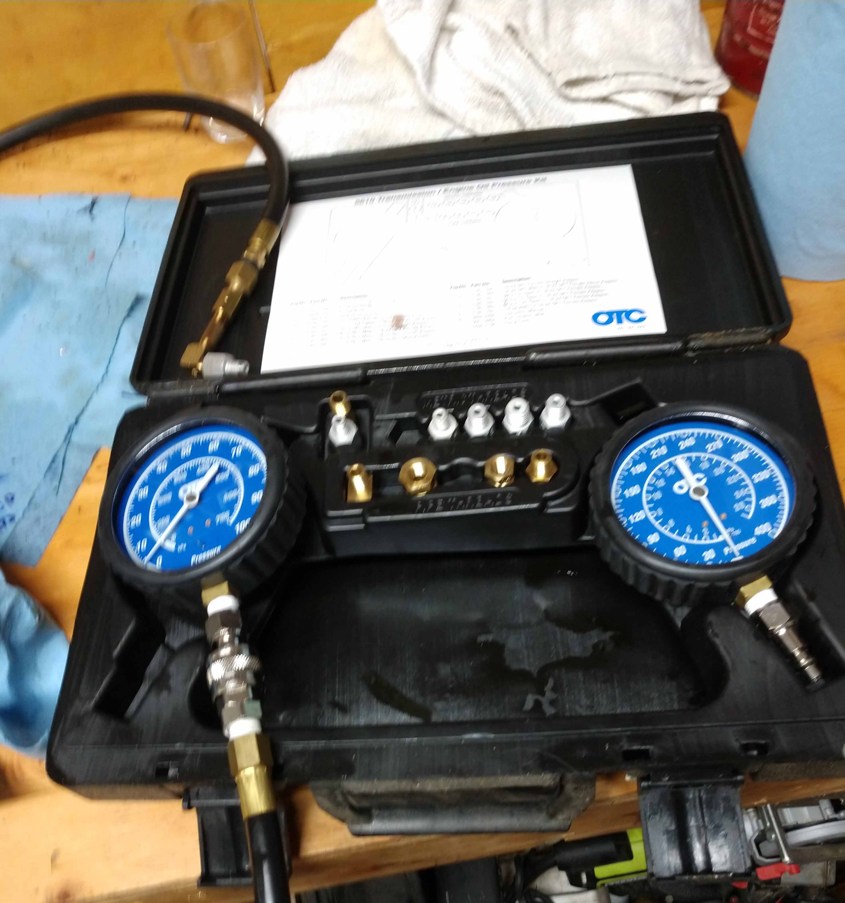

You said the car goes into limp mode right after starting it, does this happen even before you engaged R or D? Do you feel slippage or RPM flares when driving?
If you use the Captiva valve body you'll need to do the S2 solenoid swap and check for the B5 control spring as I described in my notes.
If you use parts from the Captiva transmission you have to be careful of some differences between the transmission. I think the Captive may be a 51SN transmission and yours is 50SN. If you're going to take the transmission apart I would recommend new frictions and seals and if you do swap any of the frictions you'll need to measure thickness as there can be different thickness frictions with the C2 and 4-5 clutch frictions between the transmission types.
Here's the pressure gauge I've used to check for expected pressure at the different tap points.
