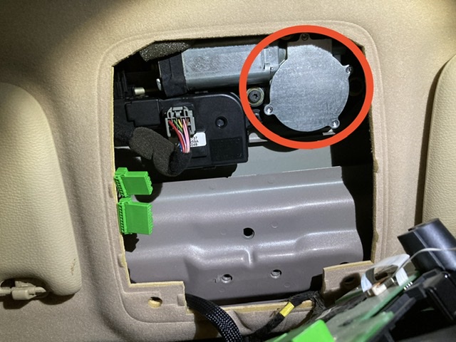

Naturally, this will happen just before forecasted precipitation. If you don’t have time to fix it properly (which most often is to replace/repair the siren/alarm module), or simply don’t care if the sunroof is operational & just need it closed, here is how to do it manually.
Remove plastic beauty cover from map lights. Start at the rearmost corners, it pops off pretty easily.
Remove the 2x 10mm screws here.
Disconnect negative terminal from battery. Wiggle the black plastic away from the ceiling. There are 4 retainers near the corners & 2 green electrical connectors on the left side. Let it dangle.
Next you’ll see the cover for the gear case. It is riveted on. Fear not! Drill rivets just enough to allow the cover to be removed. Take a sip of coffee and realize you should have draped an old sheet or tarp over the whole front seat area.

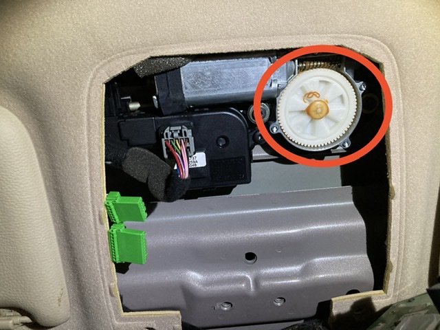

Remove cover to reveal worm & spur gears.
If sunroof is stuck open in vented position, spin spur gear counterclockwise. If sunroof is stuck fully or partially open, spin spur gear clockwise.
Snap the cover back on & reward yourself with a fresh cup of coffee that doesn’t have shavings in it :D

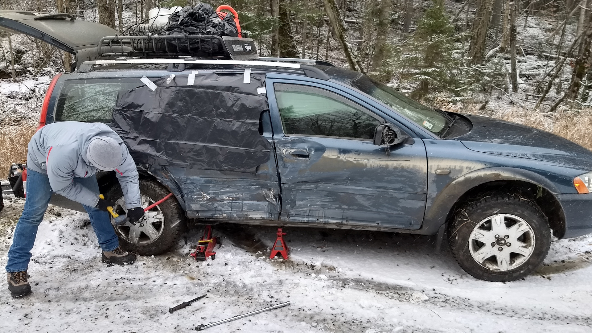

- Pete - wrote: 23 Mar 2022, 19:10 Somebody had some fun, followed by the having of a little less fun. :(
I learned I can transplant a donor body in 3 months, working in second shift, during hobby hours ;)
- Pete - wrote: 23 Mar 2022, 19:10 What’d you come up against VTL?
A boulder.

Ahh, the fancy “Thor’s Hammer” windows. That’s good to know they fit, my V70R has the “Thor’s Hammer” glass option. Even “auto-up” works without sensing “a pinch”?
Sorry to hear about the (assumed) total loss. Did the side curtain airbags deploy? I’m sure the damage is much more evident in person; the doors, mirror & front fender wouldn’t prevent me from buying it back from insurance. But that wrinkled up portion just in front of the rear wheel is worrisome.
Edit: your insurance agent must love you :D
2001 V70XC 200k
2004 V70 AWD 174k
2004 V70R M66 147k
2004 XC70 361k
1995 F250 7.3PSD 262k
2014 Ram 3500 DRW 116k
vtl
Posts: 4723
Joined: 16 August 2012
Year and Model: 2005 XC70
Location: Boston
Has thanked: 114 times
Been thanked: 603 times
Post by vtl »
It wasn't a total loss. I got a similar car with the chassis serial number +157 to mine and had everything transplanted from crashed car into a "new" one. Well, actually picking the best undamaged parts from both cars. Still have those extra bonnet, front wings, front seat, driveshaft, engine, transmission, CEM, BCM, ECM, TCM, DEM, UEM, etc, etc laying in garage and in basement.
All passenger side airbags deployed.
The insurance company wasn't aware of situation. We were able to hammer out the jammed wheel and make it back from northern Maine to Boston. Overall, it cost me $2200 for the donor and $300ish for a new Volvo radiator (my was bent, with broken plastic, and the donor came with the Nissens) and misc parts.

How? What do you use to turn the spur gear?
Posts: 35267
Has thanked: 1497 times
Been thanked: 3809 times
I’ll go with needle nose pliers by Channelock
- Pete -
Posts: 960
Joined: 6 December 2013
Year and Model: 01, 04, 04, 04 V70's
Location: Minnesota/Wisconsin
Has thanked: 80 times
Been thanked: 175 times
Post by - Pete - »
I’m pretty sure it is as Abscate says it is, if memory serves me right. Although I don’t recall my needle nose pliers having blue plasti-dipped handles. :D
