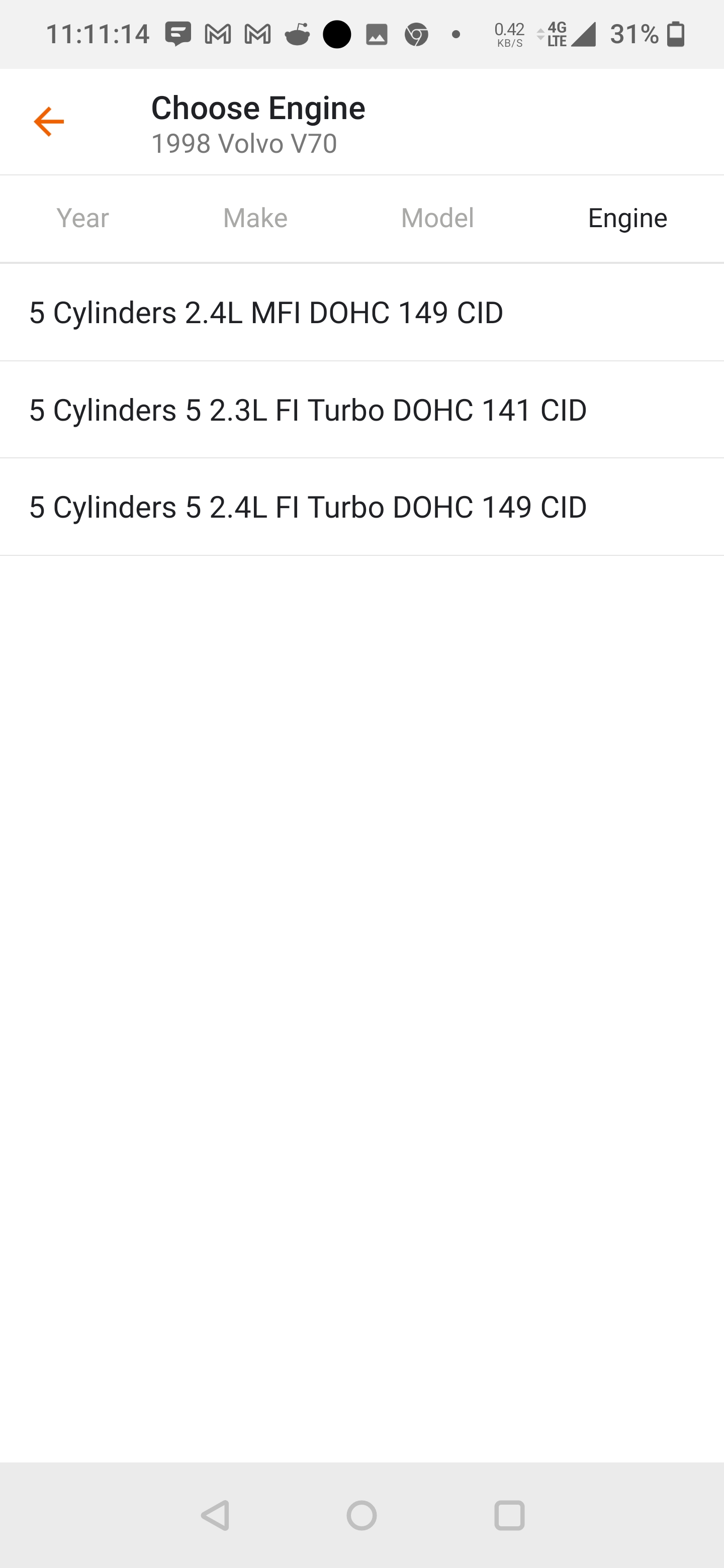

Ok, I have the LPT engine in my 1998 fwd glt
B5245T
Vin code 56
Now, when I search parts at auto stores , it says...
2.3 litre 141 cid
Or
2.4 litre 149 cid
Which one do I have ?
Kinda wanna figure this out once and for all!

The last one. First one is the non-turbo, 2nd one is the high compression T-5 turbo and 'R' motor and the last is the LPT GLT motor.
